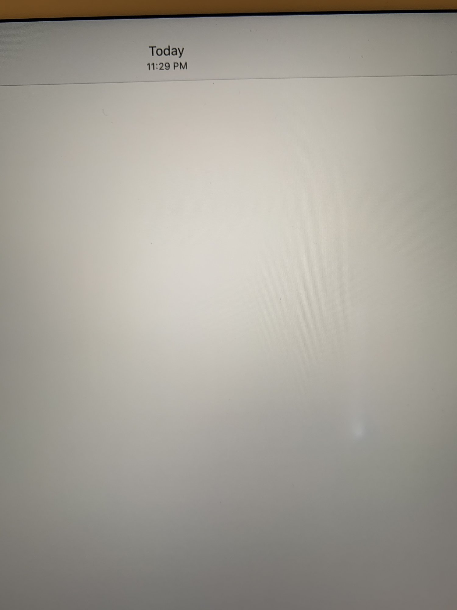

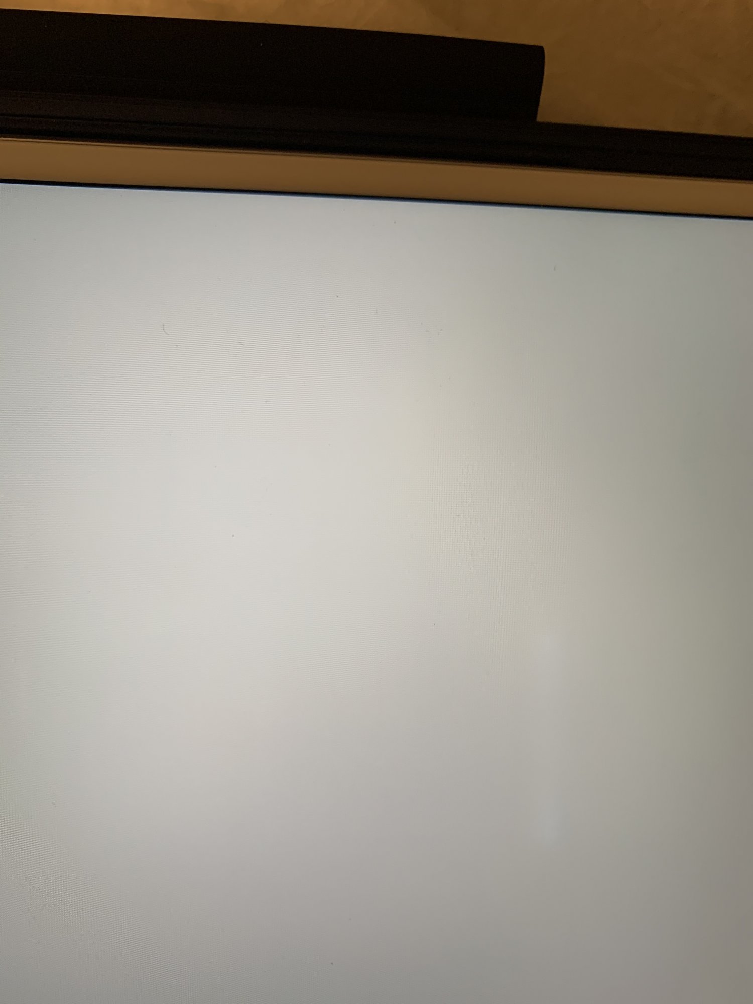

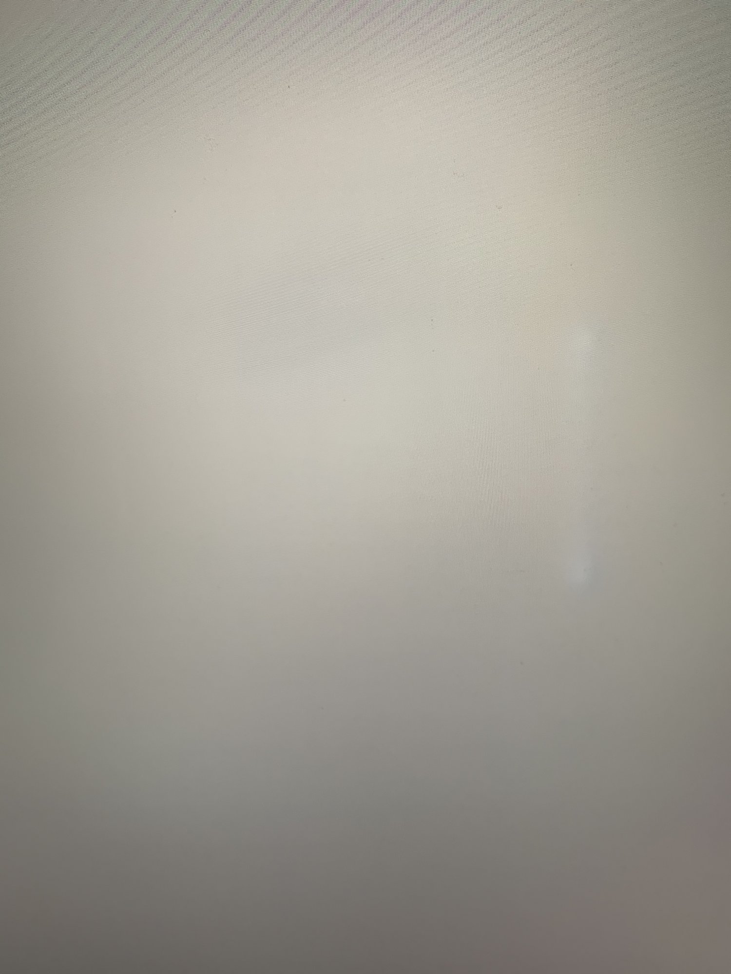

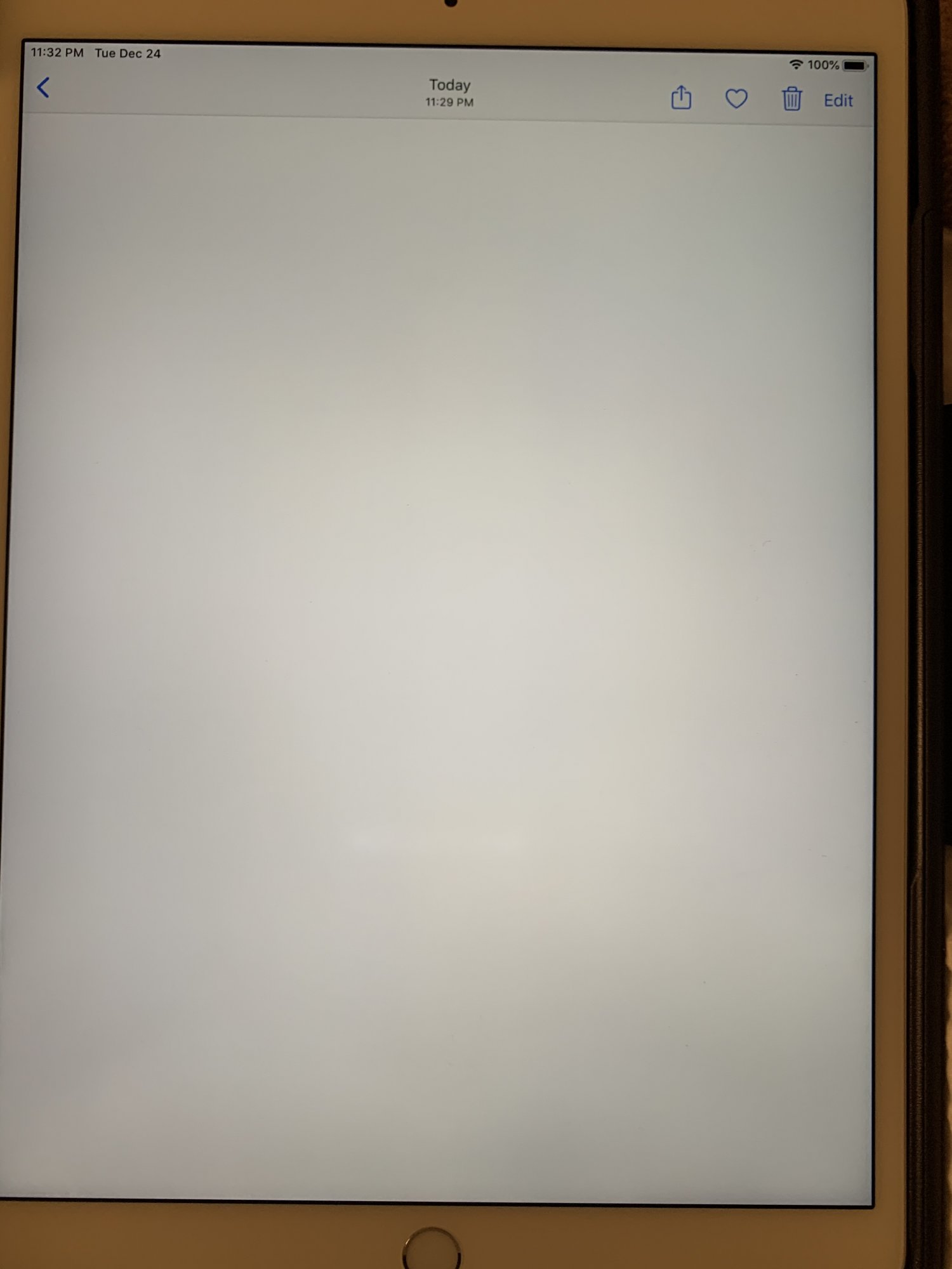

I just got an iPad Air 3 from Best Buy and see two bright white spots on the screen. I noticed when pressing another area of the screen they light up more. I can trigger the spots to get brighter basically by pressing elsewhere on the screen. I have read about problems with the pro, but not so much on the Air 3. How prevalent is this issue? Guess I'll exchange, but don't really want to get on the exchange merry go round if this is a very common issue. Might just return for a refund if that's the case. How many others with the Air 3 have this issue?

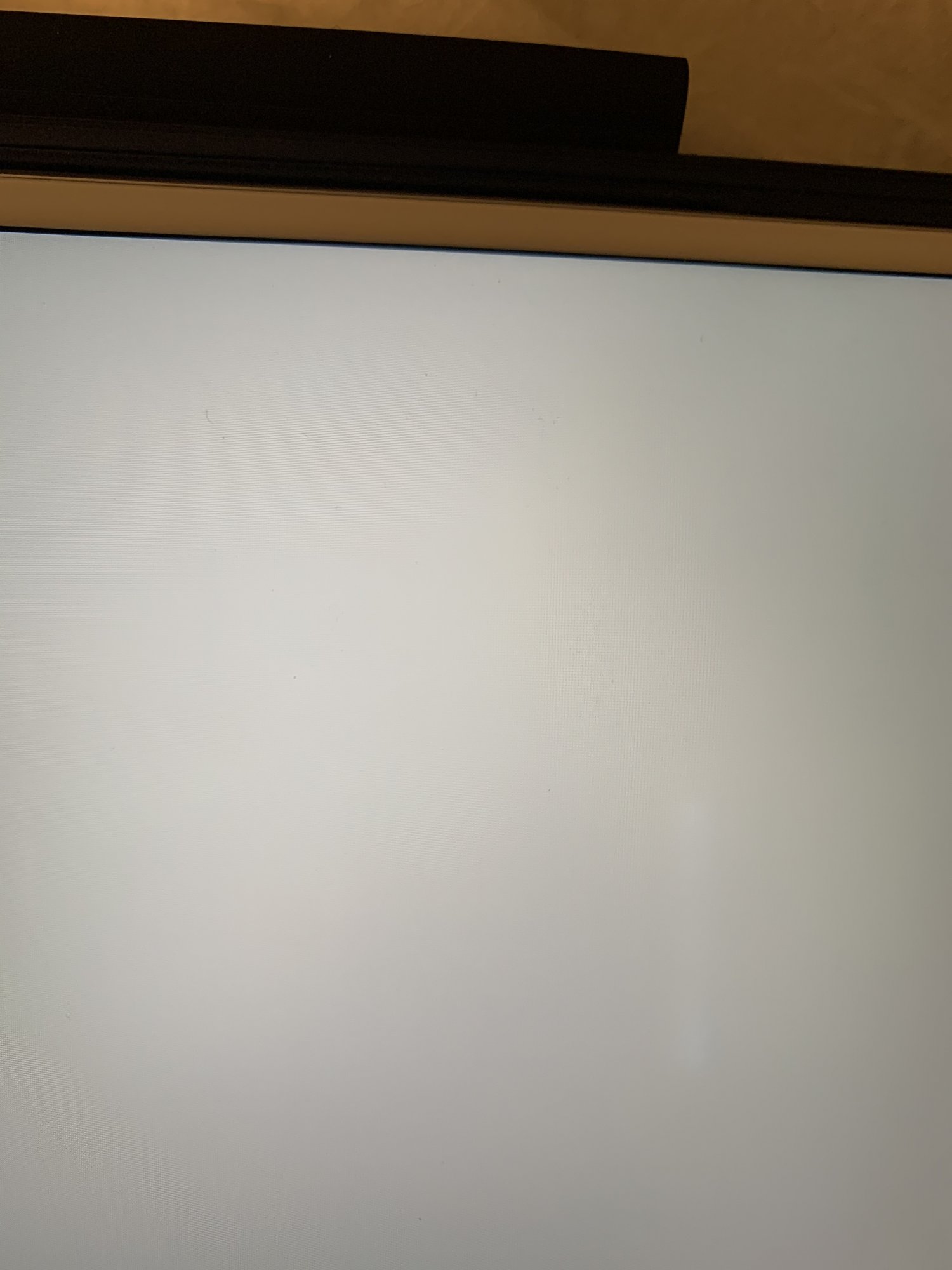

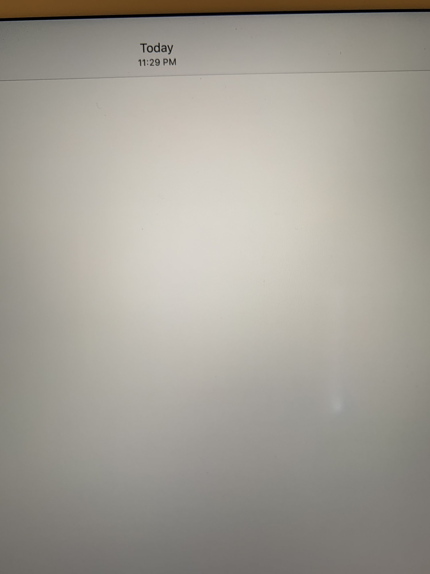

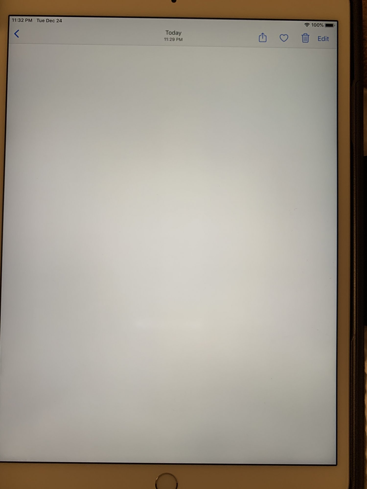

It’s more like a white line. I took a pic and will attach here. Looking closely though it appears to be two white dots with a line connecting between them. If I press on the screen the white dots glow more. Anyone ever seen anything like this? Pretty disappointing. Its great otherwise, but obviously I won’t be keeping it.

A couple more pics. If I press on the one side of the screen you can see the one dot gets brighter. If I use two fingers and press on opposite ends of the screen the two dots glow and there’s the faint bright line connecting them. If the screen isn’t pressed on it looks more like one single white line.

That white line is not too far away from the white spot location of the iPad Pro. It seems like it may be a similar process.
This is at least the second report here of an iPad Air 3 white spot, BTW.
Well, I took it in to Apple and they said it's a swollen battery. Defective and rare they claimed. Not a good thing and they said they didn't think it would happen, and didn't want to worry me, but it could burst. So basically that white line when pressing on the screen was the outline of the battery.
