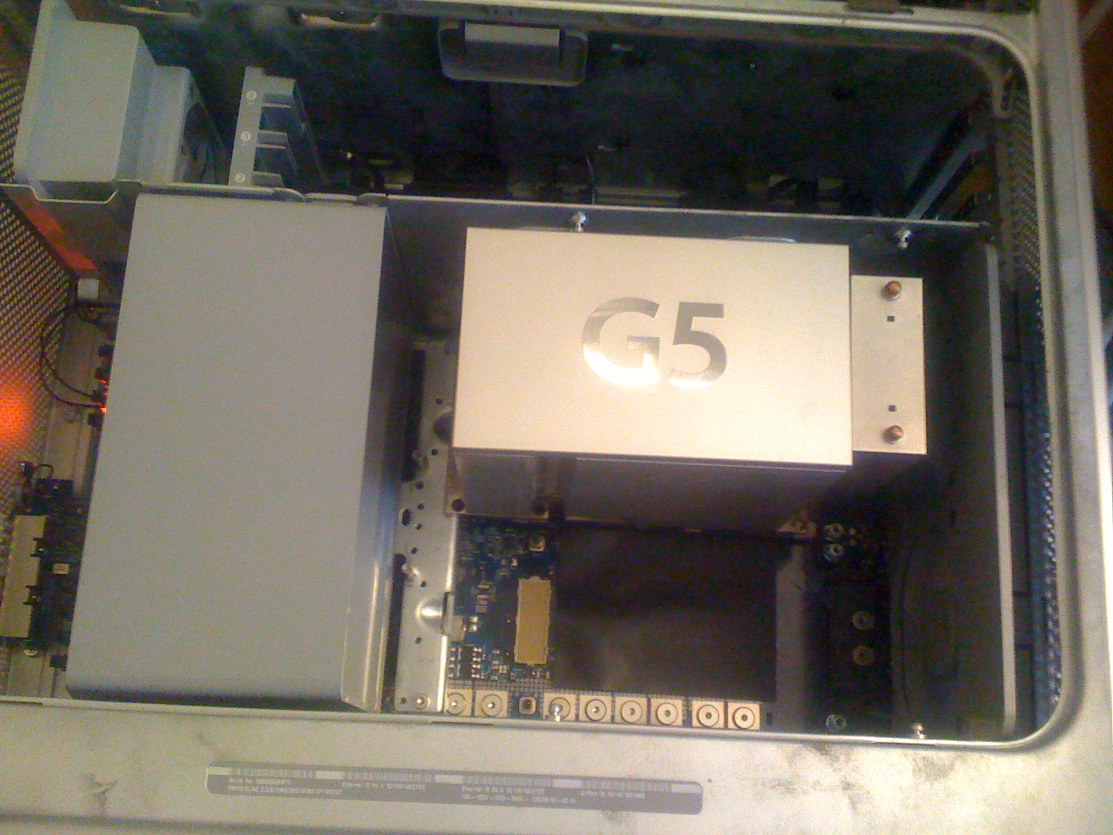

Well I'm kinda basically overhauling my G5 LCS so I figured, why not lets try and put a heatsink from my 1.8ghz G5 onto the quad G5 CPU since I have it out. I only have one CPU in it right now and it's actually doing pretty damn good. I set the Energy prefs to Reduced as a precaution.
If I ditch the LCS and make this a permanent setup, I will have to machine some custom brackets to hold the heatsinks to the logicboard/case. I have the G5 laid on it's side at the moment since there is no way to fasten the 1.8ghz heatsink down.

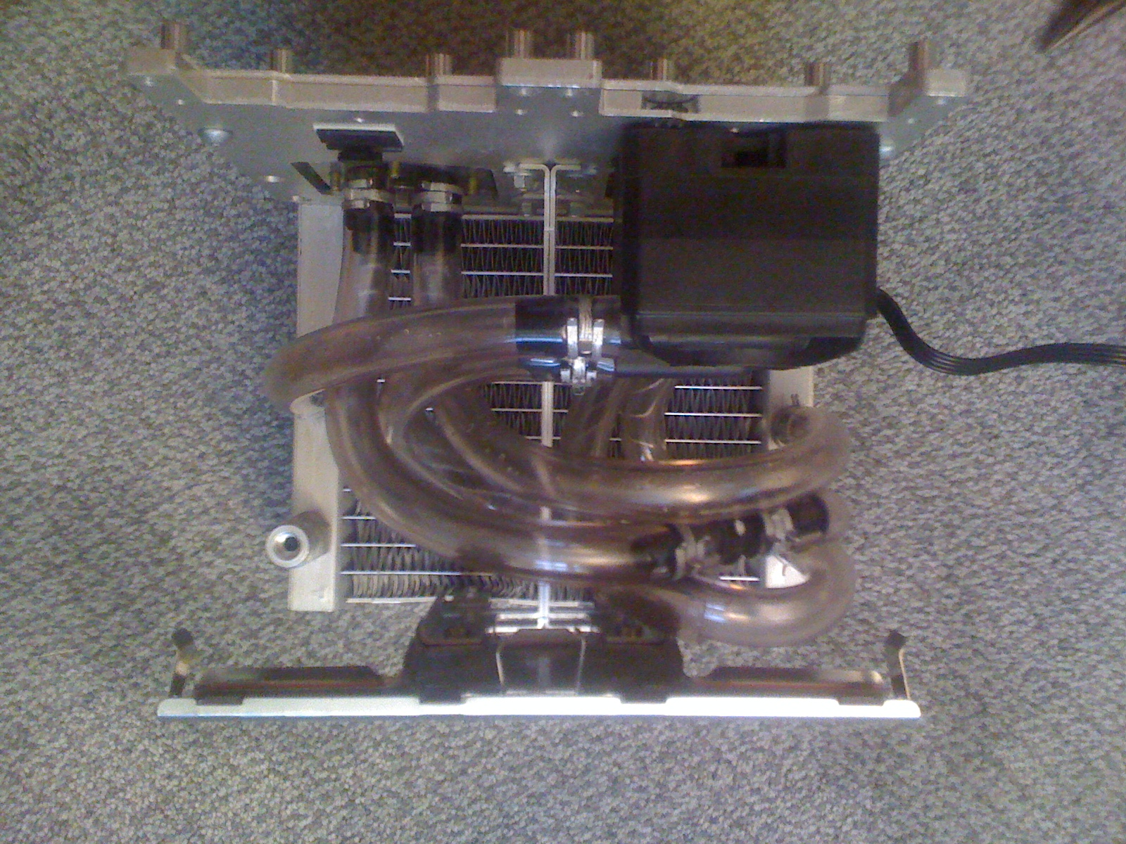

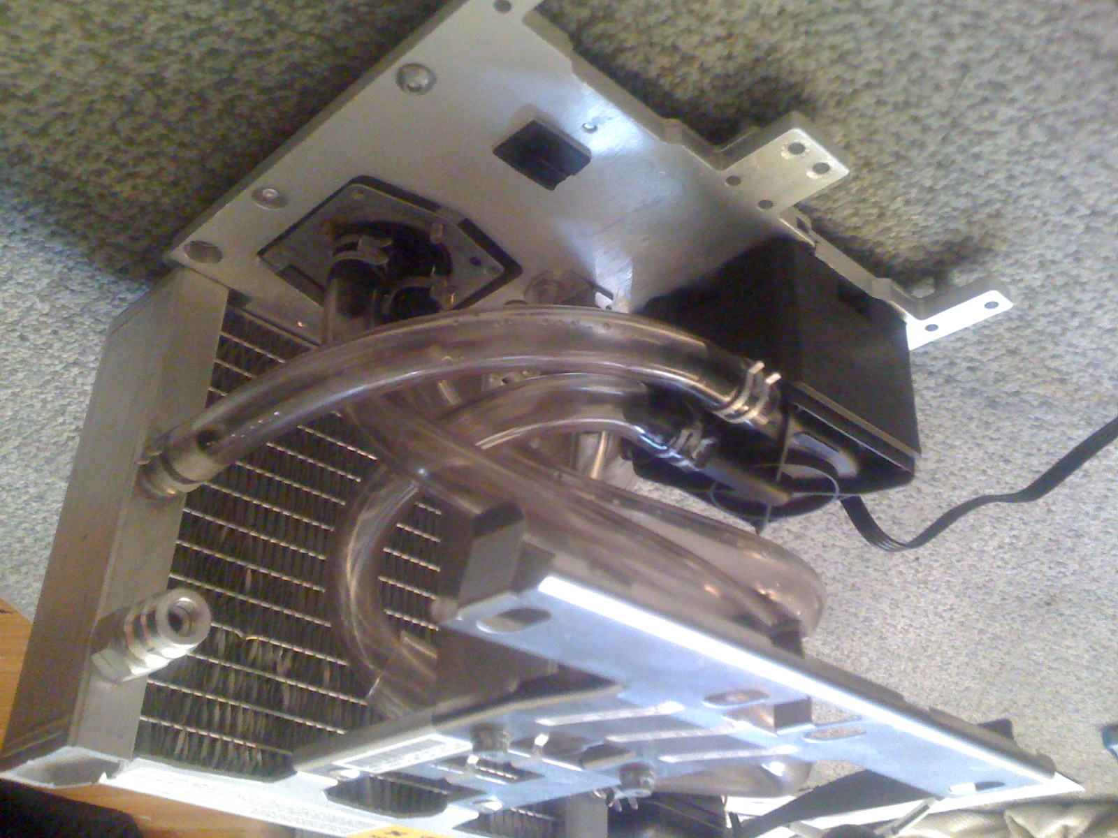

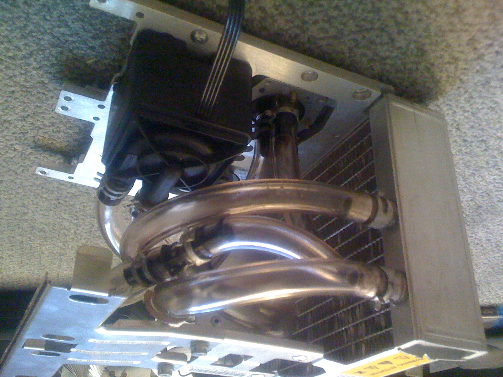

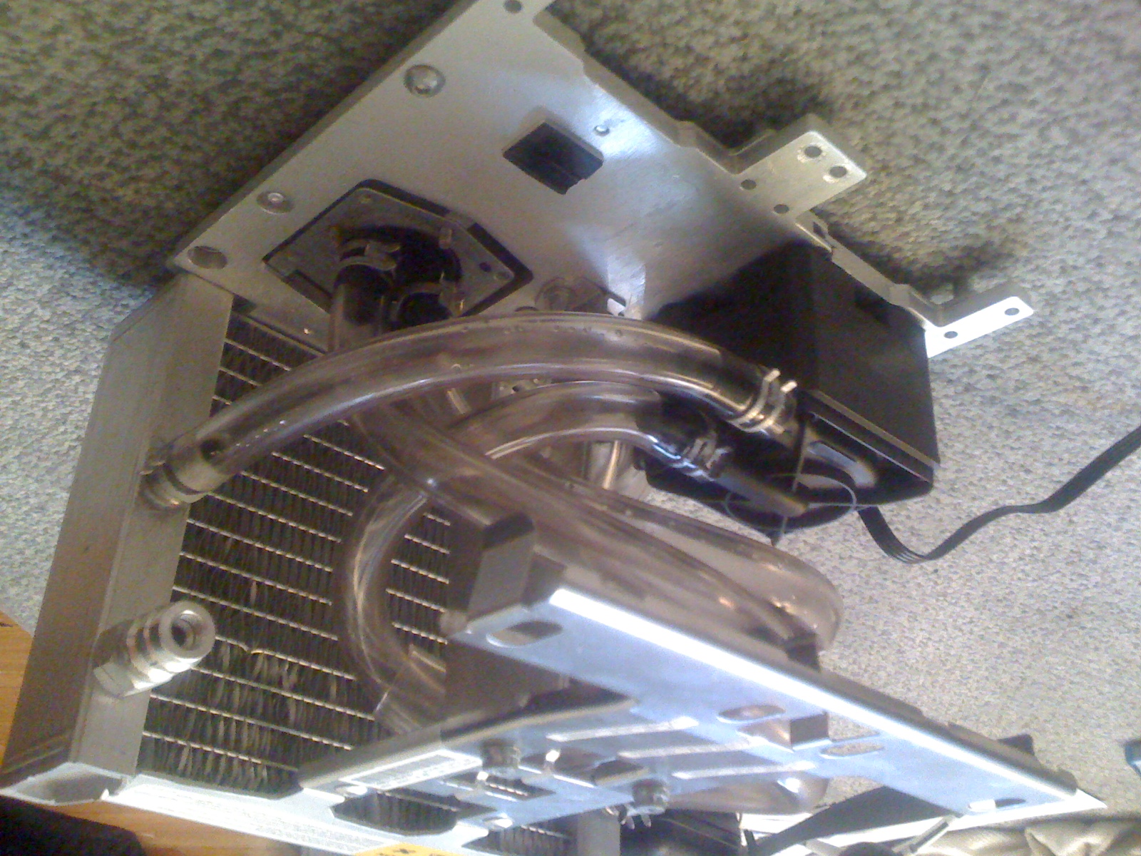

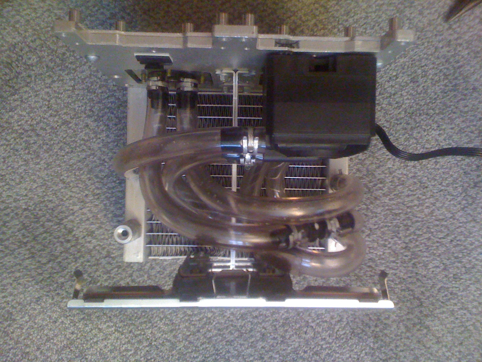

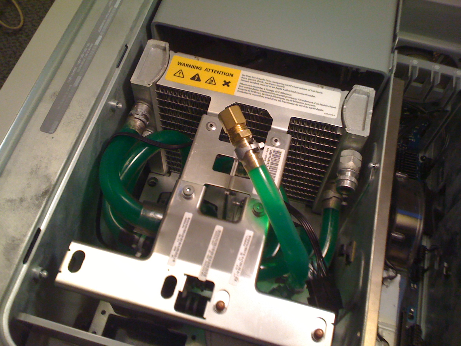

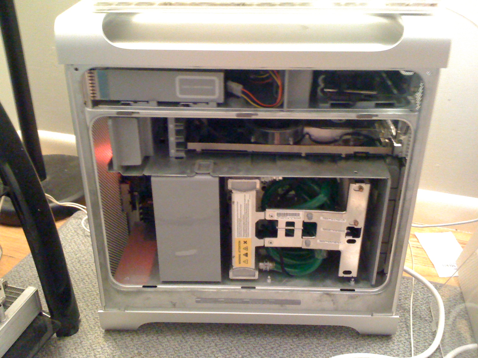

I got the Tygon tube today and redid the LCS setup. I got a 1L bottle of Feser One cooling liquid coming in the mail so I hope that's going to be enough. I used about 5 feet of the Tygon tubing(came with 6') and I just reused the old clamps. Tested it with about 100psi and no leaks 😀.
Pictures below of the LCS with no liquid. I will be putting it on a vacuum to remove any moisture and will be easier to fill too and I will try to keep it 100% bubble/air-free.

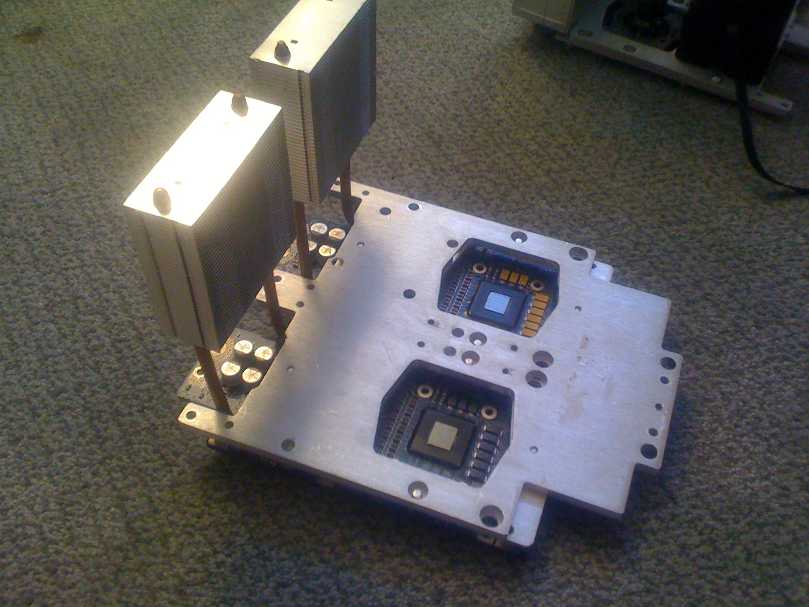

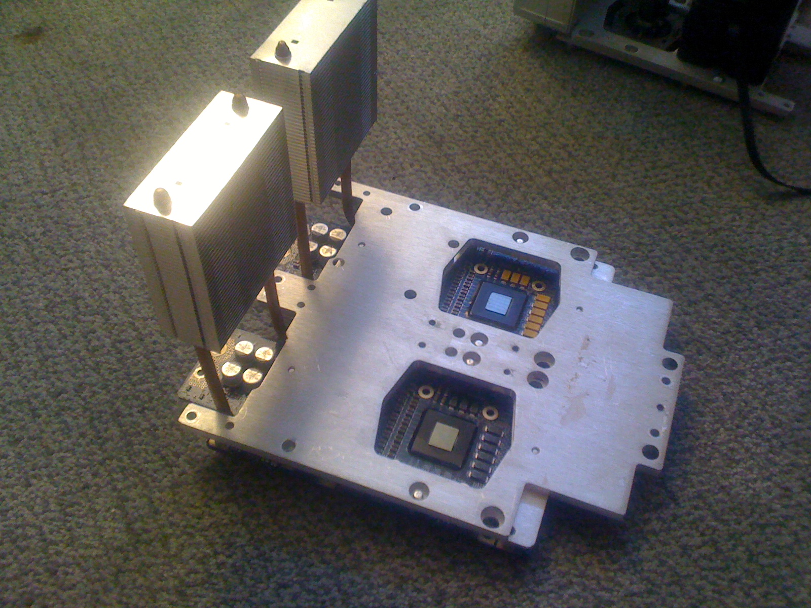

Here's a picture of the 1.8ghz heatsink on one of the CPUs. There's also a picture of the support bracket for the LCS which was all removed.
I'm thinking of fabricating a full custom copper heatsink with heat pipes. I'll be making this myself or maybe buying 2 thermalright heatsinks or similar and mounting them to the plate so everything will be fit snug and tight. We shall see what would make a better setup. 🙂

I actually didn't have any problems with the LCS. I just wanted to do something in the case that something did happen. At least I know if it leaks, the liquid won't corrode or short out my logicboard and/or CPUs.
I'm just testing for a full air-cooled only method but the current heatsink is no way good enough to disperse enough heat that the Quad gives off if I want to run the G5 the way it should. Setting the processor to "Highest" will result the fans running at about 2500-2600 RPMs and that is just with one CPU in there. I've been looking all over the net for a good heatsink with lots of heatpipes that could I could modify to fit somehow or just create my own altogether. I ran the thermal calibration with the heatsink and didn't have any problems. You have to use ASD 2.6.3.

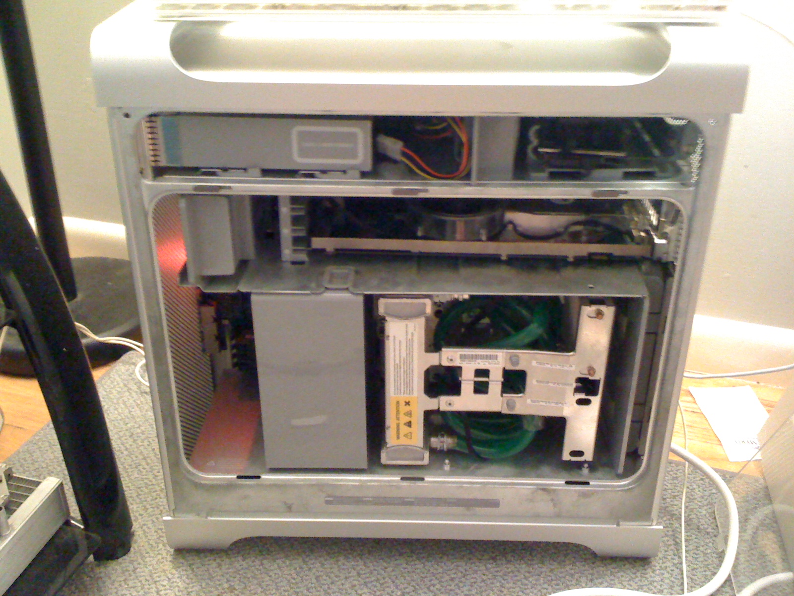

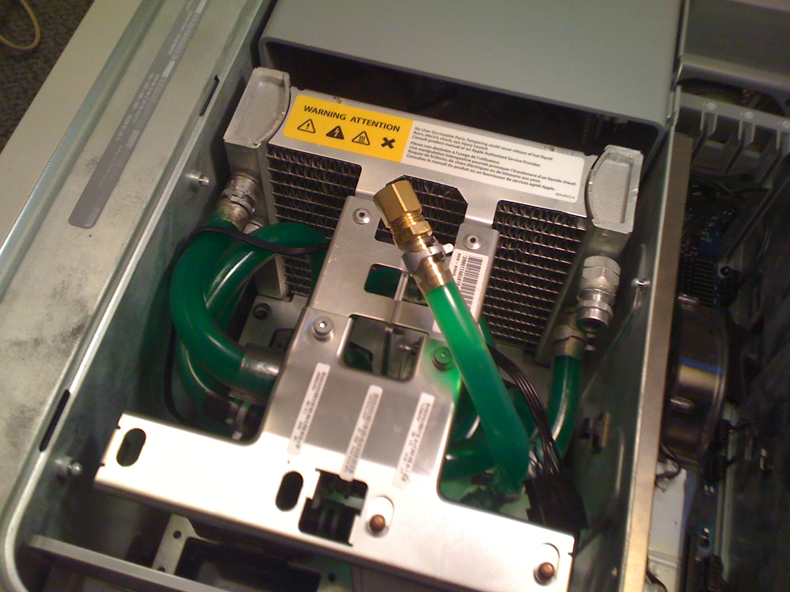

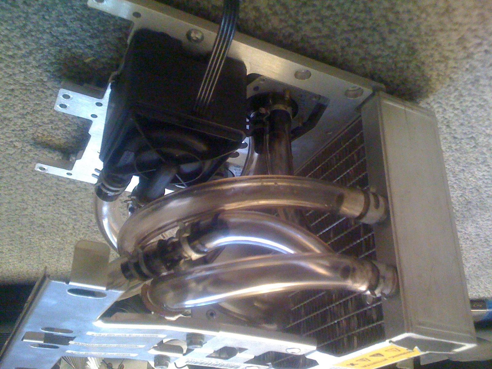

I managed to fill it last night since I had some free time. Let it run a few hours to try and get all the air bubbles out. I put a "T" in the line to catch any air and also for an easy spot to pour more liquid in. I noticed the air I got out the quieter it became, obviously lol. I only used about a 1/4-1/3 of the 1L bottle so I have plenty left over. It's been running all night folding and the temps low are steady.
Thinking I have to run a thermal calibration again as the last times I ran it was with the air cooled heatsink. Fans are steady at about 1800RPMs which is audible 🙁. We'll see how it goes in the next few days.
Will upload pics soon.
I will take better pictures as I have to remove it again to install the other processor once I find a compatible one.

That looks awesome! Sort of looks like the flux capacitor from Back to the Future.
