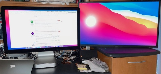

Replaced my awful, hot to the touch, crappy battery 16" MBP with an M1 Mini and I run 2 displays: 27" Apple Thunderbolt (w/ TB3-2 adapter) and HDMI native direct 32" 4K.
Now the Mini runs ice cold and the 8GB Unified Memory runs circles around the 16GB Intel DDR....
