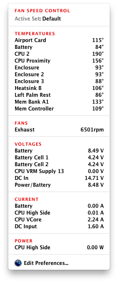

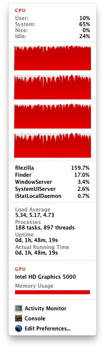

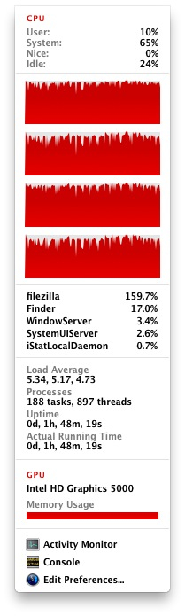

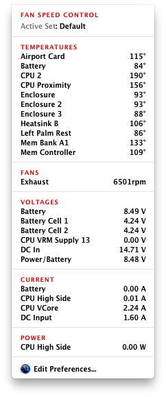

Hello,
Does the Macbook Air run warm when running an FTP program, like FileZilla?
I have been transferring a bulk of files from my NAS TS-869 Pro, to my Drobo 5D and notice that the Air warms up nicely when doing do.
This is through the thunderbolt adapter to ethernet.
Just checking to see if others are seeing similar behavior as I.
It never becomes too warm, although it has reached about 203 degrees F once but once the fans kick in on high, it comes down to about 170-180 until the transfer is completed.

All Mac models run warmer when running system intensive apps or processes. It's normal. If you're not already doing so, use iStat Pro (free) or iStat Menus ($16) to get accurate readings of your temps, fan speeds, etc., rather than relying on your sense of touch or sound. A forum member has posted a copy of iStat Pro that has been "tweaked" to enhance compatibility with Mountain Lion. You can download it here.
The Intel processors used in Macs are designed to automatically shut down to prevent damage if they truly overheat. CPU Tjmax = 105C (221F), GPU Tjmax = 100C (212F) on i3, i5, i7 processors. (Source: Intel)
Unless there is a rare defect in a Mac, most temps are well within the normal operating range, considering the workload being put on it. Websites with Flash content, games and other multimedia apps will put higher demand on the CPU/GPU, generating more heat. This is normal. If you're constantly putting high demands on your system, such as gaming or other multimedia tasks, expect temps to rise and fans to spin up accordingly. It's just your Mac doing its job to maintain temps within the normal range.
It is also quite normal for your Mac to become extremely hot to the touch during intensive operations. The aluminum body transfers heat more effectively than other materials used in computer casings, so you will feel the heat more. This doesn't indicate that it's overheating and will not harm the computer to be hot to the touch.
The bottom of your Mac notebook may become very warm during normal use. If your notebook is on your lap and gets uncomfortably warm, move it to a stable work surface that allows for good ventilation.
Your fans are always on when your Mac is on, spinning at a minimum of 2000 rpm (for MBPs) or 1800 rpm (for MBAs, MBs and minis), or 1200 for the newest MBAs. Older iMacs have 3 fans with minimum speeds in the 800-1200 range, while the newest iMacs have a single fan, spinning at a minimum of about 1400 rpm. They will spin faster as needed to keep temps at a safe level. If your fans are spinning up without increased heat, try resetting the SMC. (PRAM/NVRAM has nothing to do with these issues, so resetting it will not help.)
The intake and exhaust vents are in the back of the computer near the hinge on all notebooks in the MacBook line (except the new MBP with retina display, which has intake vents along the sides at the bottom). The iMac vent is a slot on the back near the top of the computer. Make sure the vents remain unblocked to allow your computer to perform at its best. For Flash-related issues:
This is pretty normal for more than just the Air Macs. FTP services are CPU and drive intensive. Normally, when I do a large amount of uploading, I'll manually set my fan on my Mini to higher RPM early on. I use the SmcFanControl app.

A MacBook Air is a hundred times more powerful than that. Try using a Mac-specific ftp program, FileZilla (and it's UI) are cross-platform so it's not optimized for speed. You can clearly see in your screenshots that you're using 157% of the CPU which is crazy for something simple like copying a file over the network.

This. Or, use scp through the command line. One thing I've noticed is a FileZilla tends to be a bit more of a resource hog than it really should be. Using command line tools to do the same thing FileZIlla does really brings down the CPU usage, and I can transfer hundreds of gigabytes without really heating up my macs.
