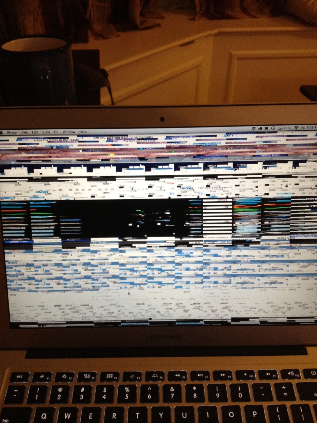

This is a 2011 Macbook 13" base model.
Sometimes, quite frequently, my Air's screen will look like this in the log-in screen after waking it from full sleep. It looks like the image is scrambled. Once I log in, the screen's back to normal. When it happens, it happens across different areas of the screen each time.
Has anyone else experienced this? Is this a sign of a failing screen to come? What is it?
EDIT: I've owned it since August, and honestly have used it infrequently. It has sustained no damages (ie. drops, spills, anything...).

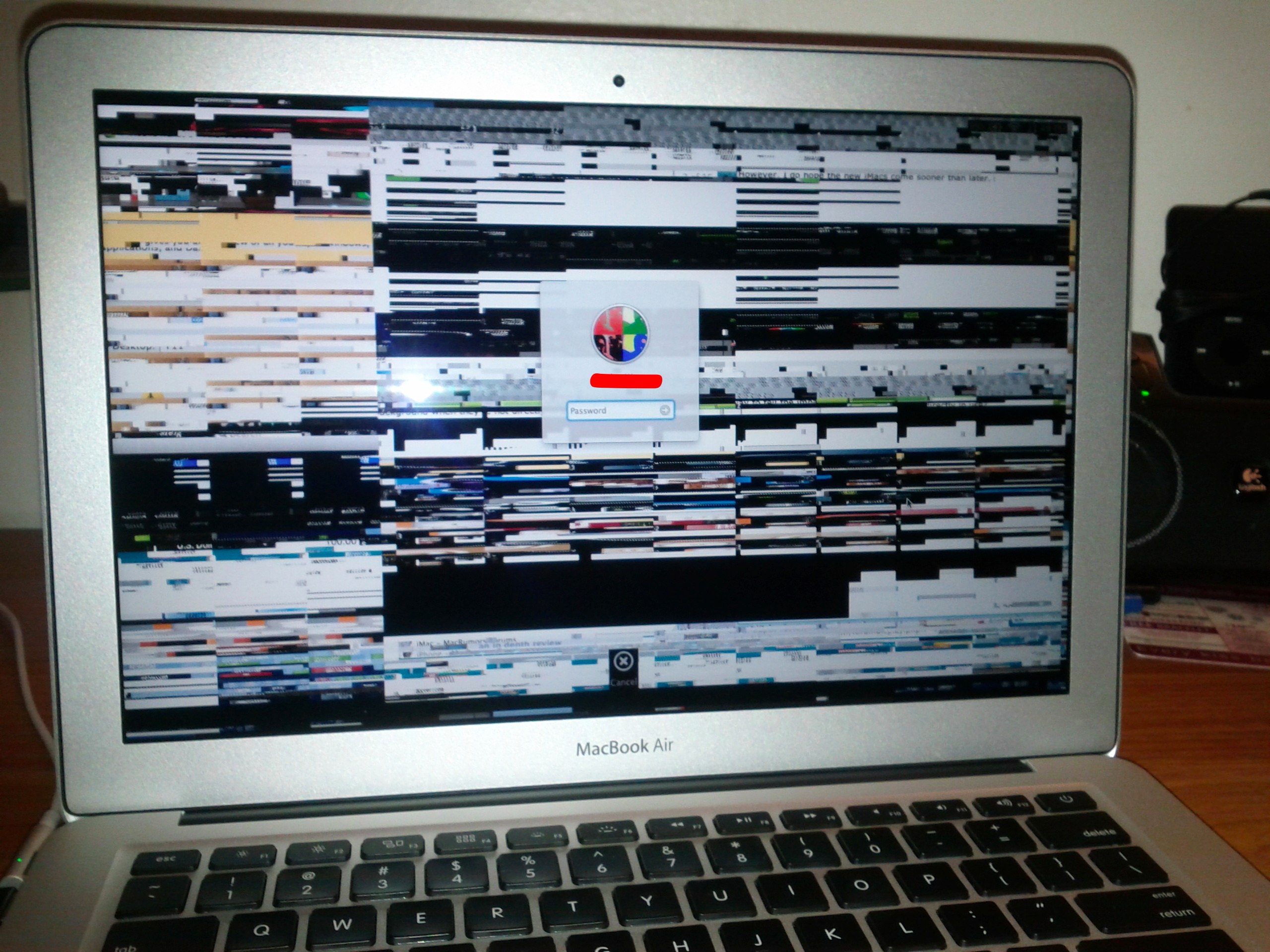

For what it's worth here's another pic of my scrambled screen. It happens almost every single time, and the scrambling is completely random (meaning the scramble doesn't always look the same).
Again, after logging in, the screen behaves and looks normally.

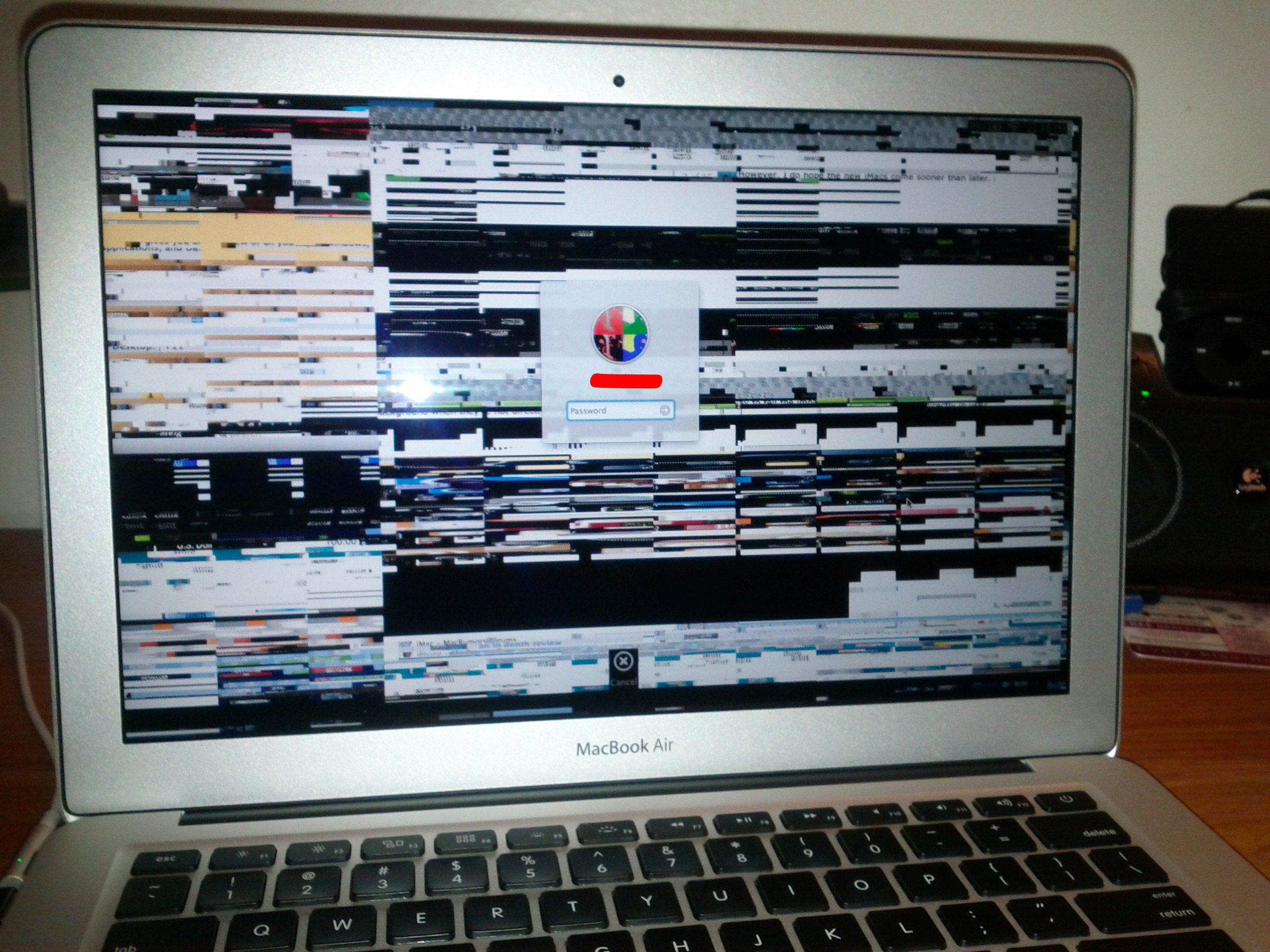

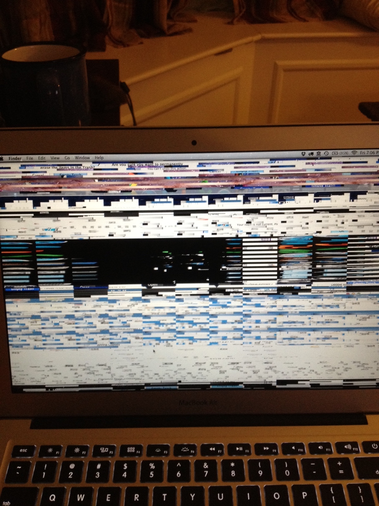

I've usually seen this behavior when a graphics card is overheated. Not from sleep tho, since everything goes cool when it sleeps. Might be a good idea to bring it to an Apple store if you can.
BTW....do you live in a hobbit hole or a castle? Did nobody else notice that doorway behind?

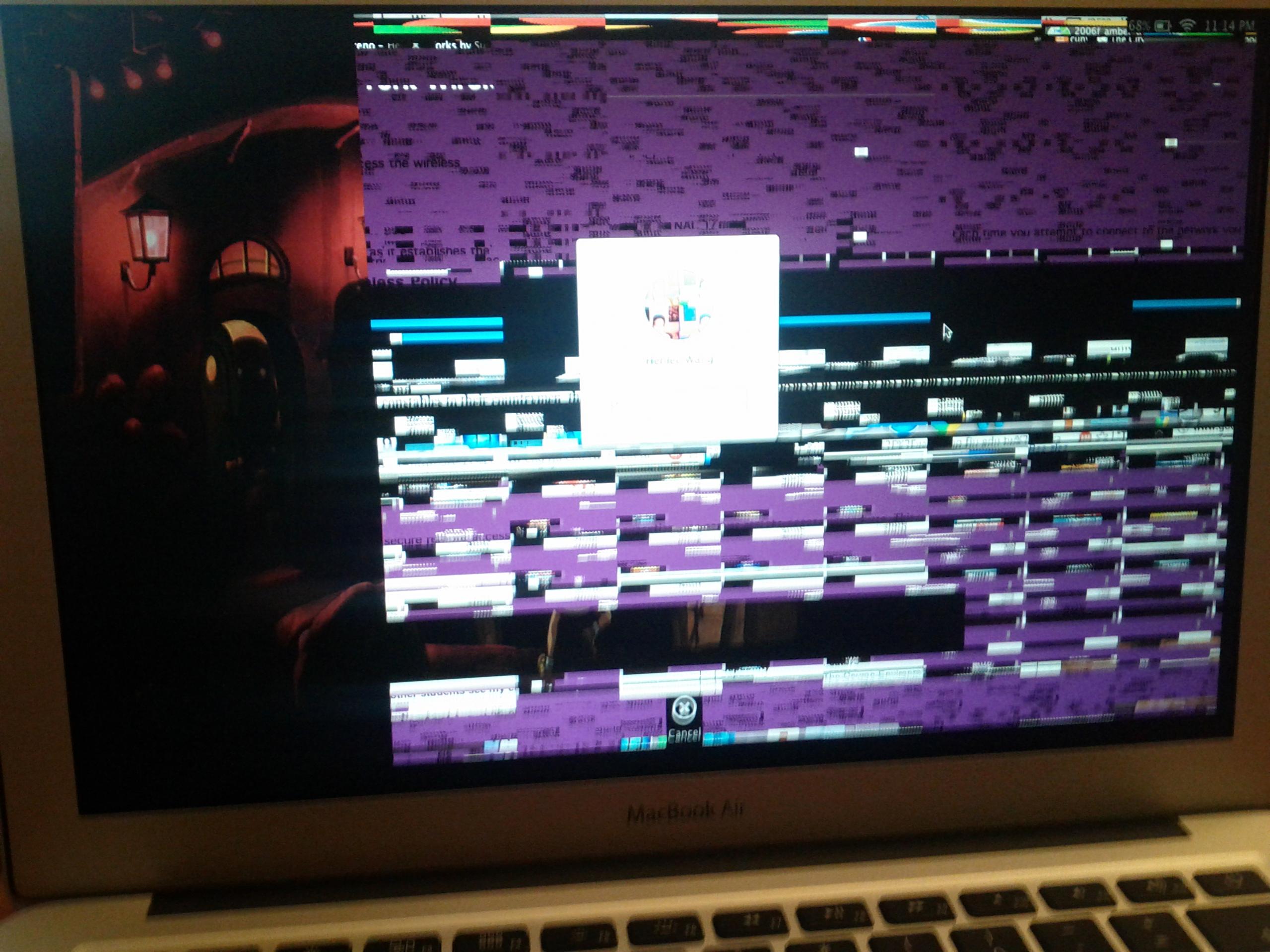

Yeah, I find it hard to believe there are just a few isolated cases of this happening, especially since Apple is selling so many of them. Like the other cases, you just have to "grab" one of the open windows and move it around and it "paints" the screen back to what it's supposed to look like. I have my computer on automatic log-in, so I don't get a lock screen. I am running Lion and my Air usually stays nice and cool. I don't do CPU or GPC intensive tasks on it. I did have to wipe it one and completely reinstall Lion about 3 weeks into owning it and it has had this problem since doing this. As other point out, it doesn't seem to affect performance or anything else, mainly a cosmetic concern.
Here's my screen
