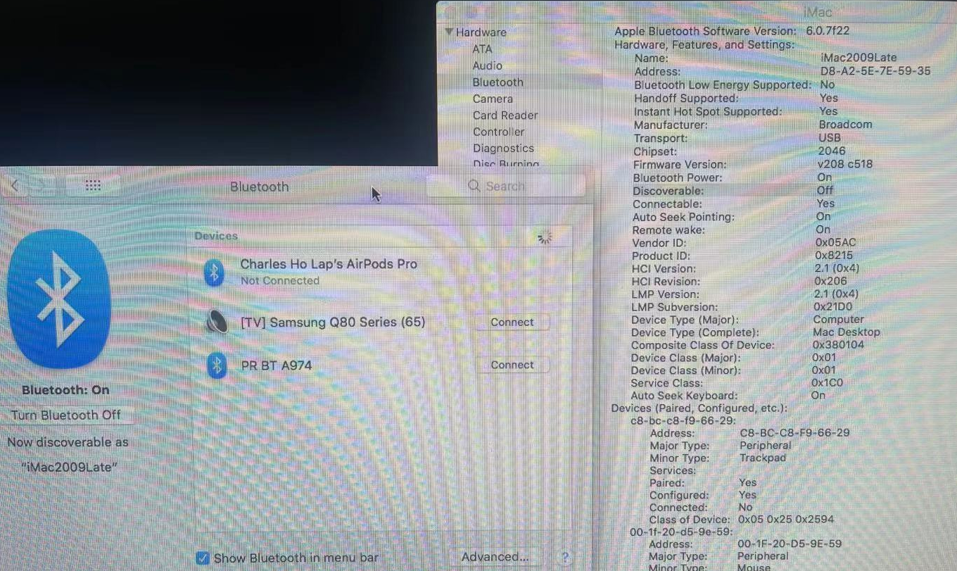

additionally, i found out that my Bluetooth Module showing "not discoverable" under system report, however, it shows discoverable under system preference????????? any ideas?

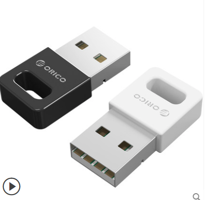

This is the adapter I used:
I have one, too. Model name is BT-403; price about 3~5$, depending on sellers.
Not of much use, though.
Why?
For Windows PC, a BT 5.0 dongle costs 1/3 of this Orico dongle. (bought one be cause of the price, works great on Windows)
For iMac, this BT 4.0 is only useful for Airdrop, I guess. But I rarely use Airdrop on the iMac 2009, while I already upgrade the Wifi + BT combo in iMac 2010.
And it occupies 1 USB external port, but leave the internal USB port unused.
