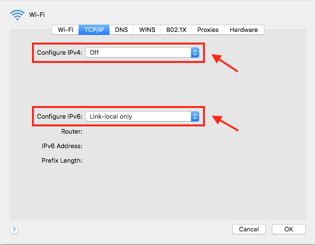

I know this is a bit old tread but I'd like to add some details about Czo comments:
As Czo said, you can just use the Wi-Fi locally only (no internet).
  • In the main page, "Disconnect" from you current network (using "Network Name: dropdown list").
  • Uncheck the "Automatically join this network".
  • Go to "Advanced...", under "TCP/IP" section, do the following:
  • Click "OK" and "Apply".
Your Wi-Fi should now be turned "On" but not connected to internet anymore (a yellow light should show beside Wi-Fi).
And Airdrop should now work as expected.
Hope this helps!
