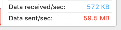

This is my MBP sending my iPhone 11 a large single file (many smaller files have a lot more overhead) with the iPhone sitting on it.
476 Mbps
I wouldn't expect much higher than 20-30 MBps in more realistic use though. Wifi broadcast between two low power device is anemic at best. Inches make a difference in transfer rate and that makes the transmission more susceptible to interference. Wifi routers naturally broadcast and receive wifi signals 20-30x better just due to their hardware and design (exposed antenna arrays) plus they used 20-30x more power on top of that. Even with an iPhones wifi maxed its got a lot going against it when it comes to making an ad hoc wifi network.

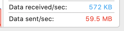

476 Mbps
