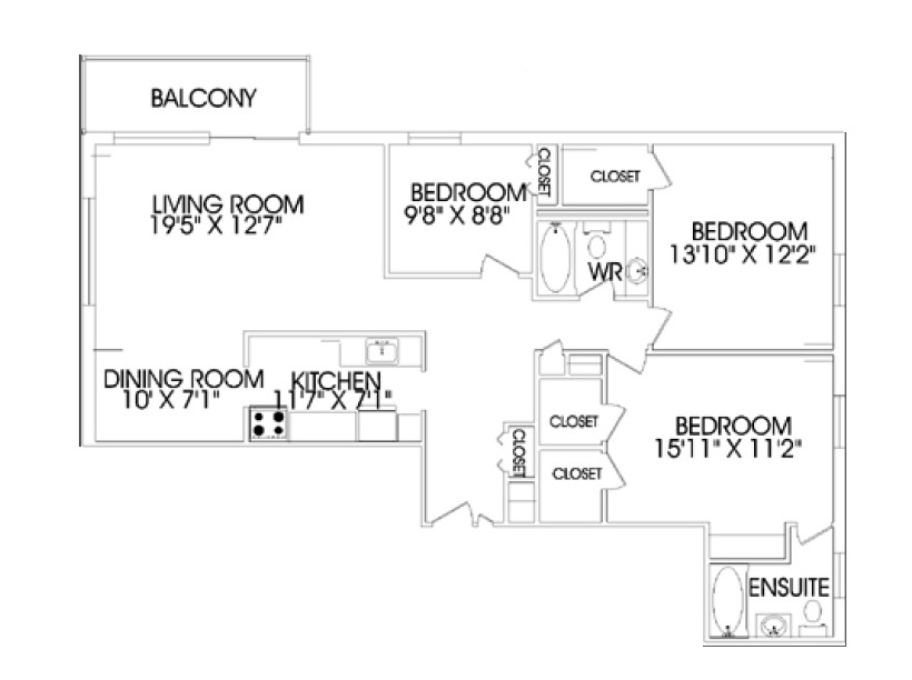

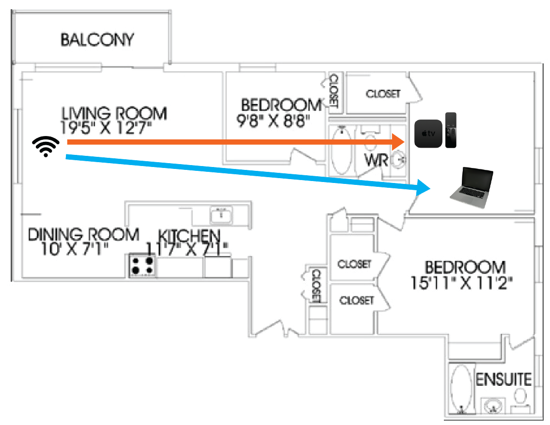

Below is my apartment layout. I'm in the top corner bedroom where my Mac and home theatre (including ATV) reside. The Airport Extreme and Rogers modem is in the living room where the cable connection is located.

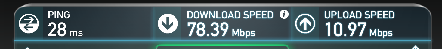

Here is my speed test results.
At my desk which on the south wall of the bedroom in the floor plan.
5Ghz

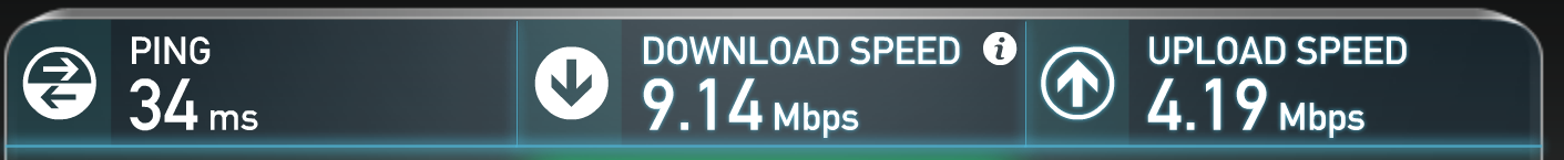

2.4Ghz

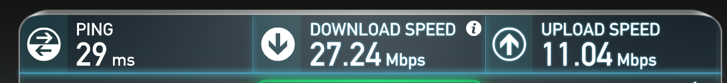

Beside ATV on the same wall as the door.
5Ghz

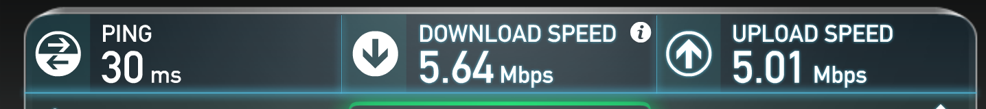

2.4Ghz

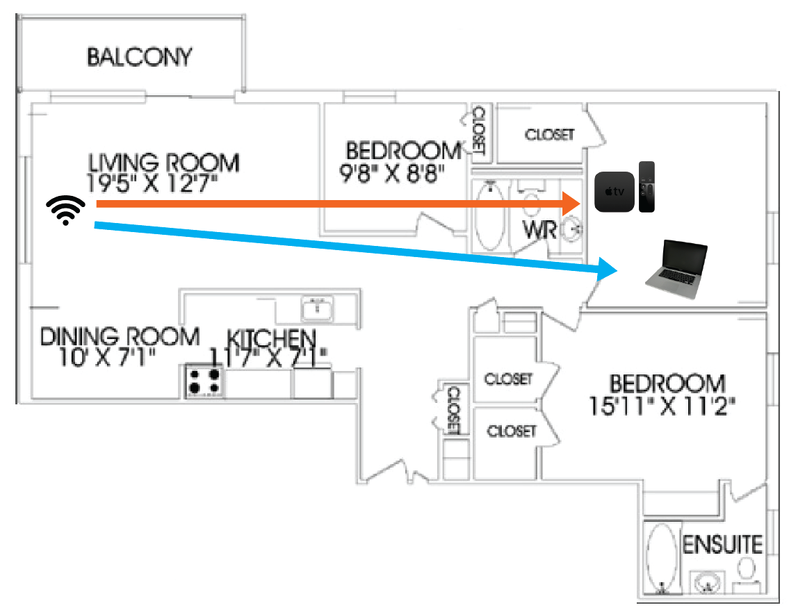

Also doing the monitor test going from my desk to the ATV there is a sharp drop in connection. So maybe there is some interference. Thing is that the wall outlets are only located on the walls where the desk and TV are located. The outside wall with the window has a big baseboard heater running end to end. The north wall has nothing but I'd rather not put any electronics on that wall cause early this spring there was a water leakage along the baseboard of that wall.

Assuming I understood your apartment layout correctly, the ATV needs to get a signal that goes through a room and a bathroom, both which have many things that can block the signal while the desk with the Mac only has a door. If the tub in the bathroom is steel, the problem is even worse. The North wall might be better, but not by much.
If you just move the ATV to the desk and try to watch something on the TV, does the signal improve? If it does, then you either need to run a cable from the Extreme, move the ATV until the signal improves, or buy a Wi-Fi extender that comes with a ethernet jack so you can run a cable from your desk to the ATV (something like this: http://www.newegg.ca/Product/Product.aspx?Item=N82E16833122674).
