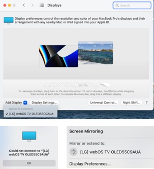

My LG C9 will not mirror using AirPlay with my 2021 MacBook Pro M1 Max running MacOS Monterey w/ latest version 12.3.1. I do have the latest LG update version 05.25.30 as well.
Airplay is On, LG C9 is recognized along with my WiFi showing. My MacBook Pro recognizes the C9 and is checked in my System Preferences under displays as shown below.
As I go through the setup for mirroring, everything works as it should until after I type in the code. As soon as it's typed in, the screen on the LG C9 turns black. While in that black state, I went into my System Preferences on my MacBook Pro and moved around the MacBook Pro and LG displays which didn't fix the problem. Also, my Mirroring window on the MacBook Pro shows that it's searching with a spinning icon as shown below. After a minute or so, I receive a pop-up stating that a connection couldn't be made as shown below.
Obviously, the C9 is recognized/connecting through all the steps until the code is typed in. After reading that some Sony owners are up and running, I would lean towards LG needing to get up to date. I did send my input to LG Support. Thanks

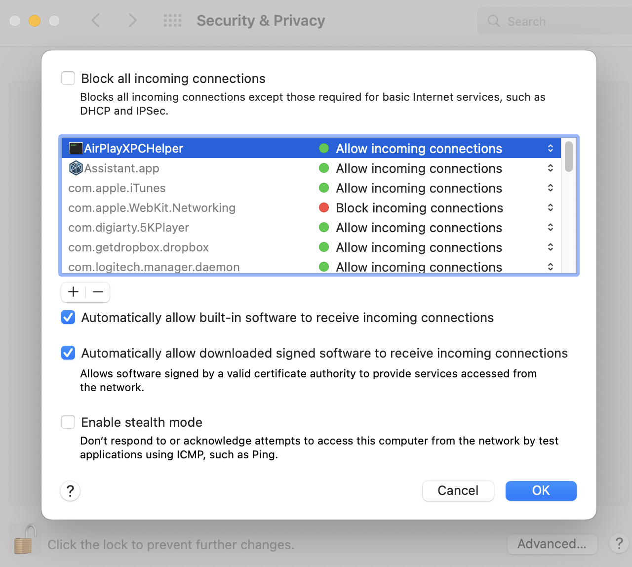

SOLVED!! I dove into my Security & Privacy Settings in System Preferences and stumbled on the following;
Firewall > AirPlayXPCHelper > Allowed incoming connections
Now all works as it should...... For some reason, Apple decided not to default this as allowed. At the very least and especially with all the people that are having this same issue, Apple should have a pop-up upon clicking on Screen Mirroring asking if you want to allow it. This would save the huge P.I.A. of figuring out this problem. Hopefully, this will correct your problem with getting past the black screen/no connection issue. :)
