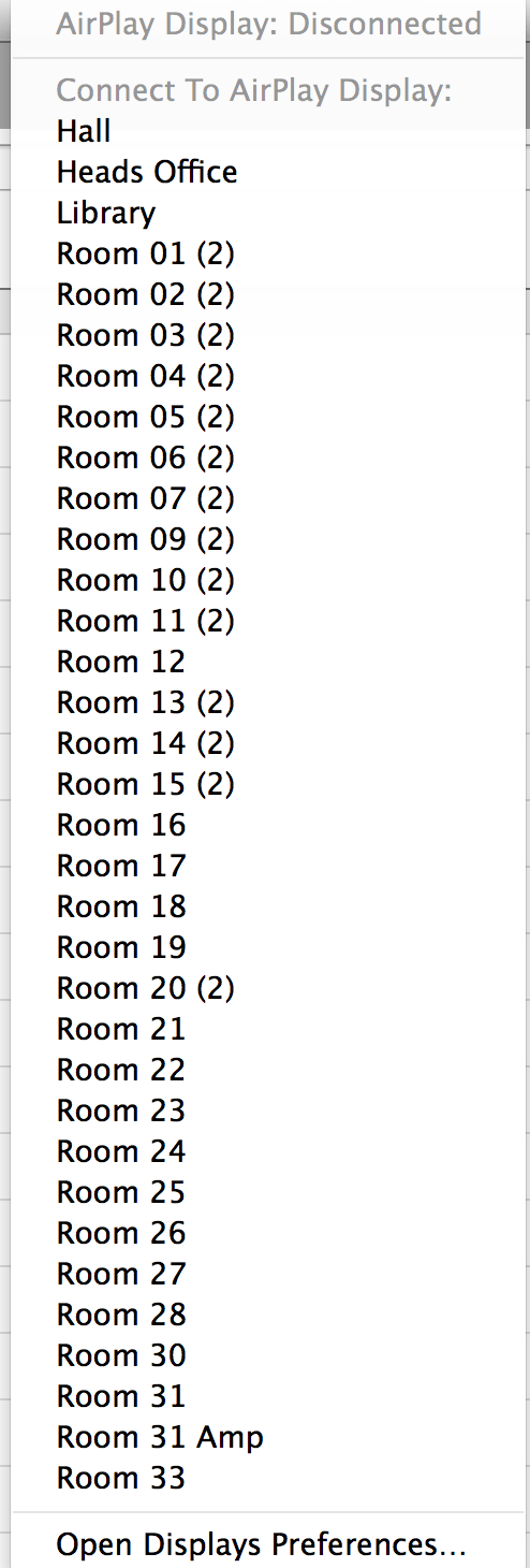

Slowly we are starting to see (2) next to the airplay name as shown in the screen shot. If we look at the device name in the settings it does not have a (2), so any idea whats causing this?

My guess is that Apple keeps a table somewhere of all registered devices on a network. When the Airplay device loses its connection, for whatever reason, it is not purged from this table fast enough, and there is a conflict when it reconnects with the same name.
Since the Airplay service is an interesting dual server and client service on all the devices without a centralized server (each device acts as a server at first waiting for connections from a client, then when a connection is established they switch roles and the device becomes a client and the earlier client becomes a server), I am not sure how Apple keeps this table up to date on all the devices.
However they do it, it's obviously not purging prior instances of a connection quick enough and causing the conflicts you are seeing. Most likely each device keeps its own table, but once there is a single conflict on any device causing the renaming, the renaming is propagated to all other devices.
Again, this is just a guess based on my prior experiments (years ago) trying to reverse-engineer Airplay.
I am having this issue happen on my Imac running 10.9.5 as well. I can leave the computer off, change the Apple TV device name to something totally different. As soon as I check it using Airplay on the Ipad it shows as "name(2)". It is interesting to note that I did replace this unit from an Atv-2 to an Atv-3 a few months back, and it is always shows the "(2)" on the replacement unit, but not on an totally different Atv-2 elsewhere in the house.
