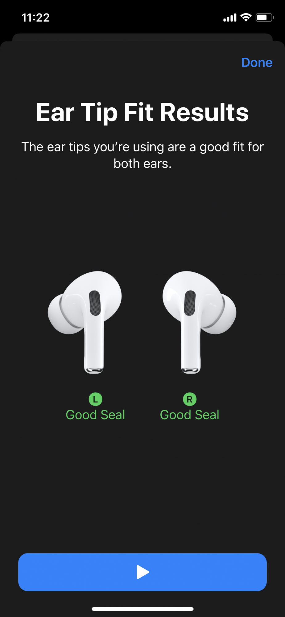

Following up on my post from December. Tried some of the suggested fixes to no avail. I contacted support again through chat and they tried to make me a Genius Bar appointment, but it didn’t work for some reason. Had to call up and go through everything again but they still couldn’t book an appointment. So instead they sent a left AirPod by overnight UPS.
Took a while to get the reset/repairing to work, but once I did I could immediately tell the new left one was better. I got that sort of pressure equalising whoosh that I got when I first got the airpods. Sure enough, now getting good seal reported in fit test.
Seems like there really is some kind of hardware thing here.
My fit test was fine before the last firmware update that got pulled, now it always fails in the right ear.
yup so glad I found this thread as I thought I was going crazy.. never had a problem with the first test until the latest firmware.. now consistently fails with the right ear.. bl00dy annoying .. still should great though! :)

I am one of the people who has been skeptical this was a hardware issue. Mine had stopped passing the fit test sometime in December after several weeks of use. Sucking on them never made any substantive change for me.
However, yesterday I tried cleaning the grilles with blu-tack as suggested here, and once again, both sides pass the fit test every time. It wasn't until after I'd cleaned them that I thought to dig out my kid's 25x handheld microscope to inspect them, but at the moment they are perfectly clean/clear.
Noise cancellation may/may not be better. I can't comment on that yet, but I am intrigued.
Just tried the Blu Tack trick. Absolutely worked! Stuck it on all the grills for a few seconds and presto, ear tip test passes each time, bass was way more active as well. ANC still blows from the firmware update though. Before using the Blu Tack, neither ear passed the ear tip test after One week of owning.
Reactions: jbryant705
Wow after trying everything it still failed on both ears. I tried the Blue Tac (Loctite) brand and now both get a good fit. It took me about 10 min or so but it works. This is 100% a hardware issue with the grills getting dirty. maybe Apple should include the Blu Tak and instructions with the airpod pros. Using a brush to clean it as stated in their care instructions does not work.

I thought test fit did not work either but After you press the play button on the next screen you have to scroll up and you’ll see another play button.

Lol... well just want to confirm that Blue Tack definitely works (I also used the Lok Tite brand). Fit test passes again after cleaning. Cleaning with anything else doesn’t seem to make any difference. :p:eek:
