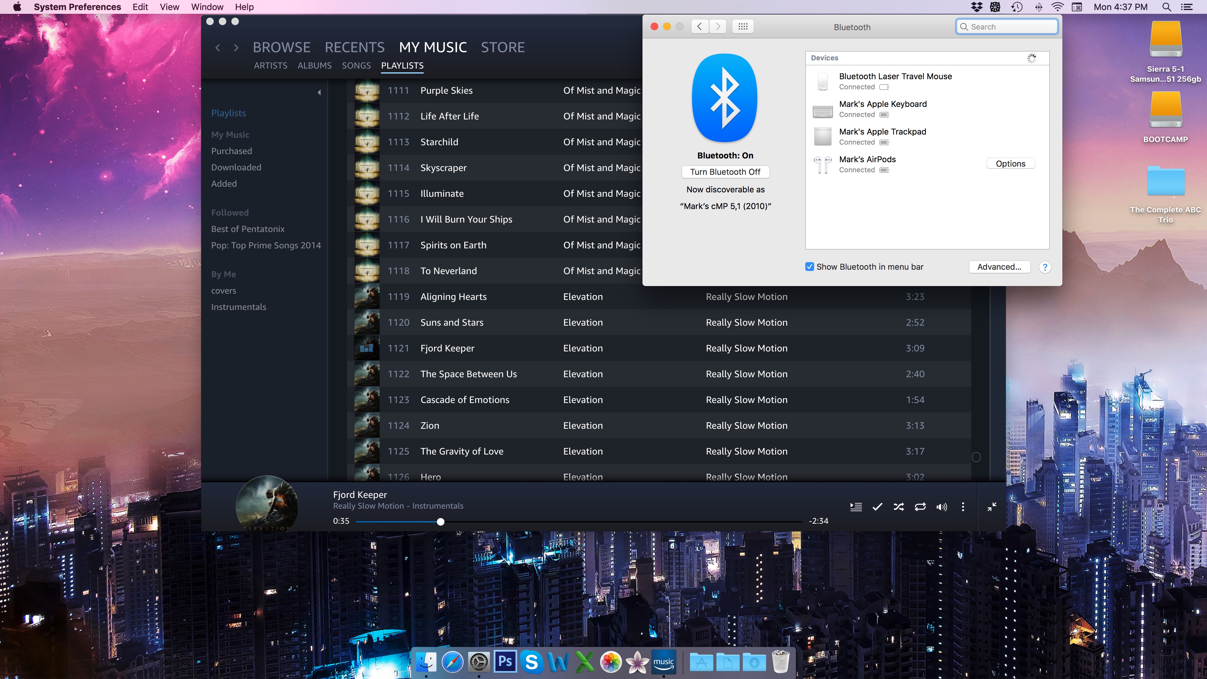

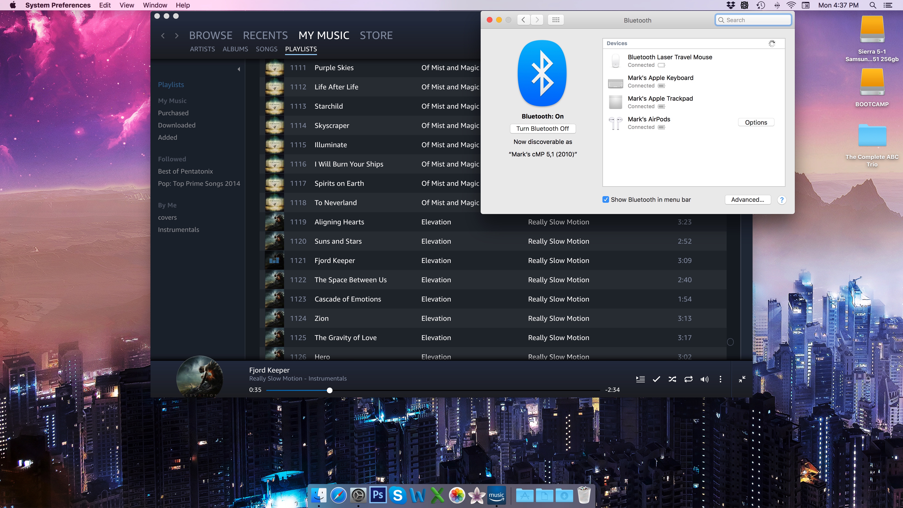

Hey everyone. I picked up a pair of AirPods over the weekend, and so far I'm digging all that they do, but I'm running into an issue when they're connected to my 2010cMP.
I always have an apple bluetooth keyboard (gen 1 no numeric keypad) and Magic Mouse (gen 1). I occasionally have issues where the mouse seems to get sluggish, and even more rare, disconnects. It usually reconnects after a second or two.
When using the AirPods, i also seem to get occasional breakup of the audio. When this happens, it's like listening to a stream buffer.
Finally, with those three devices connected, if I turn on my Magic Trackpad (gen 1), the AirPods stop receiving audio. They still show as connected in the bluetooth drop-down, but I just don't get any audio. If I turn off the trackpad, the AirPods seem to work again.

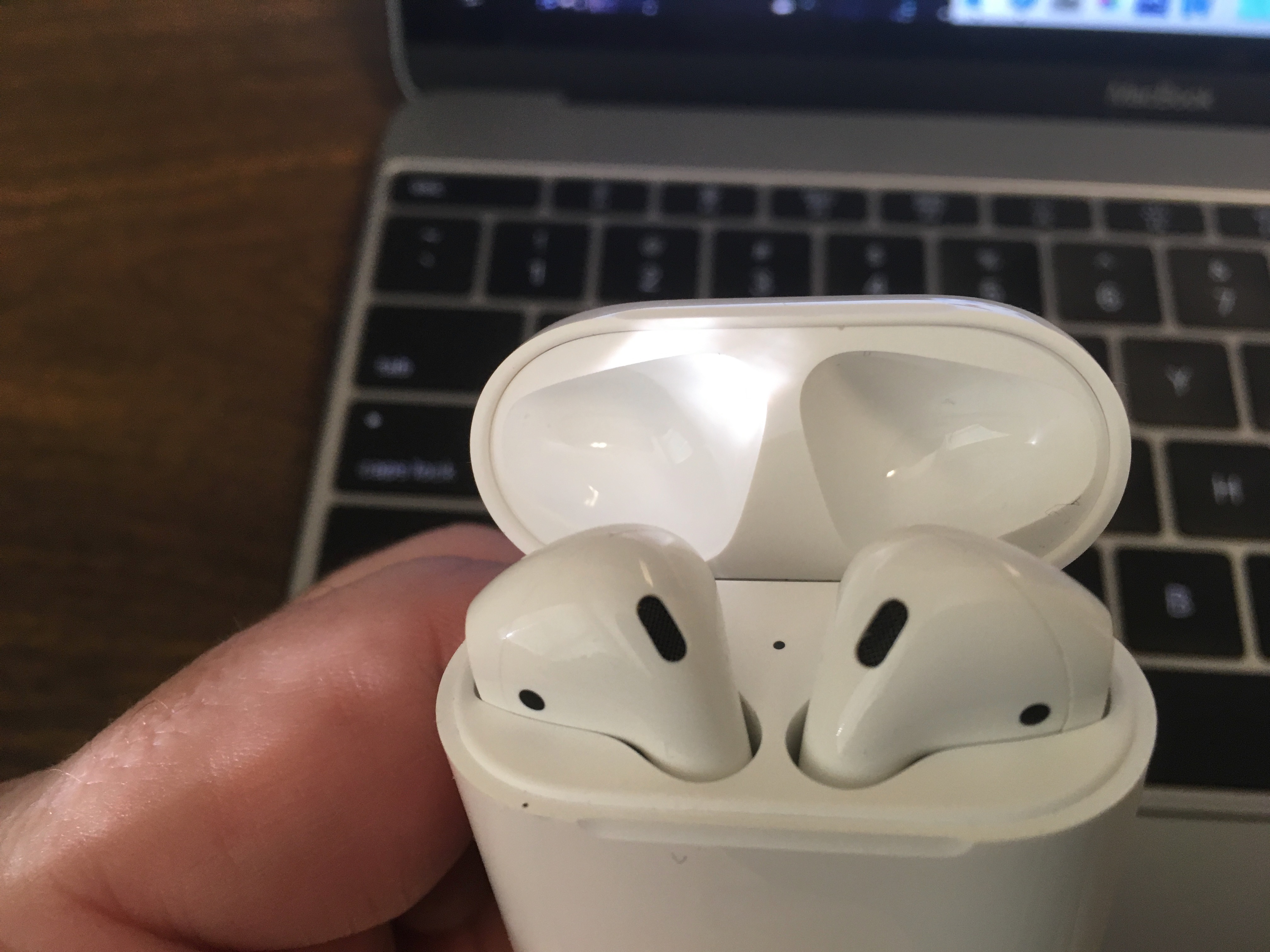

Finally, there appears to be the electronic equivalence of panel tolerance on the right AirPod. Is this normal? I don't see it on the left unit. (I see the seam, but it's smooth.)

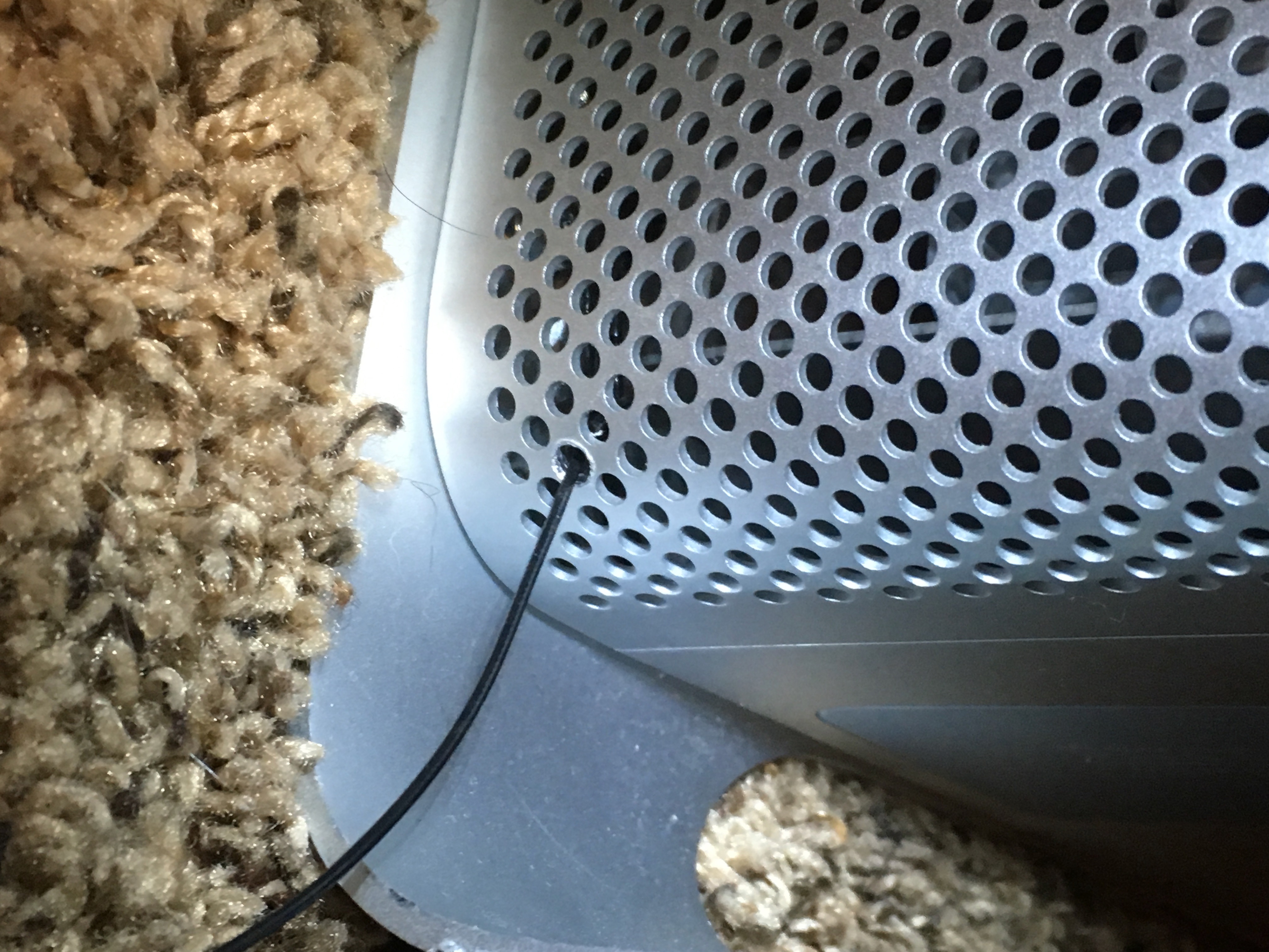

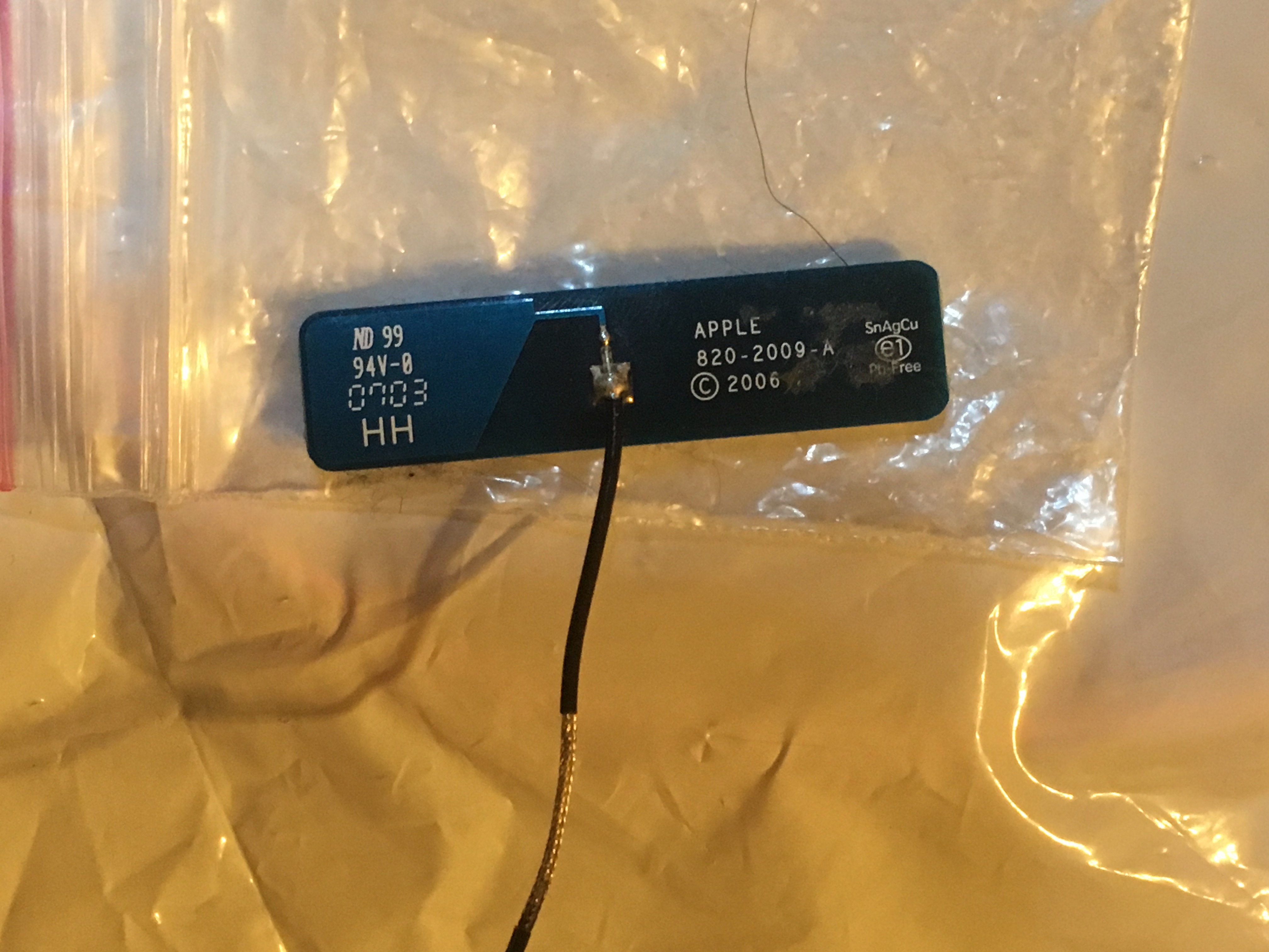

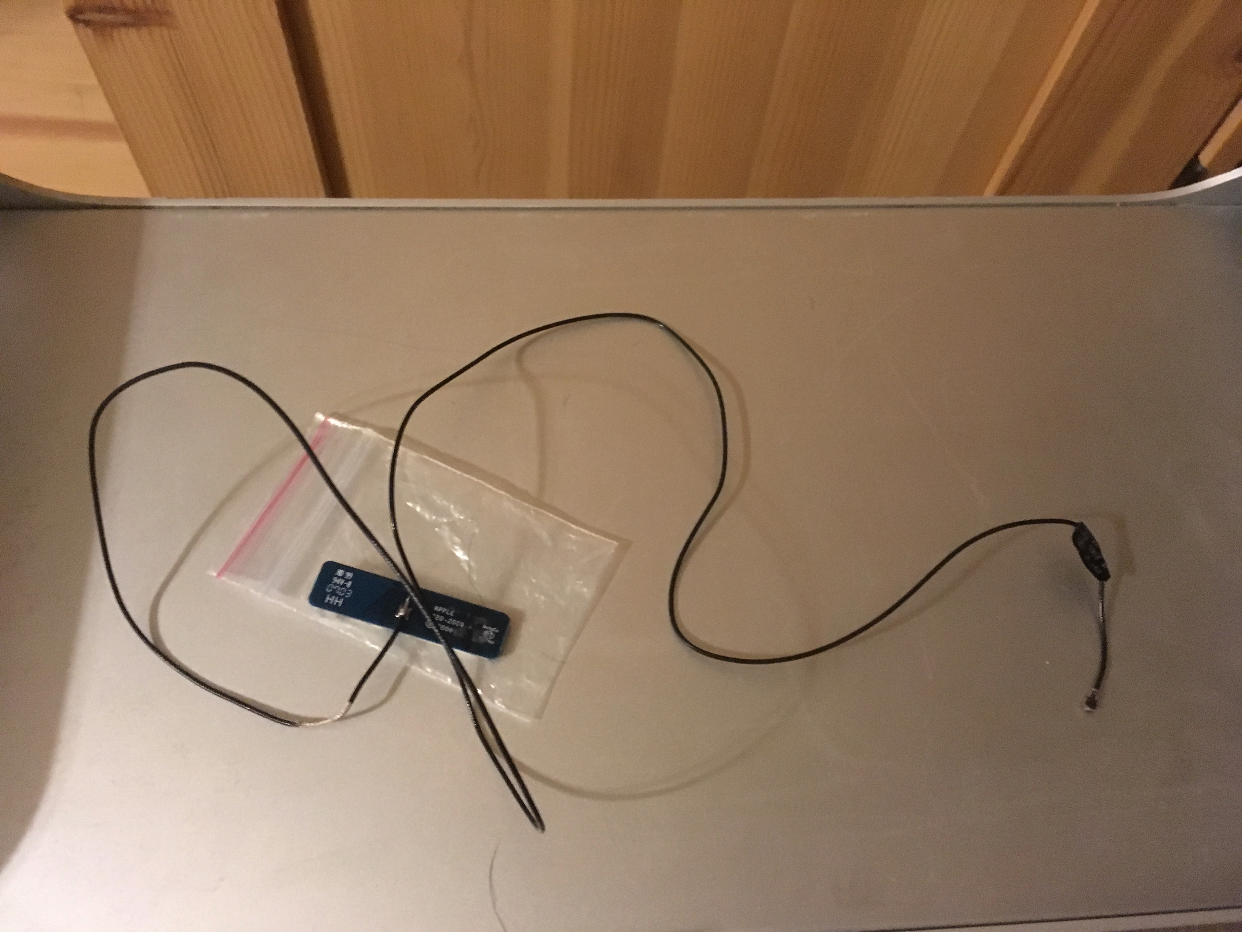

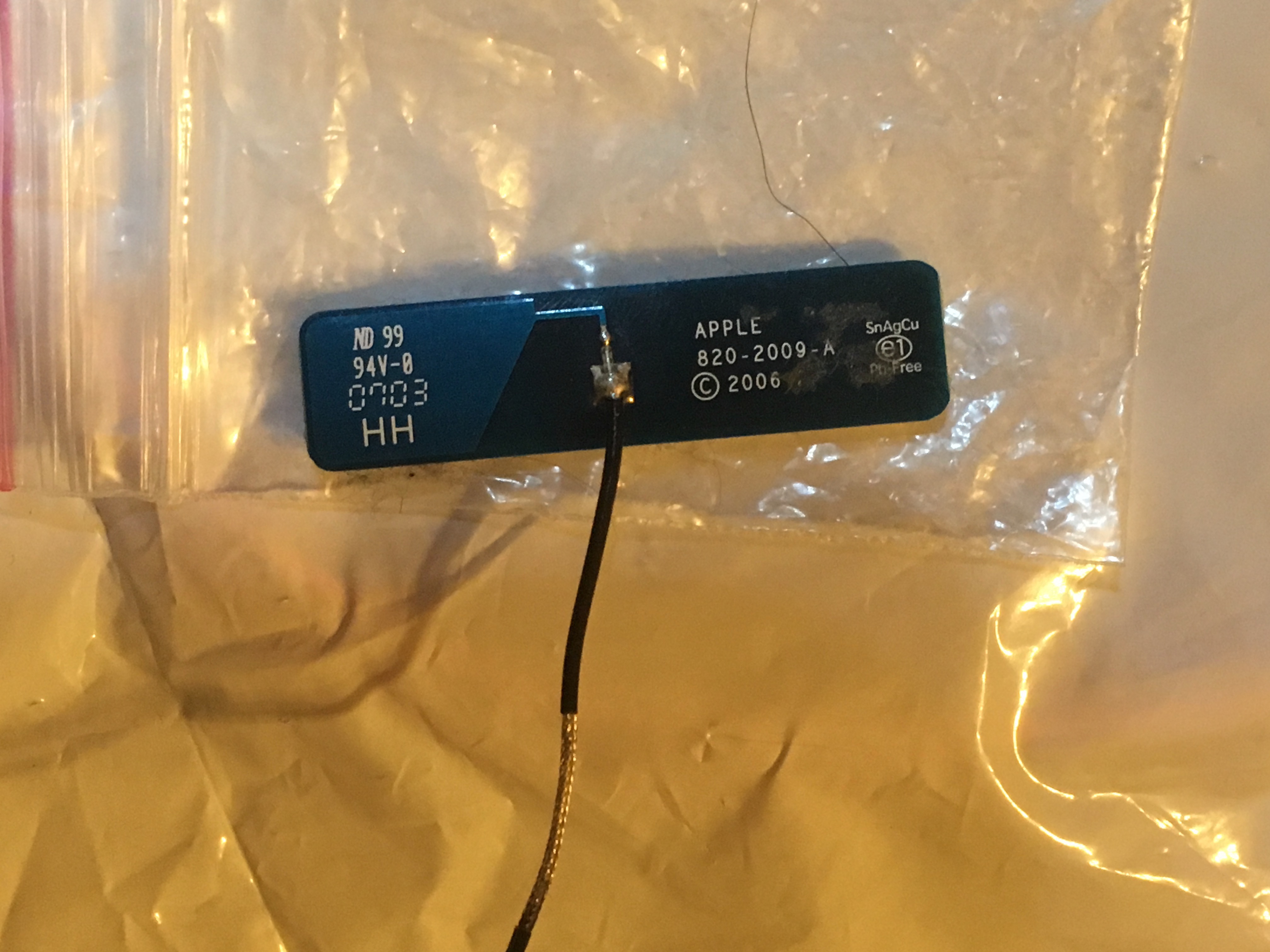

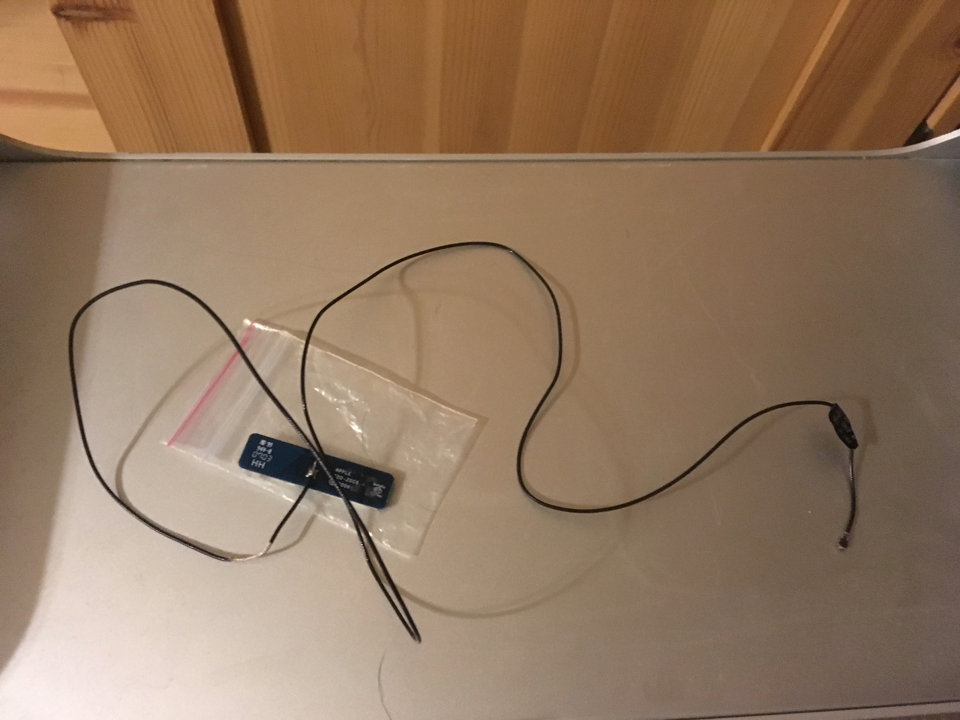

I was able to resolve the issue. As many of you know, I'm a fan of using genuine apple parts for my hacks, etc. I found this wireless antenna in my stash o' crap:
(I think it was from a 2006 polycarbonate iMac.)

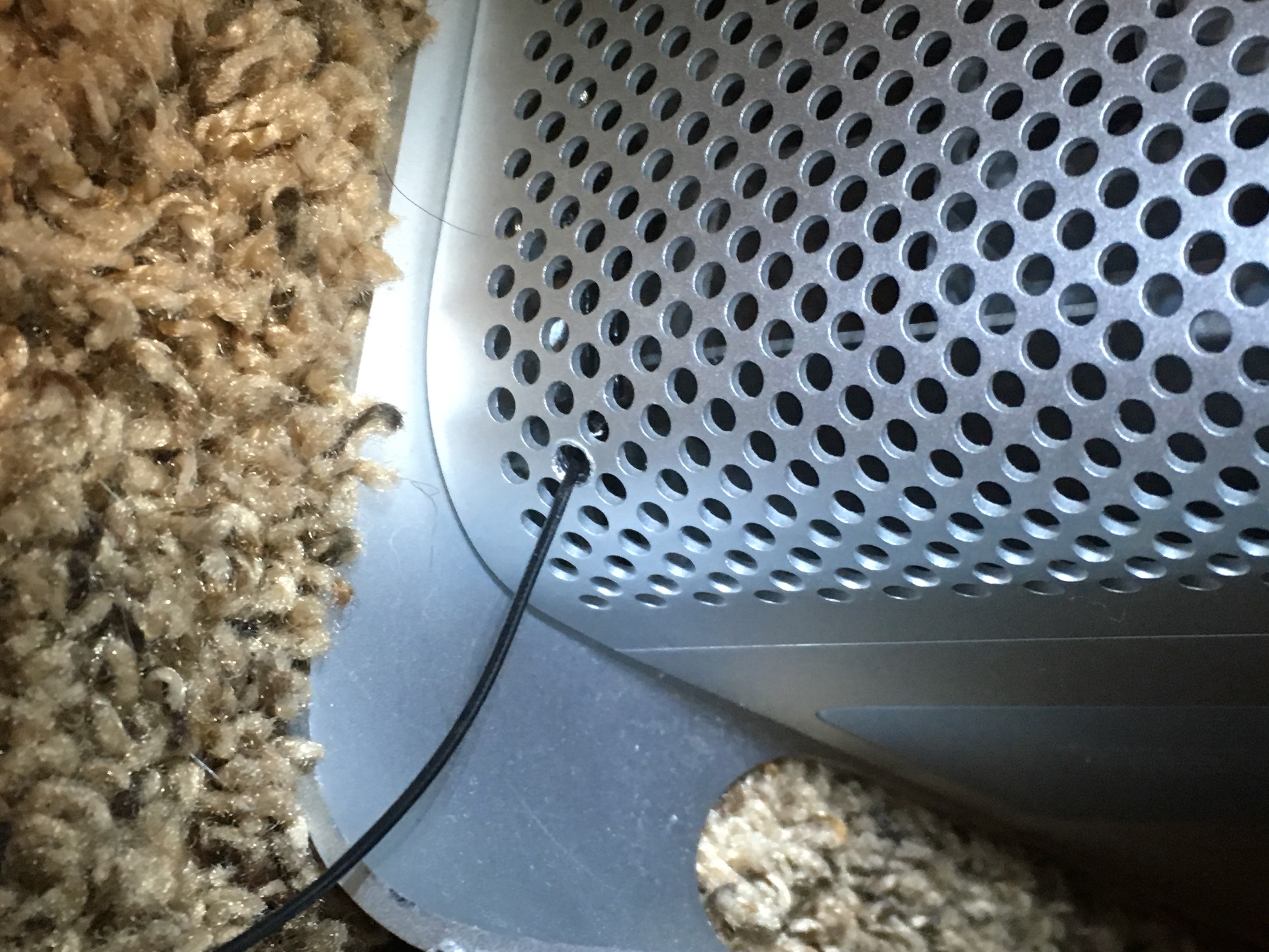

I used an awl to slightly expand one of the aluminum perforations. The header almost fit without doing this. I suppose that if I were to make this pretty, I'd desolder the lead from the antenna, feed it through an unmolested perforation, and resolder it.

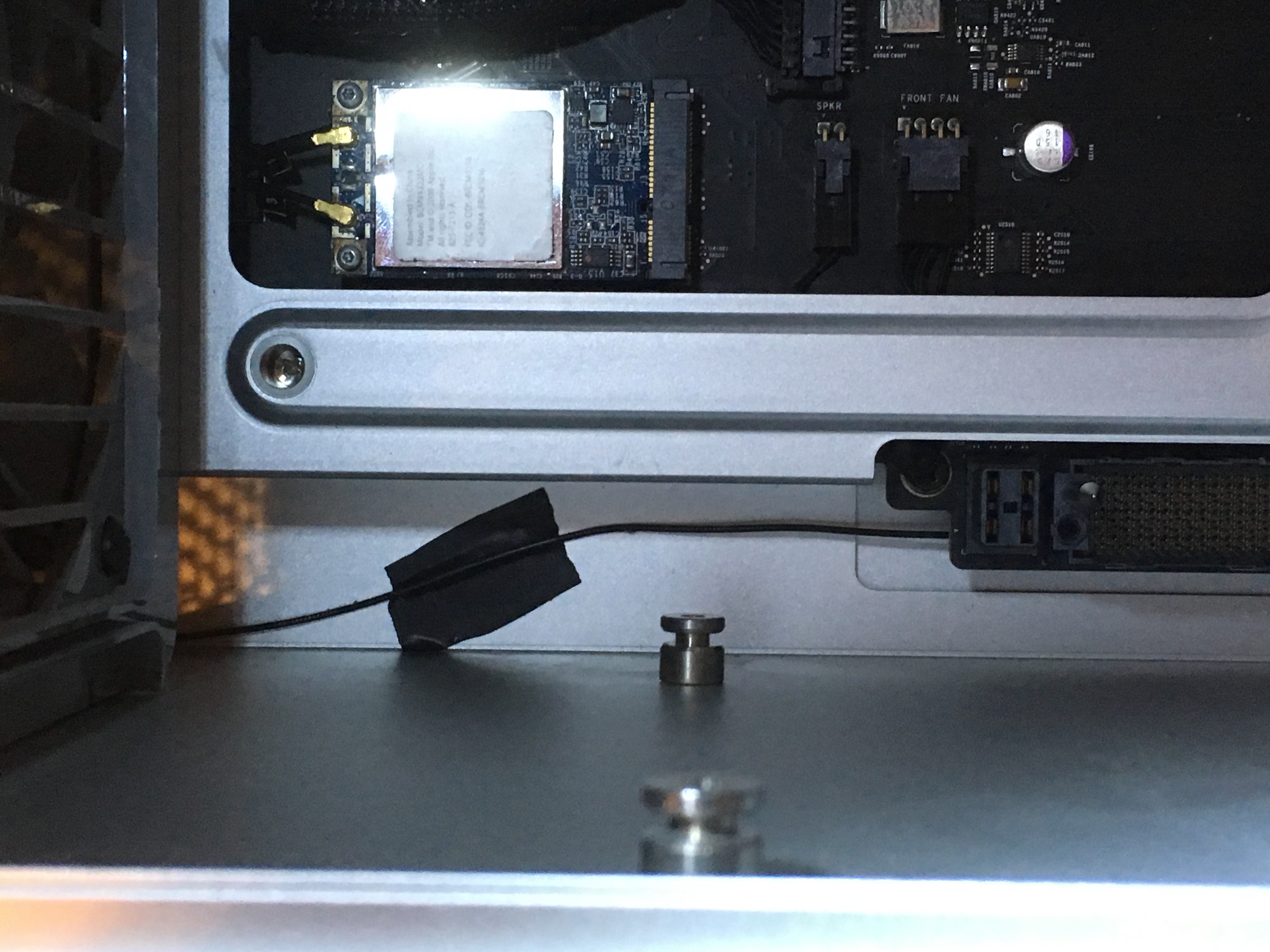

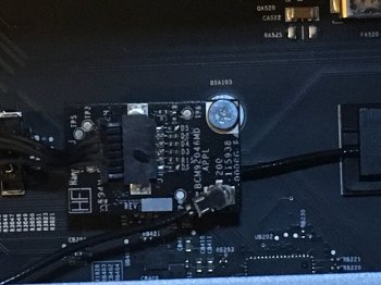

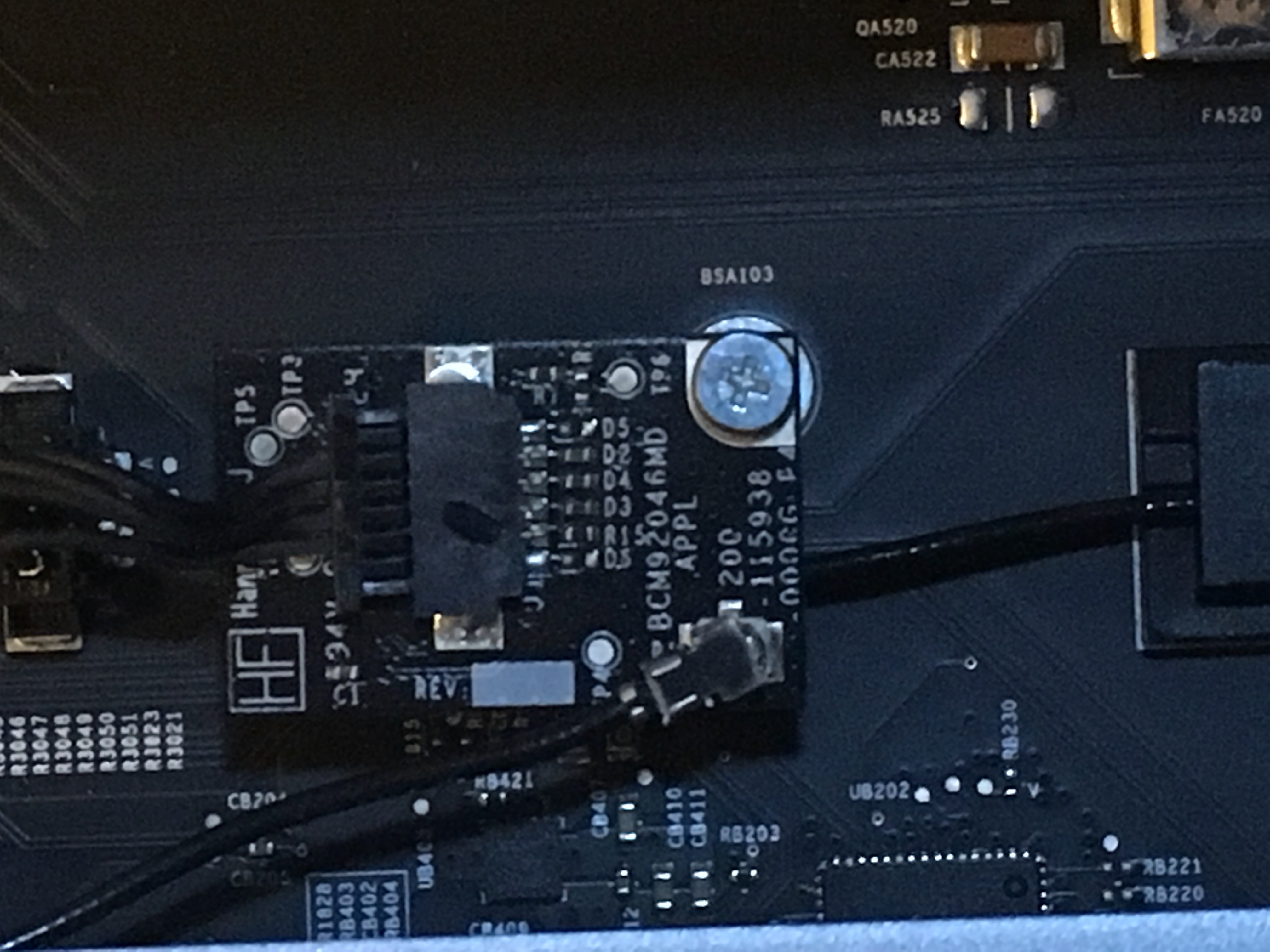

The original BT lead is tucked under the card

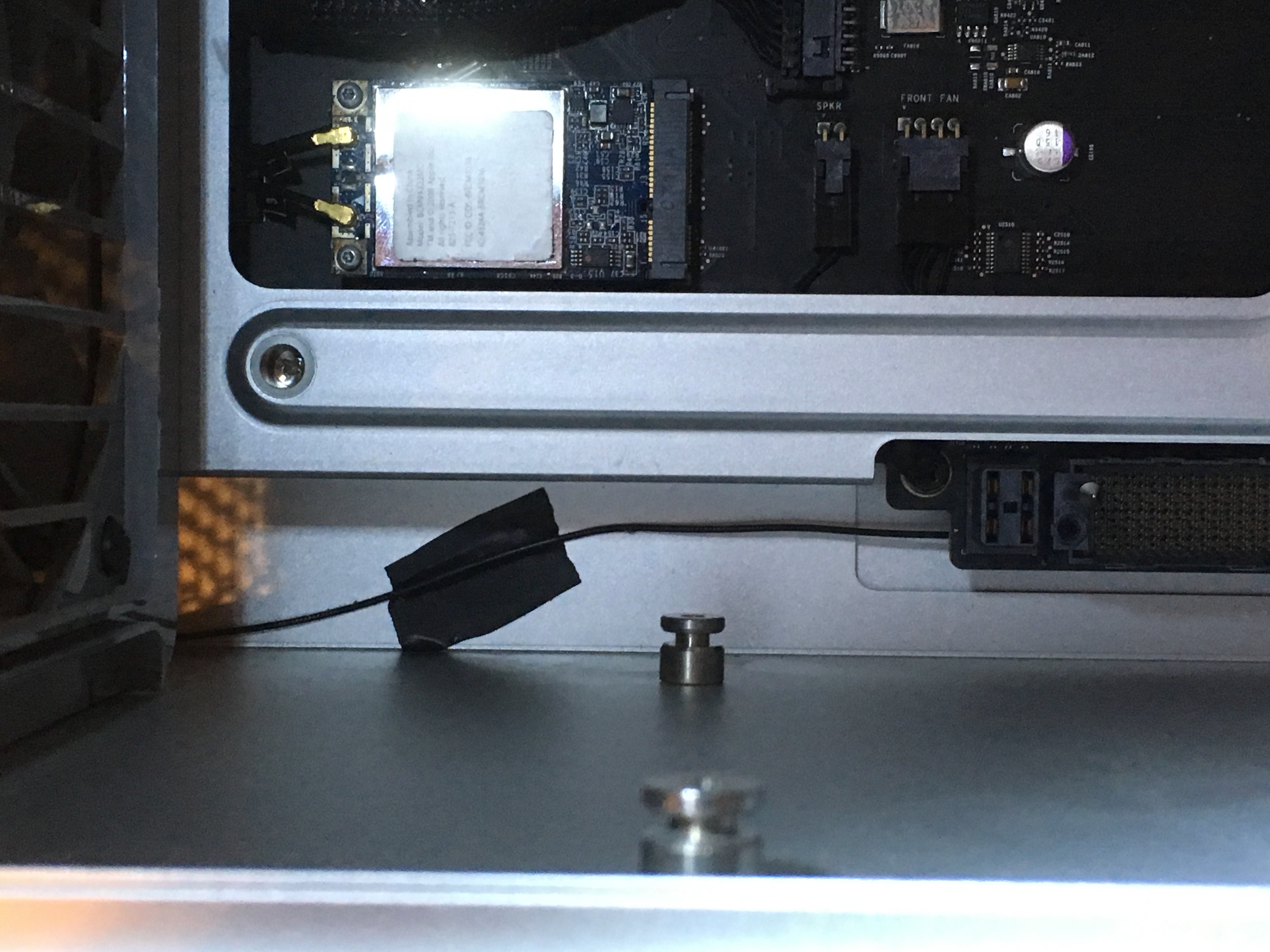

I fished the new antenna lead so it wouldn't interfere with the CPU tray, and adhered it with a piece of electrical tape.
And voilà, all devices are connecting.
