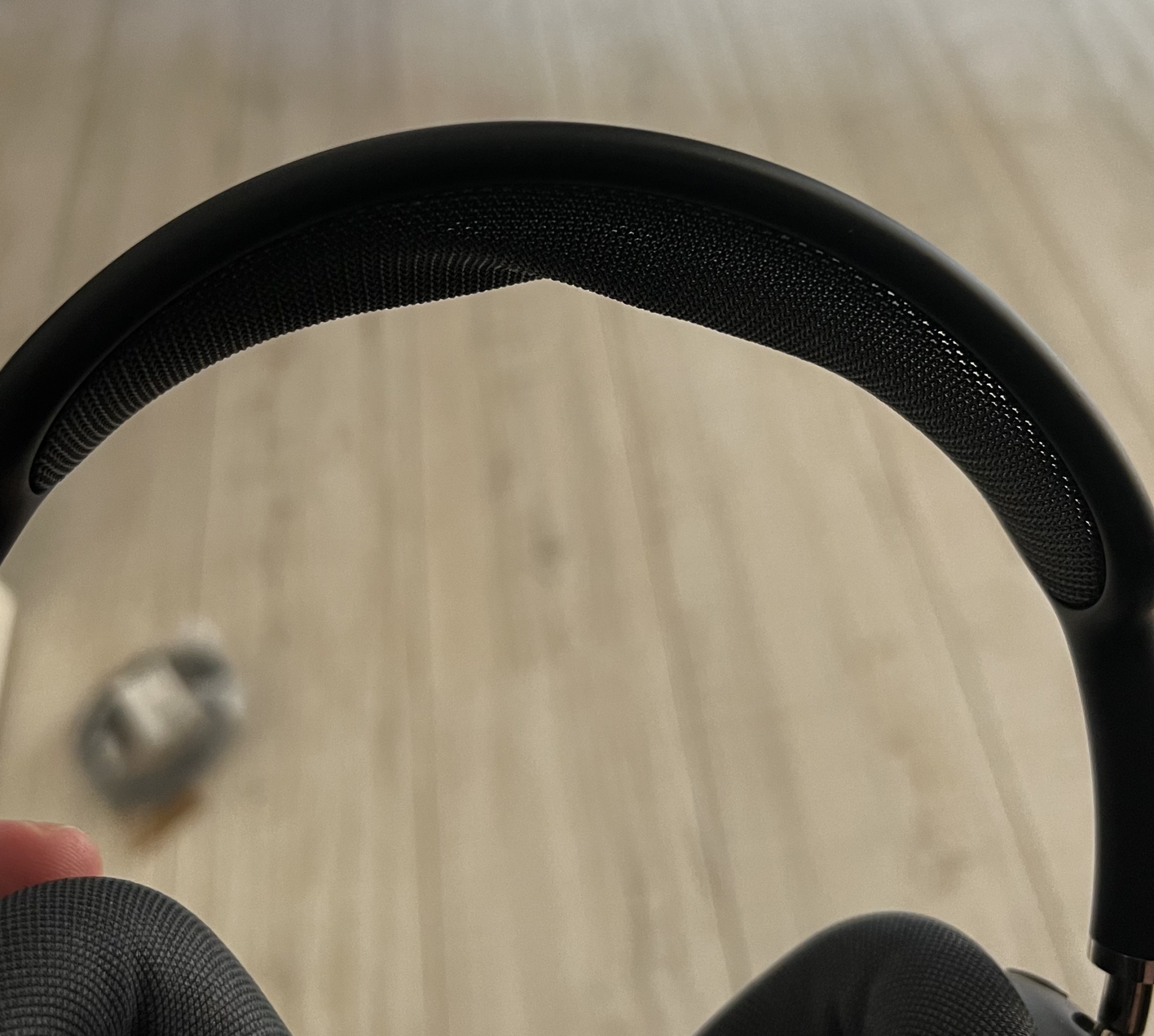

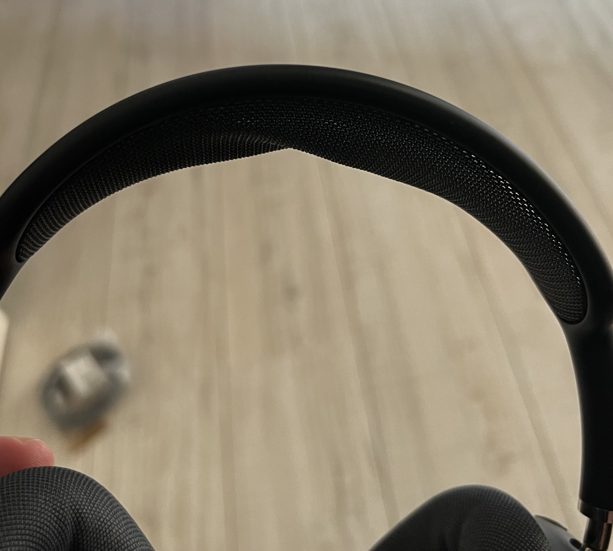

Have had my AirPods Max since launch, use them for around 5-7 hours per day with work. However, recently the mesh on headband has started to loose its elasticity and now when wearing them the hard plastic part of the headband presses into my head and they are extremely uncomfortable after 20 minutes of wearing them.
Do Apple offer replacement headbands as a service part or will I need a whole unit replacement?

Hello MacRumors,
I made an account to share my experience, thanks for the info everyone. That is a great idea Perexr10, to buy a cover for the headband. I might do that just to personalize mine, my relative bought earcup covers with flowers printed on them to match her MacBook case.

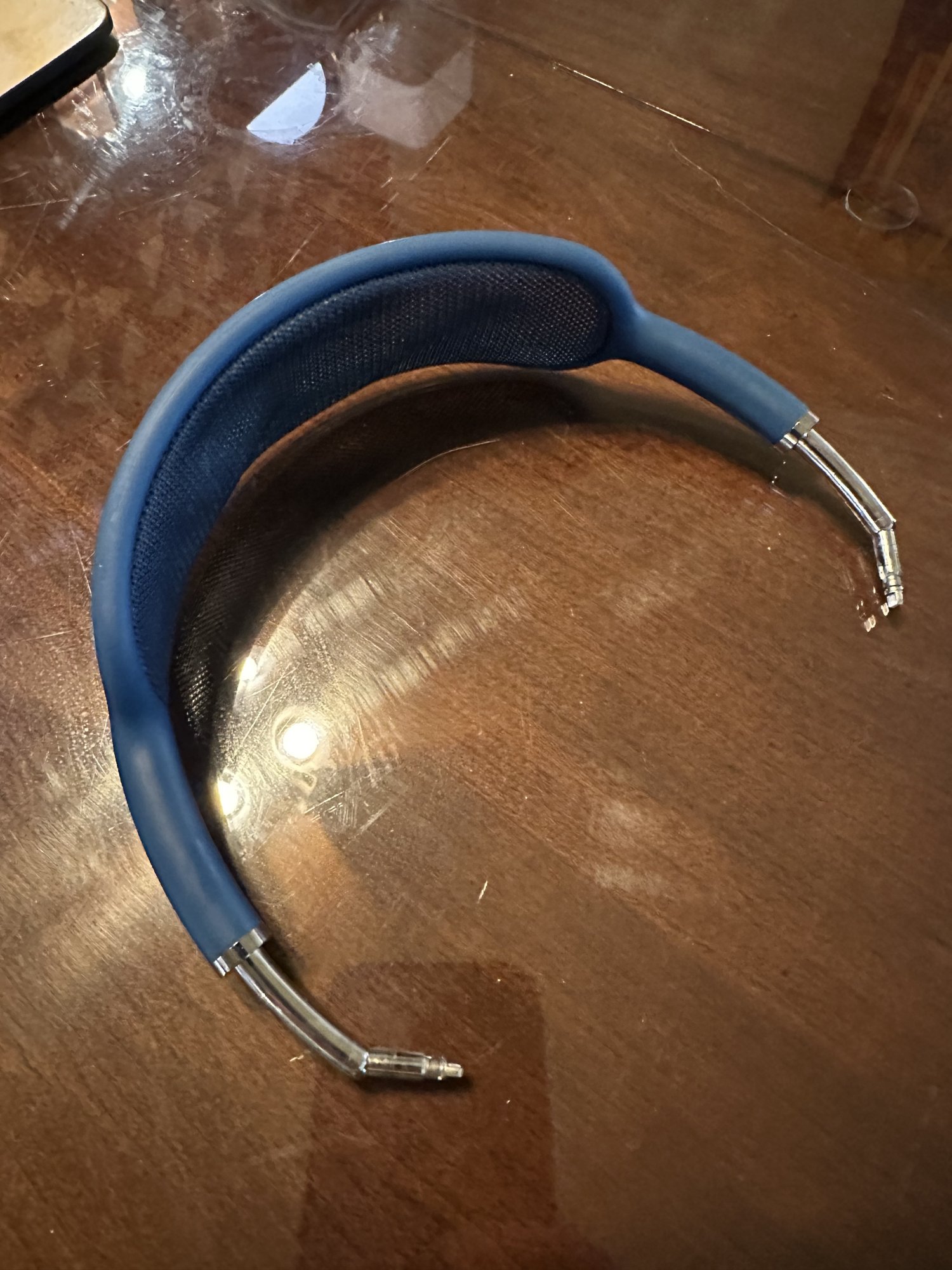

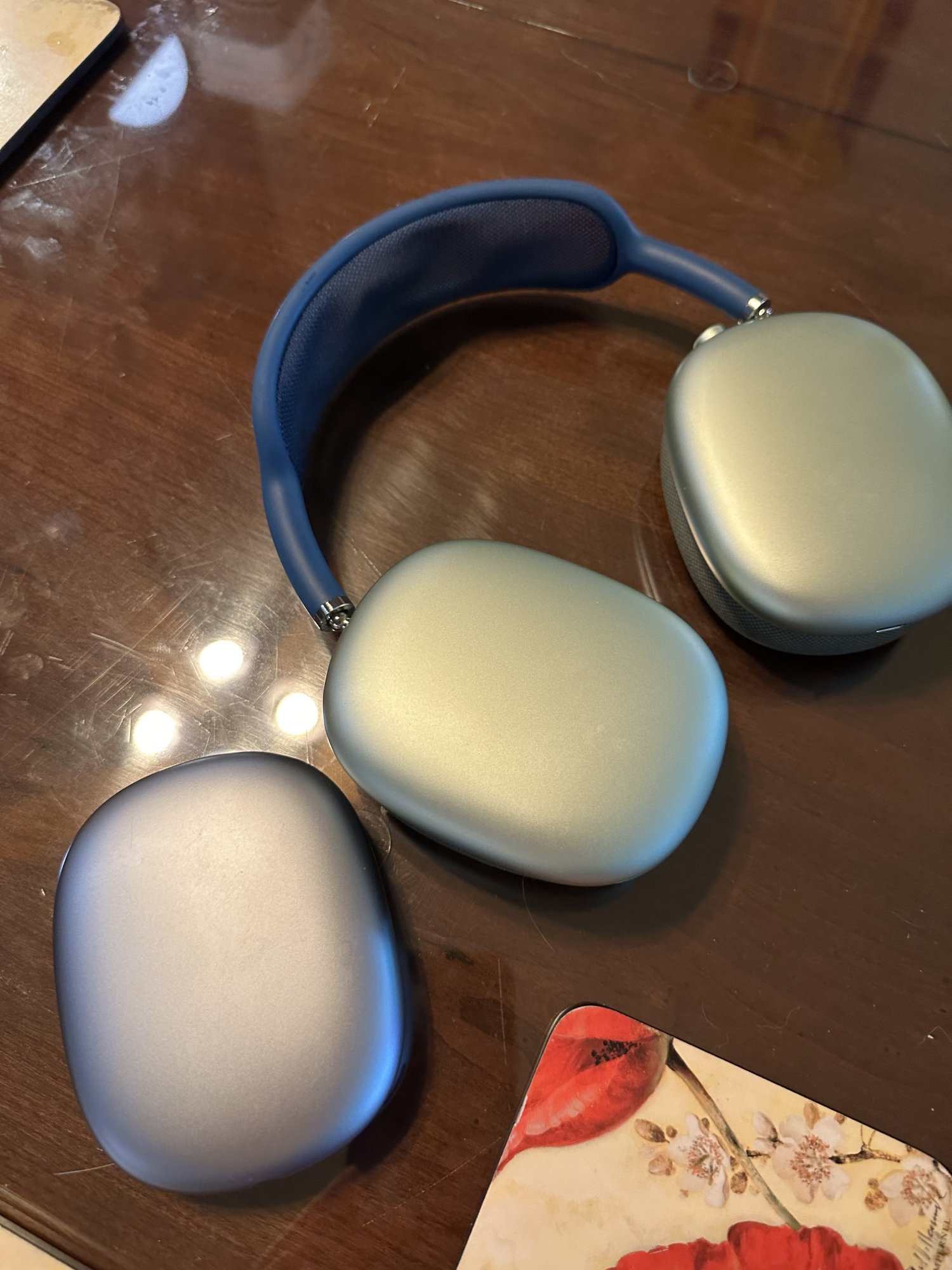

I was also able to remove my headband with a sim removal tool (take out the earcups and push it into the hole near the headband) so I swapped it with the headband from my old AirPods Max which had stopped connecting. Much better than that pale whitish band and I was able to give it a very thorough wash, yay!

Hello MacRumors,
