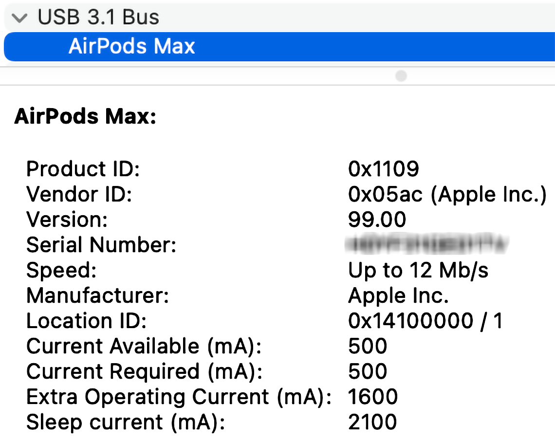

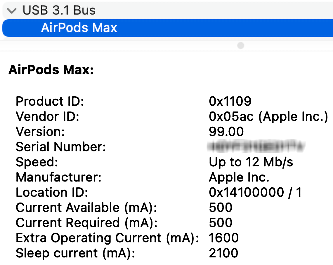

No digital data/audio connection to the Max via cable.
Not from an iPhone, iPad or Mac.
It only accepts "digital" data from the ADC in the Lightning plug of the audio cable.
When connected to my Mac via USB, they are recognized, but not for audio playback.
