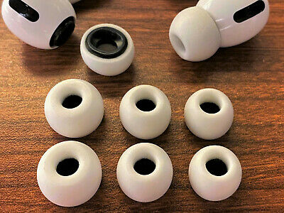

foam tips on ebay. i should be getting mine on monday
I received these. The problem is they have no wax guards. Since Apple installed wax guards on their tips, I think it is fair to assume they are necessary to avoid losing volume due to the speaker grate being clogged with ear wax. So I am going to toss them. Won't even use them once.
Yeah. they're pretty are trash. i will take the L on this one =/. gonna stick with the silicon and comply DIY combo till comply releases an official one.

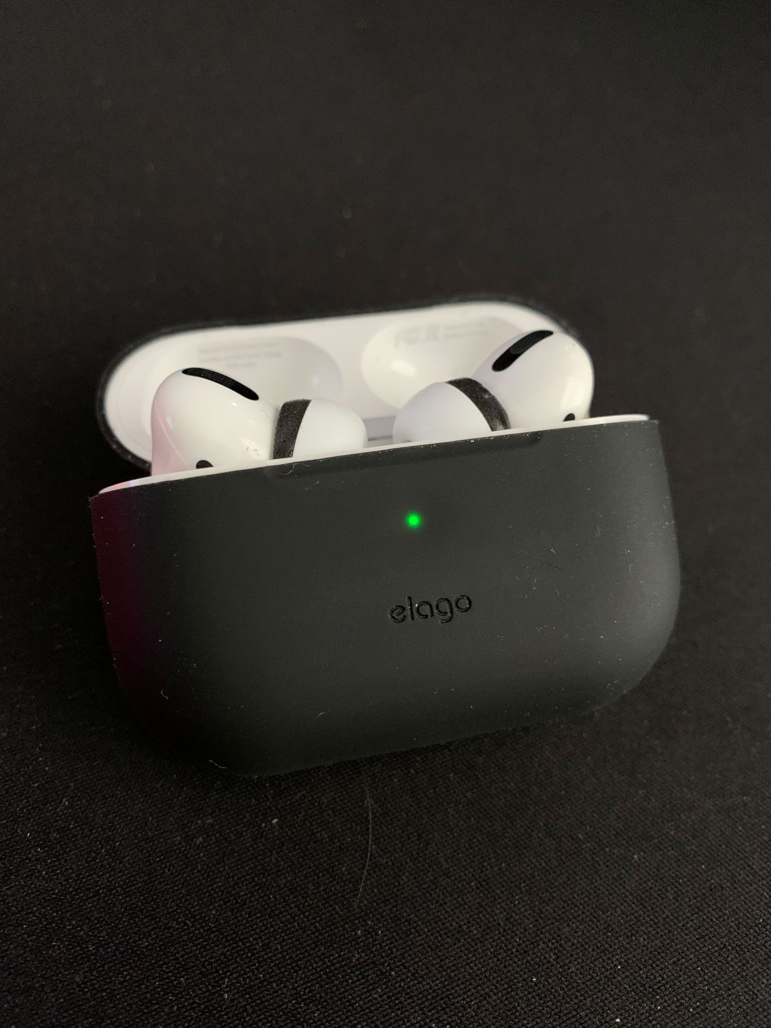

Sure thing. Here's some quick images for reference.
Fit in the case without issue:
They will generally poke out of the bottom of the silicon tips like this:
You simply pull open the silicon tip, and use tweezers to pull it through the hole in the foam tip:
Fits comfortably around the stem of the tip without any loss in sound volume, and with a marked improvement in isolation and (subjectively) sound quality:
These are Comply tips, but any cheap foam tips will work. In my case, I prefer the "softer" feel of the tips without the protective wax layer over the foam as it allows them to fit in the ears without feeling stiff.
I went with a similar approach to @Silverjerk using some extra Comply TW tips I had lying around. Yanked out the rubber core, easily pulled the foam part on over the inner core of the APP tips. In my case you can't even see the foam as there is slightly less of it. I'll be curious to see how it holds up, but from a fit perspective it's been really good so far. They had already fit me 'ok', but this was an easy mod that doesn't impact the APP in any permanent way, and has definitely improved fit.
