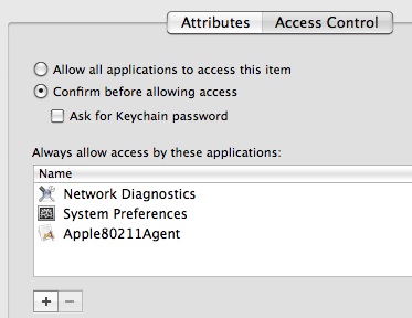

It seems that the update, erases the keychain from keychain app. connect using network diagnostic in order to establish your keychain, otherwise the network pane alone will not do it, no matter how many times you set the settings. Also check your keychain control access tab it should have 2 main elements:System preferences icon and apple80211agent. if not there add them and save changes.

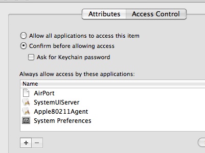

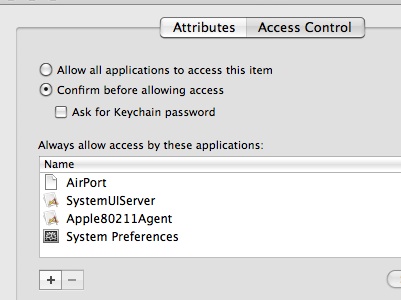

I had to delete all the plist files mentioned because it did not re-connect after I awoke the computer from sleep, so I threw away the system configuration folder, all airport plists files and the keychain, upon restarting the keychain showed the files I was looking for which is the systemUIserver and the airport deamon, (in the keychain lists as: airport) I added the System prefs and the apple80211agent. I think this stabilizes yet again the network.
