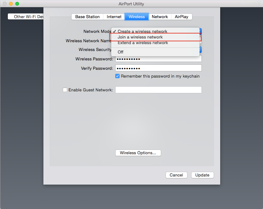

If you want to use your iPhone as the internet source for your router(s), what you'd do is this:
Create a Wi-Fi Hotspot on your iPhone, go to AirPort Utility on your Mac and set your Time Capsule or AirPort Express to "Join a wireless network", selecting your iPhone hotspot as the network to join.
Then if you need to connect your second router, connect them via Ethernet, using a normal Ethernet port on the router that has joined the iPhone network, and the WAN port on the other. Or set the second router to also join the Wi-Fi network (which won't require an Ethernet cable) (or possibly "Extend", though I don't know if that will work).
This all seems like a rather complicated idea, though. Are you using your iPhone's 4G/3G as your primary internet connection?

The Express would have to join, not the Time Capsule as when a Extreme or TC is in join mode the Ethernet ports are disabled.
