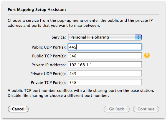

ok understood... my AirPort Extrem keeps telling me this... see picture... when i try to map a port.
Im using AirPort Extreme
