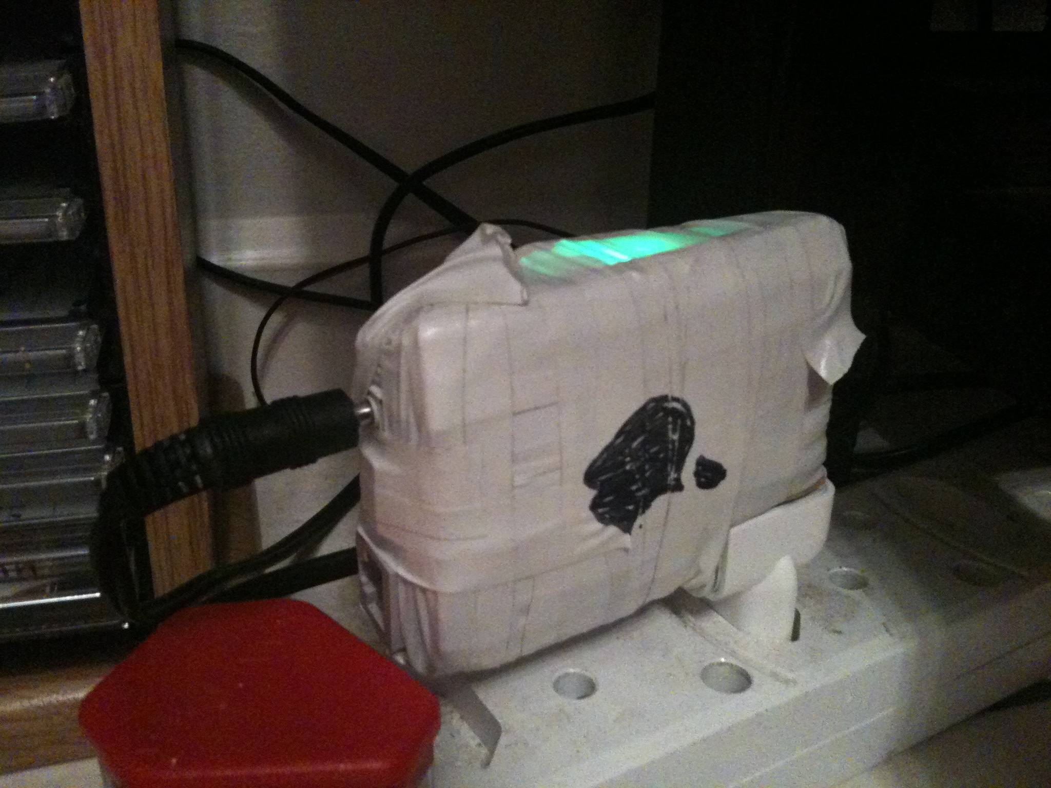

Before you trash it....
I have had the exact same issue with my AE for a while and it eventually just went on and off... Before throwing it out, I decided to crack it open and have a look at its guts...
After a broken screw driver and a few cuts and scrapes, I split it open! It basically has 2 modules connected by a tiny cable. I disconnected them from each other and put them back together, a reseat. Using a wooded spoon and safety glasses I stuck in some power and let her rip...
It works like a charm! 🙂🙂🙂
It looked horrible so I dressed her up little... Jobs would do flick-flacks if he ever saw it!

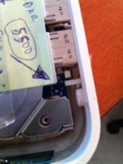

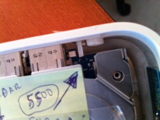

thanks a lot for sharing your experience.
my hard reset was not working... until i read your post .
1- remove the rubber from aebs
2- take the 5 screws out
3- i notice that the tiny little reset was not soldered
4- i put in the right place (hold with one finger)
5- plug the power
6- press black reset button with a screwdriver
7- volia aebs reset
8-plug the ethernet cable and the aebs appears in airport utility
9- works like a charm-
9- but i send to a repair to try to soldered that tiny reset.
