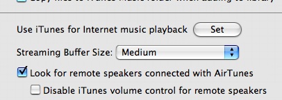

Are you sure you've told iTunes to look for remote speakers?
Yep - the button to choose which speakers appeared last night (but not this morning) - so iTunes could "see" the airport express, but just wouldn't connect. This morning after resetting and setting up again, iTunes does not see it. I checked and iTunes is looking for remote speakers for sure.
