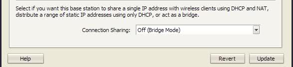

In Airport Admin Utility, if you uncheck Distribute IP addresses under the Network tab, it says, "Internet sharing using NAT and DHCP is not enabled. Client computers on the network must configure TCP/IP manually. The base station will act as a bridge between the Airport and local Ethernet network.
...Maybe this is what you want?

I am using my AirPort Extreme exactly like how you want to use yours. Even sharing a printer with other users using Bonjour.
Set it to bridge mode in the internet tab of the AirPort utility and plug in the internet connection into the WAN port and you are good to go.
