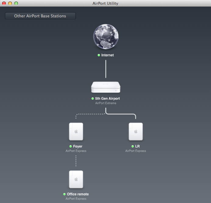

Hey Aldonin,
I just signed up to chime in, in case it's at all helpful: I've been dealing with the same sort of situation: wanting specific airport routers to daisy chain throughout our apartment, which has long distances and a ton of metal in the 85-year old plaster walls…
I like to have access to all info/settings, so I run the more versatile Airport Utility 5.6 (I'm running Lion, so I had no problem installing it). -As an aside, you can also run 5.6 on your Mountain Lion machine. I presume I can't post links here, but a Google search of "install airport utility 5.6 mountain lion" handily returns a lot of results on the topic.
In our case, our back bedroom/office had a horrible connection, in spite of the extended network that I set up throughout the home: One Airport Extreme (5th Gen) and Two Airport Express (N models). The issue was that the AX in the office was connecting all the way back the main base station, instead of the AX that I'd expected to serve as a "relay", based on it's location midway between the other two. So, same problem as you, I believe.

Or you could try what I've done:
Option 2:
Move the routers back to exactly where you originally wanted them. Then just use the "extend network" scenario (like you are) and use the v5.6 Airport Utility to crank up the "Multicast Rate" on the primary base station. This will, in theory, prevent weaker connections from being accepted.
Once all are configured as you like, power everything down, then turn on the main station, (giving it a couple minutes to fire up) then turn on the middle one ("relay") also waiting 2 minutes, and lastly turn on the ("remote") at the end of the line.
To check your work, in the 5.6 utility you can see which device is connected to which, by clicking on "Wireless clients" in the summary window for each router. You'll need to know have the DNS numbers of your various devices (pasted in to a text file, for example) to be able to readily see what's what.
This option has worked for me, and even the 6.0 utility shows it correctly (see attachment).
One word of warning. The 5.6 and 6.0 utilities do not seem to like to both be used in the same session: After simultaneous use, I've at least once had to restart my mac to get them working again after they stop showing the routers at all. (The network never stopped working - the utilities just stopped showing the routers in the network).
It really is too bad that the latest N routers from Apple don't have a configuration that allows you to just designate "relay" and "remote" stations, while retaining N speeds. I suspect it's just an unwillingness to devote programming resources to a feature they've deemed minimally needed among users. -As you can see from various recent Apple updates, the trend tends toward the "dumbing down", not adding user control/options…
