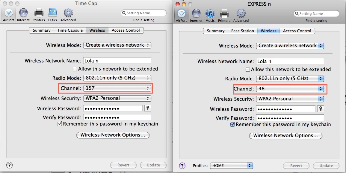

Note: In the "Wireless" tab of Airport Utility, you would select the option to "Create a wireless Network" on BOTH base stations. Here is a screenshot of my setup:
Apple has an article on the subject:
http://support.apple.com/kb/HT4260
In the above article, their channel selection is set to automatic, which I disagree with. Set yours manually, as shown in my pic above.
