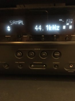

My experience has been the opposite. AirPlay 2 connects to the AirPort Express quickly and I getting a copy of the song to the receiver (PCM stereo 44.1kHz sample rate Apple Music stream) via Toslink just as I was with AirPlay 1.
I do have the Express setup to "Join the network" since I only use it for speakers in my bedroom. Not sure if that makes a difference.

That is odd, in this circumstance AirPlay is lossless and nothing was changed about that between AP 1 and AP 2 in that aspect. There is something seriously wrong if you have difference in audio quality.
If your setup is similar to mine you are getting what is otherwise a bitstream all the way into the receiver.
What device are you using as the source device? What OS version is it using? Where is the audio from? What are the specs of the audio (codec, sample size, bit rate etc)?
