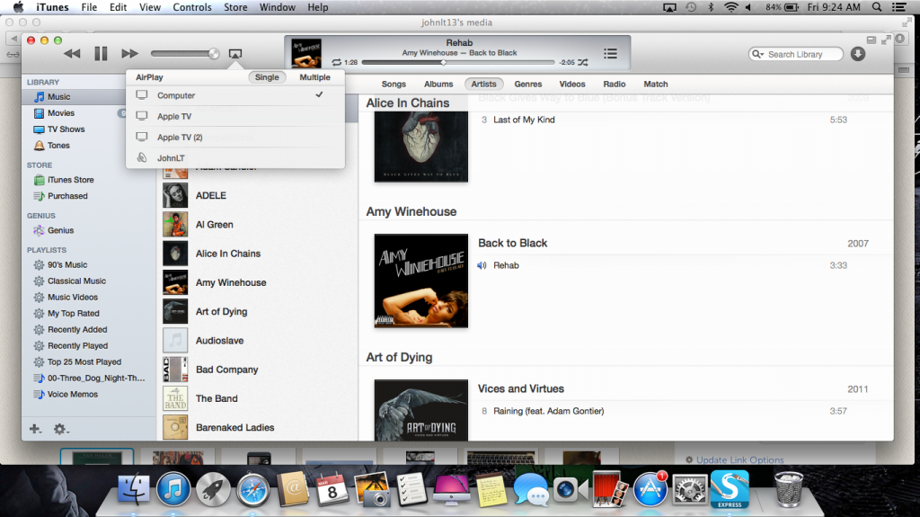

as for you connection I can't help. but i dont use an app on my phone to Air Play. I just open my stock music app and hit Airplay on my phone. It gives me these options.
From my Mac I open iTunes and hit airplay upper left and get this.
not sure if this helps, as I'm a mac noob.😀
