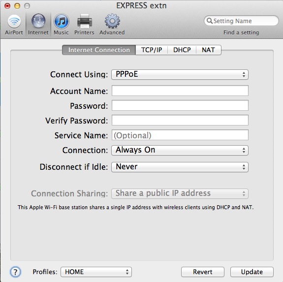

How are you connecting to your ISP? Is the Cat6 cable connected to a DSL modem, then your Airport Express? Where is the ISP? The reason I ask, is that a DSL connection may require a PPPoE login. If that is the case, these are the settings in the Internet Tab you need in Airport Utility. Note the Connection Sharing is set to "Share a public IP address":
You would enter your ISP username and password in the required fields. After that, the Wireless network setup is pretty straight forward.
Note: the above would only apply for DSL,(connected directly to the modem), not if your connection is via a Cable modem.

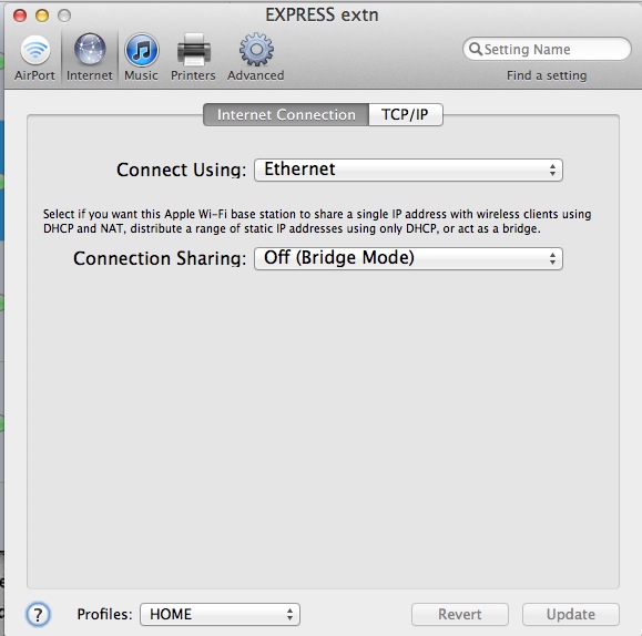

I did a similar setup for my Sister in Spain last year, where her condo just offered an ethernet outlet to which one would connect the Airport Express. You can try the setup I did for her (similar to my pic above):
By the way, I am using Airport Utility 5.6 on my Mac, as I prefer it to the newer version, which is kind of "dumbed down".

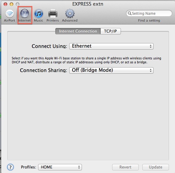

On the Internet tab>Internet Connection, the setting "Connect Using":ethernet.
Connection sharing: Off(bridge mode) See below:

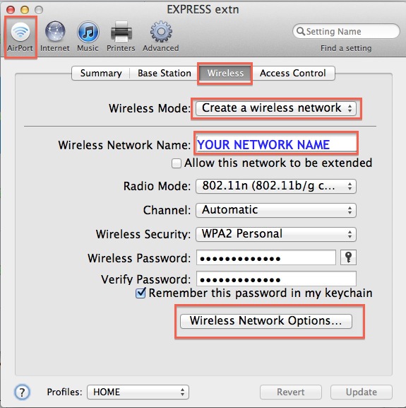

In Airport Tab setting>Wireless, see my pic below:

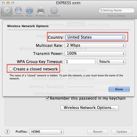

If you are worried about security/some unauthorized person connecting to your network, select the "Wireless Network Options" button (in red above), and create a closed network. You must remember the exact name of your network in this case, in order to join it on your other devices. I am not sure if these devices, such as the PS 3 have the option, like the iPad/Mac does, to join "Other network" in their settings. If you elect to do this option, when other people are around, your network will be invisible to their devices. (Hope that makes sense.) See pic below to enable this option. You would check the box to "Create a closed network":

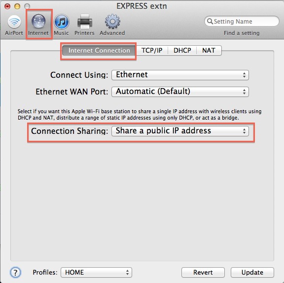

if the above INTERNET settings, do not work...(I am still not sure of your exact ISP setup), try these settings; instead of being set to "Bridge Mode", your Connection Sharing would be set to "Share a Public IP Address":
