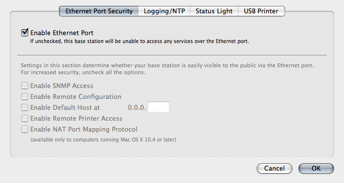

I have an airport express that I am using on with my college network. Things work fine, but, with Azureus, I am unable to share anything. I am using a campus p2p network, so it should work fine. I noticed there is a setting in Azureus to enable UPnP. It says I have to also enable NAT Port Mapping Protocol in the airport admin utility. The option to enable it and any options on the page are grayed out. I have the latest version on Tiger, and my airport firmware is current. Is this feature only offered with the extreme base station?

Anyway, I took a screenshot, are these options supposed to be grayed out?

I tried to do the port forwarding manually, but when I tried to update the airport, it failed to update, and then the airport stopped working, and my neither the Airport Admin Utility or the Airport Utility. I reset the airport (physically), and when I started it back up and did a manual setup, the port forwarding options were available, so now everything works perfectly!
Also, I figured out the original problem, I had Connection Sharing off (Bridge mode), that is why I couldn't see the other settings. New problem is that I can't see anyone else's shared iTunes libraries. When I turn it back to bridge mode, I can see other iTunes Libraries.

You wanted the wireless router to act as a bridge to your static IP instead of a DHCP server that would assign you your own private addresses. You can share music when bridged since you'd be on the same subnet as your peers but you'd get no port forwarding.
Can you still forward ports while bridging? I don't see a need for NAT either if you're not going to be using DHCP.
When I am bridging, the port forwarding options and NAT options all go away.
