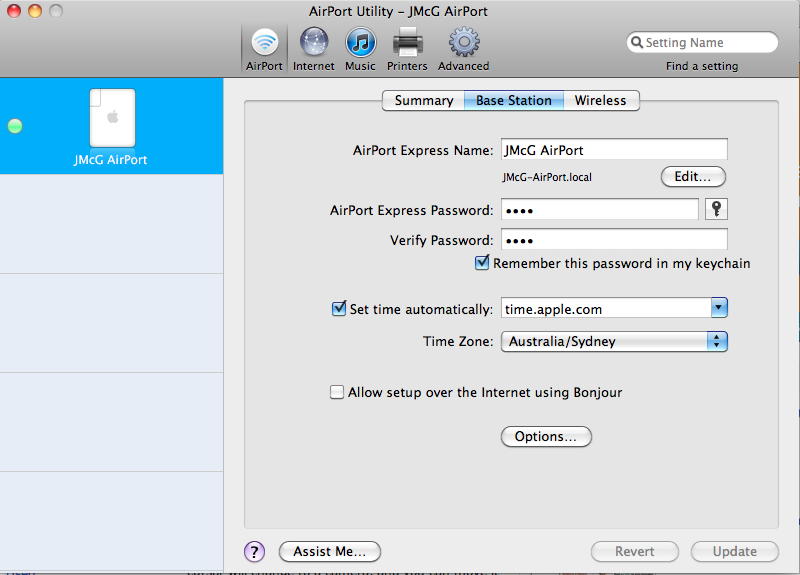

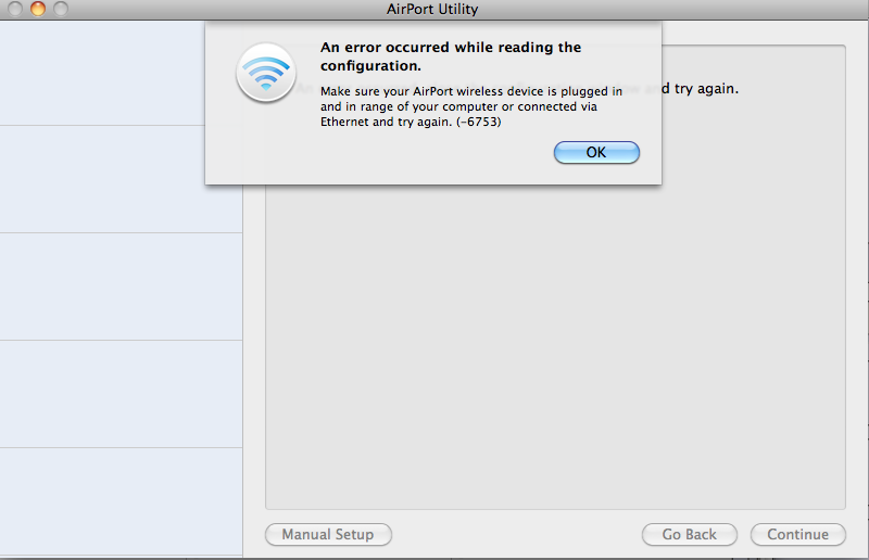

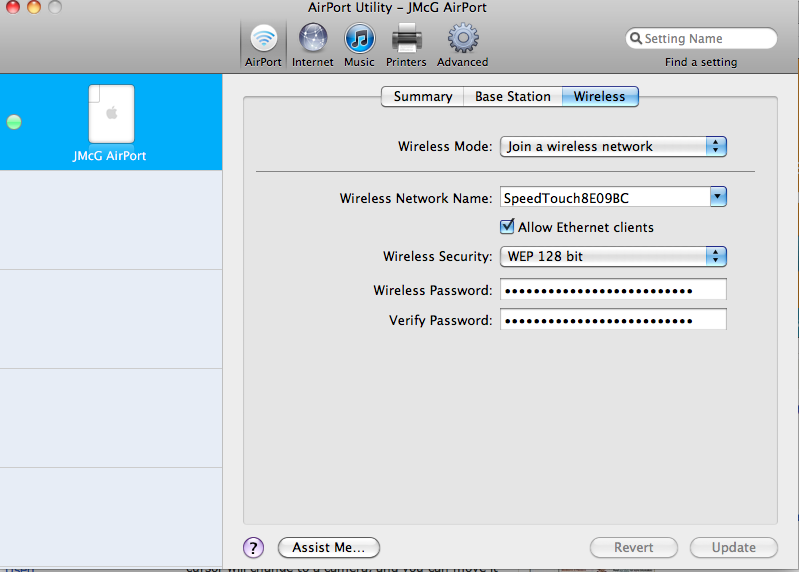

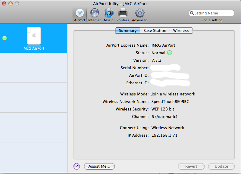

there seems to be an IP address conflict
the IP address for the AX should be 10.0.0.x
i suggest you hard reset the unit, run the ethernet cable to your Mac, then run the setup wizard again.
btw, if ever possible you should use WPA2 network rather than WEP - it's not very safe at all.
not should be, can be.
most non apple routers default to 192.168.0.x, but 192.168.1.x is perfectly valid.
apple defaults to 10.0.0.x
actually anything 10.x.x.x or 192.168.x.x is a valid address, as they are not routable over the internet.

for the security, are you sure you're WEP? and not WPA?

Logged into my WIFI modem (an ordeal in itself finding the username and pwd for that!) and changed my security to WPA2. I've had a WIFI modem for about 4 years and default must have set it up as WEP at the time.

Incidentally my IP is still 192.etc.
