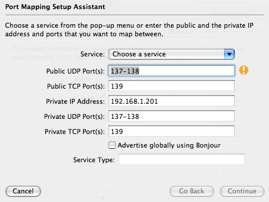

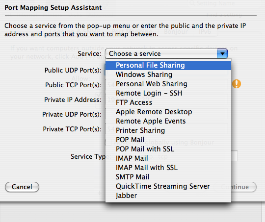

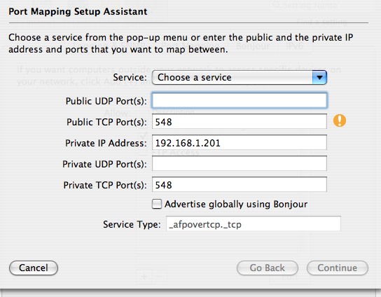

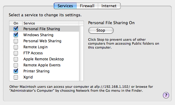

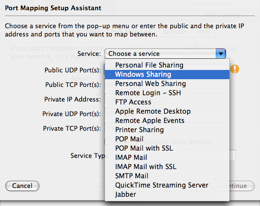

Ok... instead of creating a new thread, I thought I'd continue on this one...
I'm having probs opening the Windows Sharing and/or the Personal File Sharing port on the new Airport Extreme router...
I keep getting that yellow exclamation mark once I select the Windows Sharing option...
As you can see from the pics, the ports are already open via the sharing prefs... I still get those errors if the ports are closed in the sharing prefs...
What am I doing wrong??
And yes, I do fix the Private IP Address...
HELP!!!! TIA!!
HELP!!!! TIA!!
Sadly you're doing nothing wrong. Apple for some reason has decided to take 30 years of history and change how it works with this new basestation.
Port 548 has been Apple Filing Protocol (AFP) forever and normally to access an AppleShare server behind a firewall/NAT you would do so over port 548, however with the new Airport Extreme Basestation N if you have "Airport Disk" turned on then the Airport itself uses this port to share the disk with your network and the internet (if you have outside access turned on) so you will no longer be able to port forward the standard AFP port to computers inside your network.
To get around this you either need to turn off the AirPort shared disk feature or map a new port (549) as your sharing port for AppleShare/AFP. And then change your connection proceedures on remote machines accordingly (afp://yourdomain.com:549/) to connect to your Mac inside your Airport network.
