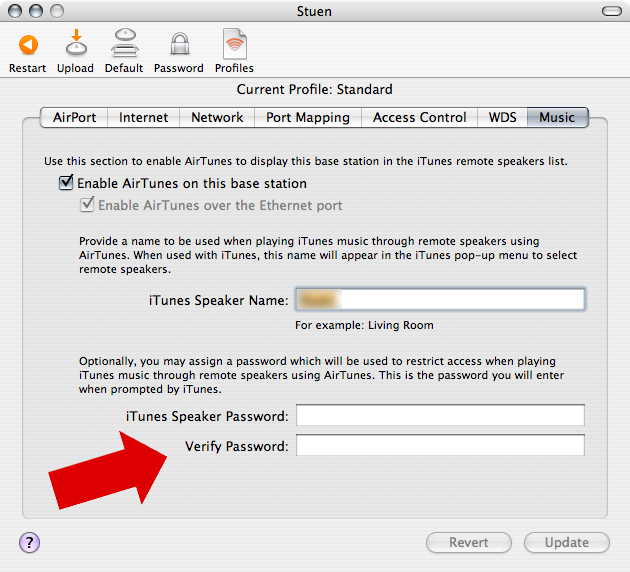

I live in a college dorm, if I were to get an airport express is there any sort of privacy protection that would keep neighbors from connecting and playing airtunes over my stereo?
Password protection:

adk said:
Ah, thanks. It is also capable of WEP right?
For networking, yes. But don't use WEP, that's totally cracked, use WPA or even WPA2 with a good, long password, that should give any wardrivers something to chew on... 😉

Yes and no. By turning off the SSID you are attempting to keep all out that you have not given the network name to (to some extent -- your network could still be found). As Mitthrawnuruodo showed, the password would keep others from playing music to your stereo. However, when you say share itunes over the network, are you talking about the actual iTunes library? I thought that I read that the current version of iTunes doesn't allow this without third party software. (Unless you're talking about sharing the actual song files in your iTunes directory). And I'm not sure how that software works as to whether it would work with a WPA encrypted network.

Ok, I have my setup configured exactly as you want.
1) Check the box "Create a closed network" - this is Apple's equivalent of not broadcasting the SSID, so you will need to manually type in the network name the first time.
2) Use WPA(2) unless you are using some other wifi device which needs WEP.
3) Put a password on your AirTunes.
4) Don't let the Airport Express distribute IPs. This will let you have a regular IP given by the school's network and allow you to share your iTunes. Without disabling the Distribute IPs box, you will not be able to share tunes and may not even be able to browse the net.
