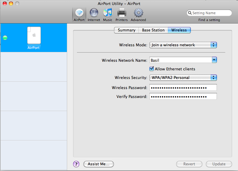

if you look at the screen capture below, you'll see the "allow ethernet clients" check box.
The older G expresses didn't have that option, only the N ones do. which is why the article that skorpien linked to has some inconsistencies... It's almost 6 years old

I'm not running wds on my dd-wrt
under airport -> wireless -> wireless mode, set it to "join a wireless network"
select your network, check the "allow ethernet clients" check box, and enter your security information.
I highly recommend, plugging an ethernet cable directly from your express to a computer for the setup. once it's configured, test it by turning off the airport on your computer. Once the express is working, you can move it, and plug into your xbox.

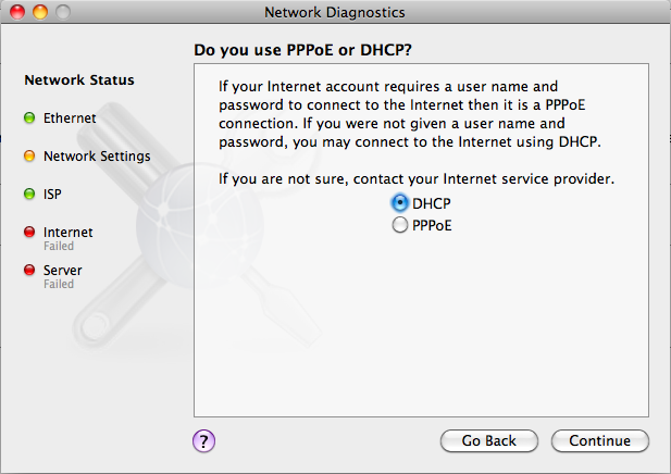

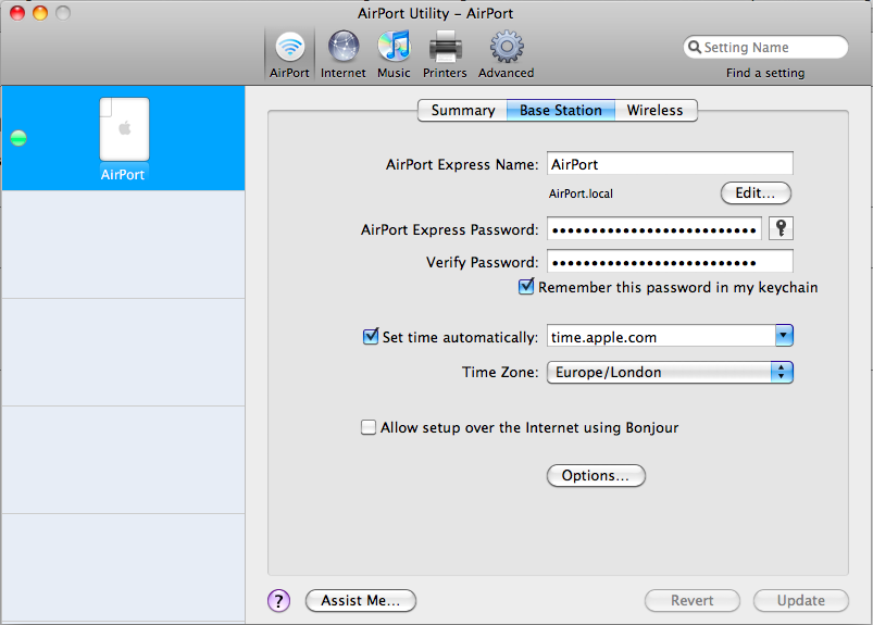

I've just checked it on my laptop (connected direct to AE via ethernet and switched off airport on laptop). It isn't working 🙁
I've attached the screenshots of the Base Station and Wireless tabs as well as the network connections (I tried changing DHCP/PPPoE and restarting AE - did nothing).
Are my AE settings the same as yours?

I've never seen the 3rd screen, but you want DHCP

from the screen shots you posted it should be working.

PS The third screenshot was from the System Preferences - Network.
