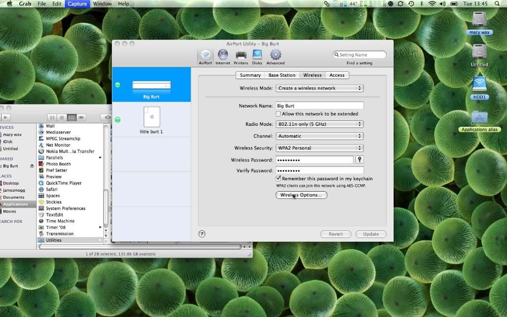

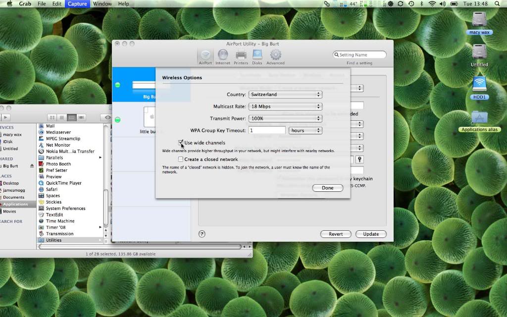

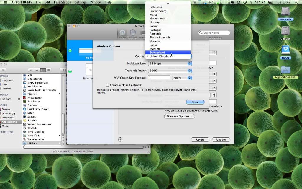

if anyone in the UK has the same problem as me i have found the very very simple solution!!
if you click on wireless tab in airport utility application then options button, and select another country from the location tab, i chose switzerland but lots of other countries also have work, then the "use wide channels" button appears, check it, and you have 40Hz like the US. well thats what i think, i certainly got a speed increase from the 5mb/s i was getting to between 8 and 9.

open airport utility
select wireless
select wireless options
select country and change to somewhere other than UK swiss is ok.
that pops the button up to use wide channel, select it click done and update you AE.
thats it job done you should see much better speeds, i certainly did, and my mobile phoe and microwave still work!!!!!!

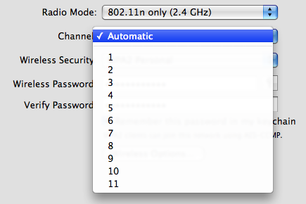

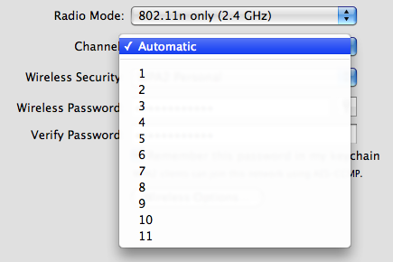

In contrast to the TS, I am looking for the European firmware for the Airport Express. I have been abroad for half a year and I bought an Airport Express in the USA. Now that I am using it here (The Netherlands) I cannot set it to The Netherlands which means it will not be able to work on the frequencies allowed here.
attachment.php
Is I am pretty sure this must be firmware defined it should probably be soleable by flashing it with the European firmware. I already tried to upload the 7.3.2 firmware using the standard way in Airport Utility, however nothing changed so I am assuming Aiport Utility downloaded the US version and not the European one.
Also, when setting up a 802.11b/g network only the US channels show (1-11) instead of the channels allowed here (1-13):
attachment.php
Does anybody have the 7.3.2 Dutch or (other?) European Airport Express firmware lying around?
Cheers :)

Hi Hellron, thanks for your reply. You are absolutely right that I am indeed able to use some channels I am allowed to use here. However, I am also unable to use certain other channels because they are not available in the airport express. To quote the Apple specs:
Channels
Channels 1-11, 36-48, and 149-165 approved for use in the United States and Canada
Channels 1-13 and 36-64 approved for use in Japan
Channels 1-13 and 36-140 approved for use in Europe
Channels 1-13, 36-64, and 149-165 approved for use in Australia, Hong Kong, and New Zealand
This means I cannot use channel 12 & 13 of the 802.11b/g spec, and I cannot use 49-140 (a huge range) of the 802.11n spec. The airport express does allow 149-165, however as I have a European MacBook Pro those channels will not be available to me.
So using the US firmware on the Airport Express actually limits it in it's use. Of course I can use the other channels available, but I would prefer an unlimited device.
So I was wondering how to solve this issue.... :)

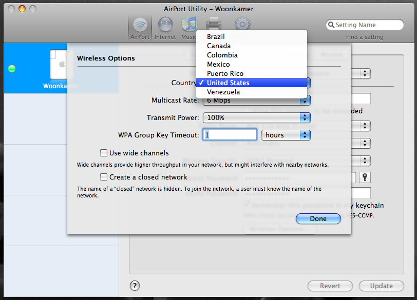

I'm in Japan, with a shiny new AEBS, limited to 130Mbps because we can't use wide channels here ... :(
Any workarounds?
Have you selected a country other than Japan from the drop down list in "Wireless Options"?

No, Japan is the only country in the drop-down list. :(

I still haven't resolved the US AE issue in Europe and it looks like I'm not alone with this. Anybody got a clue? I assume that either the AE's sold in different locations (eg. USA, Europe, Japan, Australia, etc) either have region based firmware or they all use the same firmware with some location setting stored in the device itself. Anybody got a clue how to change the AE location / region from USA to Europe?
For example, if I set the AE to use the 5Ghz band I cannot connect to it. Because the USA uses channels 36-48 and 149-165 while in Europe 36-140 are allowed. So my MBP cannot connect to the AE as both devices use different channels.... :S
No solutions here though...
This is not exactly true.
Apple Airport card uses 802.11d in the beacon advertised by the AP to set the regulatory domain for network access. I have a US MBP, and travel between Germany and Australia nearly every month. When I fire up my laptop (now in Germany), and look through the console log, I see:
Sep 1 08:19:25 salamander kernel[0]: en1: 802.11d country code set to 'DE'.
Sep 1 08:19:25 salamander kernel[0]: en1: Supported channels 1 2 3 4 5 6 7 8 9 10 11 12 13 36 40 44 48 52 56 60 64 100 104 108 112 116 120 124 128 132 136 140
The AP I'm connected to uses 2.4 GHz channel 12, which would be normally unavailable if my SS detected I was in the US regulatory domain.
Really this isn't a firmware issue - Apple just needs to set the .11d bits in the beacon, the hardware is (mostly) the same for all the Airports made worldwide.
You can also find this information under the system profiler under the Airport
Locale:
Country Code:
