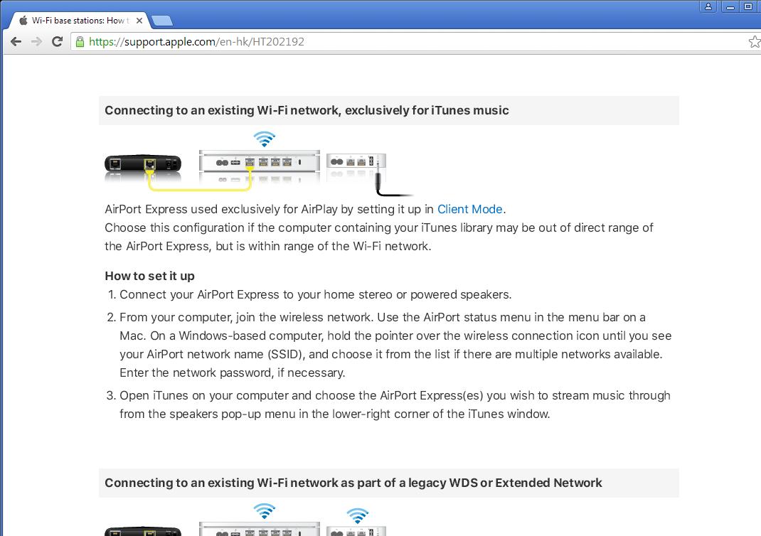

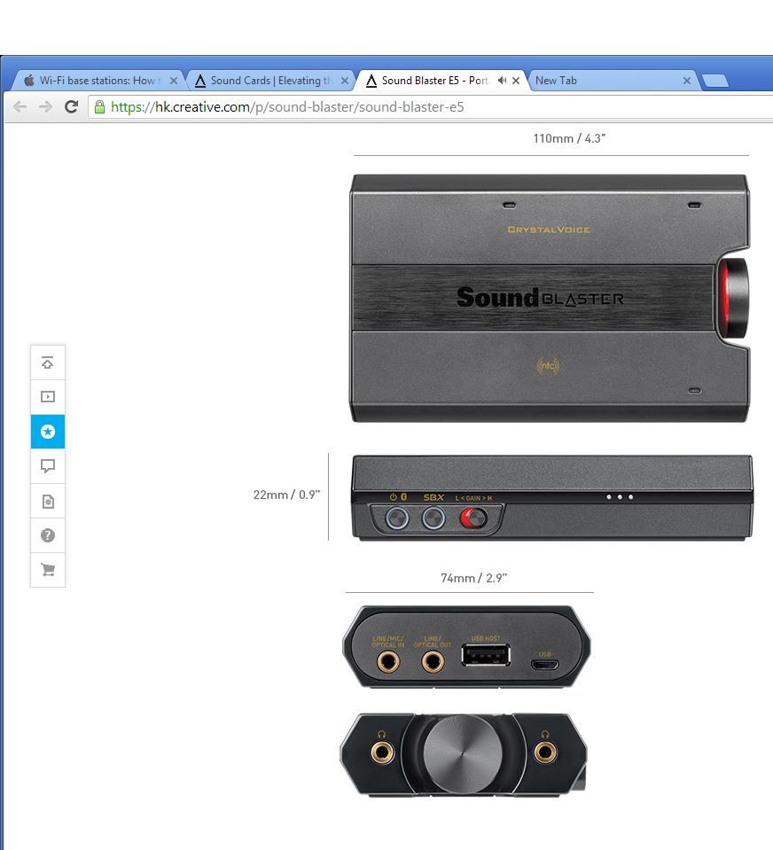

I know the AirPort express (AX) can be connected to amplifier receiver via toslink up to 16 bits 44.1khz (CD quality) and some of the USB DAC ( sound blaster E5 or G5) is up to 24 bits 192khz.
I need my iMac Pro to connect to my 5.1 amplifier receiver to play itunes music/movie/youtube on safari and gaming under bootcamp. Does it make any difference between AX or USB DAC?
I am not quite clear if the AX would stream the system's sound also? Furthermore, how does the AX stream gaming sound under bootcamp?

I'm pretty sure the AX can only output stereo (though I have never tried anything else). Also, there is a delay on the AX, which is fine for playing music, but makes it un-usable for video.

so, better pick a USB DAC, know Sound blaster E5 or G5 better? some review said E5 not true 7.1 . However, I wonder it should by pass the digital signal anyway, so there should be true 7.1 or not. I am quite confused.
