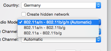

By the way what do those Airport Express setting mean (see attachment)? Which option should I choose for the best performances? Can I enable a 5GHz network only?

You can create a 5 GHz only network with the AirPort Express. To do so, simply go to the wireless tab inside of AirPort Utility and click "Wireless Options". There you can create a 5 GHz network.

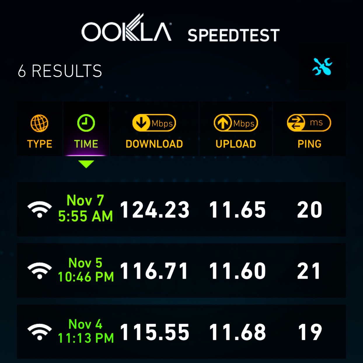

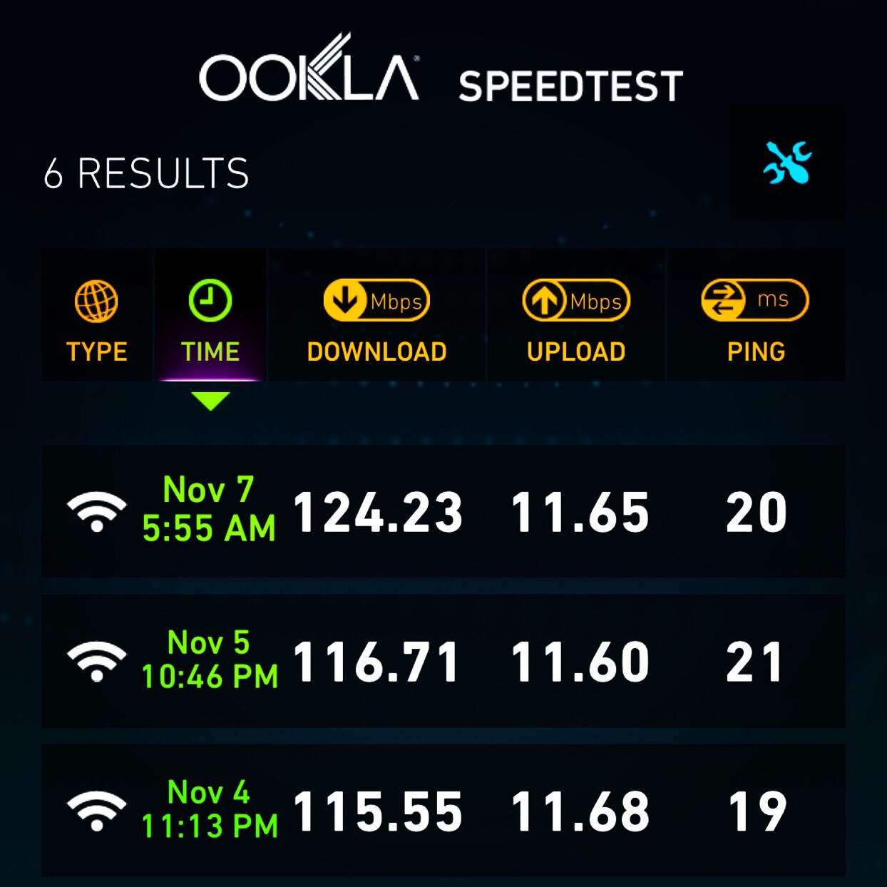

From my experience, I am not sure if 802.11n can reach 100 Mbps in reality. I have the latest AirPort Extreme and my iPhone 6 (which is 802.11ac) screams at over 100 Mbps easily. However, my year old Dell XPS desktop with an internal 802.11n network adapter can only reach up into the 50s Mbps ok the network. My girlfriend's iPhone 5S maxes out at around 80 Mbps on my network. Thought about getting a different network adapter for my desktop, but I'll wait until I get a MacBook Air with 802.11ac.
This is my iPhone 6 Plus speeds with my AirPort Extreme.
