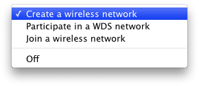

I've got mine set up with a D-Link but not as an extension, as an additional connection point. I use the D-Link for everything wired and game systems since I don't need wireless access to those and then I use the AX for wireless access but I still have access to my wired old school Replay TV to download from it. So you can use it and still have access to the thing off the other router you just need the IP address.
Thanks for that - but I'm still unsure whether I can use it to extend a non-airport network wirelessly or not... I assume yours is connected to your router via ethernet?
Actually I use it wirelessly to connect, no ethernet cable. But it might be worth a shot to see if you can set it up that way because it does give you the option to join a wireless network.
pretty sure you can extend non-apple wireless network. Just google some reviews online. sometimes they try it out.
Cool - it sounds likely that it will do what I want then, I guess I'll just give it a try!
