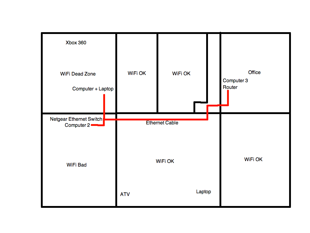

You can use the Airport Express as an extender, but not wirelessly - that only works with an Apple Airport Extreme base station. You'll need to run a long ethernet cable from your BT Home Hub and attach the Airport Express on the end - I've done this with other routers and it works fine.

You can do that with Airport Extreme + Airport Express either wirelessly or wired. Without an Airport Extreme (i.e. with any other router) it just extends your existing network and only wired - IMHO, YMMV
The best bet is to have an Extreme rather than an Express as the newer ones have a greater range (connected by Ethernet to the BT system) and if it is still a problem you can then extend with an Express.

You probably know how it actually works, but IMHO your posts make it sound like you can extend any existing wireless network using the Express as long as you connect it by wire.
If you have an existing wireless network (non Apple-based), you can't extend it using AirPort Express/Extreme to get better coverage. If you add one of those to get better coverage, it will have to be as a new, separate network.
The OP should do just fine by reading my first post in this thread, and following the link.
Thanks for your help, i have a Netgear Ethernet Switch which runs to the router could i run it from the Switch instead of running another cable through the house?
Regards
Matt
Here's a layout of the house.
