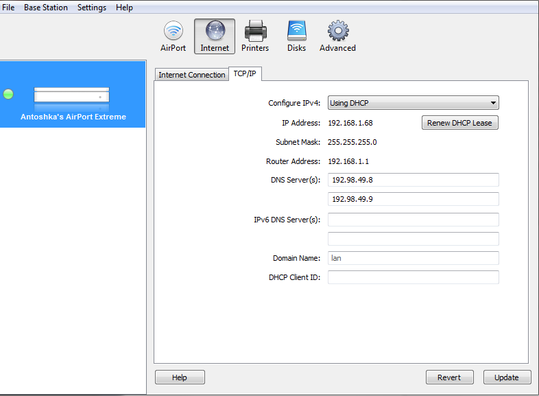

Thanks for your quick reply!

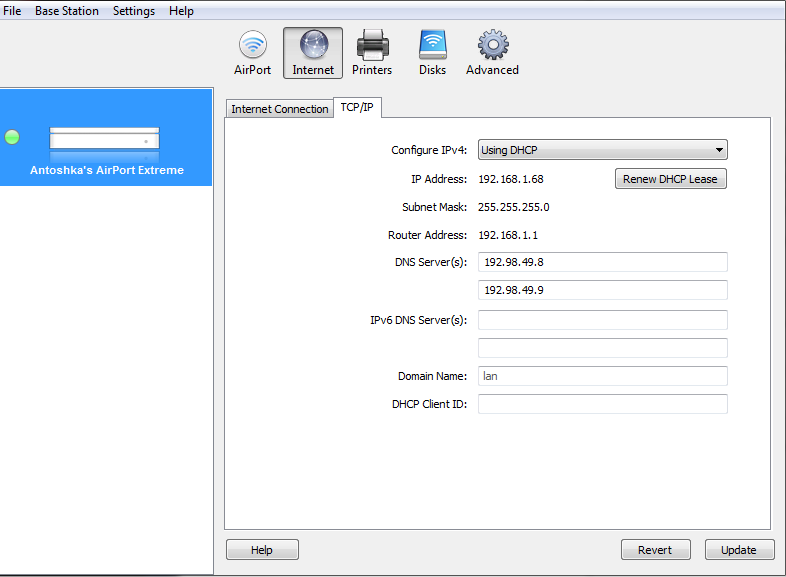

Attached is the screenshot of my AE Utility (I am using it on Windows atm).
With "Using DHCP" mode enabled I can't seem to be able to change the IP address to static, only can do that when I switch to "Manually" mode. On the other hand, I don't think this will help, since my AE always gets the same IP anyways (configured on the ISP's modem side). And I already have valid DNS information of my provider typed in. Doesn't work.
My ISP is Elion, I live in Estonia, EU, but I doubt this info will help 🙁

You can change to a Static IP address by clicking on "Using DHCP".
But this is not important, especially if the AE gets a fixed IP address from the router.
Back to the DNS : you currently are using : 192.98.49.8, and 192.98.49.9
Please note that I can't neither ping nor traceroute these servers, which suggests that they are down or do not exist.
I suggest :
1. try using 192.168.1.1 only instead.
2. check on Internet that 192.98.49.8, and 192.98.49.9 are the DNS your ISP is currently using. (I don't think so).
If you found news ones, enter the new ones.
I have tested : 213.168.18.146 and 195.50.193.163, they do work for me.
http://www.tcpiputils.com/browse/ip-address/213.180.31.128
3. If 1. and 2. do not work, use OpenDNS : 208.67.222.222 and 208.67.220.220

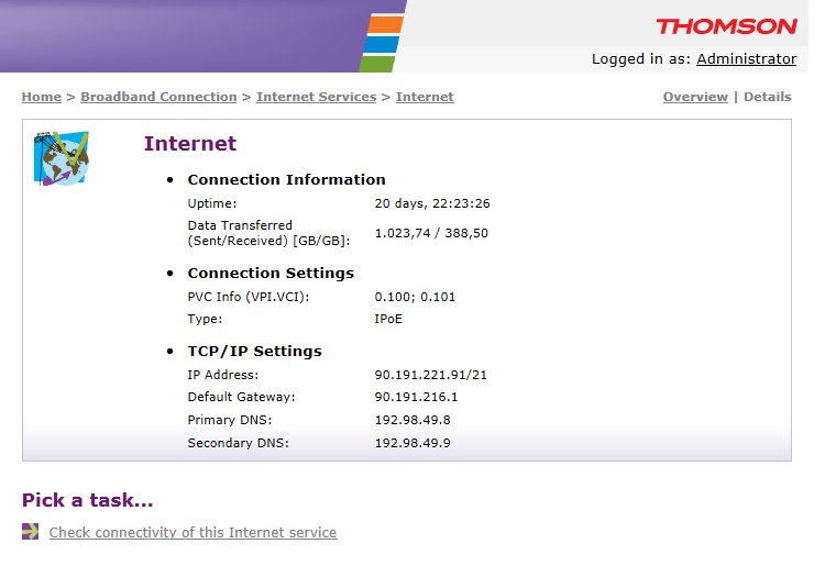

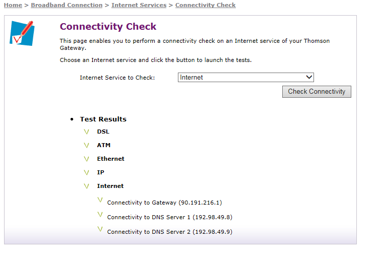

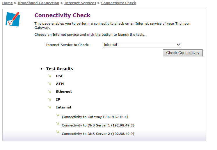

OK, now to the weird part... The DNS that is indicated in my AE is the DNS that my ISP router/modem uses. Attached are screenshots of the ISP modem config screens. First one shows those exact DNS addresses, and the second one shows connectivity test for those DNS (passed).
I cannot change the DNS settings on the ISP modem (it obtains them automatically somehow and there is not Config button or anything for DNS).
Maybe that once again points to the fact that my ISP has some weird issues with DNS addresses? I've been using these very DNS addresses for about a year. Internet is perfect on all wired machines and ONLY wireless devices seem to loose Internet connectivity...
I am confused, to be honest.
If I point my AE's DNS to the ISP modem, the result will be the same, since ISP modem uses these same ones.
But if I type in the OpenDNS in AE will it work? I think it will still use the DNS of the ISP modem, no?

1. If I point my AE's DNS to the ISP modem, the result will be the same, since ISP modem uses these same ones.
2. But if I type in the OpenDNS in AE will it work? I think it will still use the DNS of the ISP modem, no?
3. And as to the suggestion to put the ISP modem/router in bridge mode - I am not sure I can even do that. There are no options to change on the modem side that would suggest that.
Weird, indeed.
1. you are correct
2. If you type in the OpenDNS, it should use the OpenDNS.
3. you don't even need to put the ISP's modem-router in bridge mode to use the AE as main router.
But this would not solve a DNS problem...
Again, try using : 213.168.18.146 and 195.50.193.163, they do work for me.

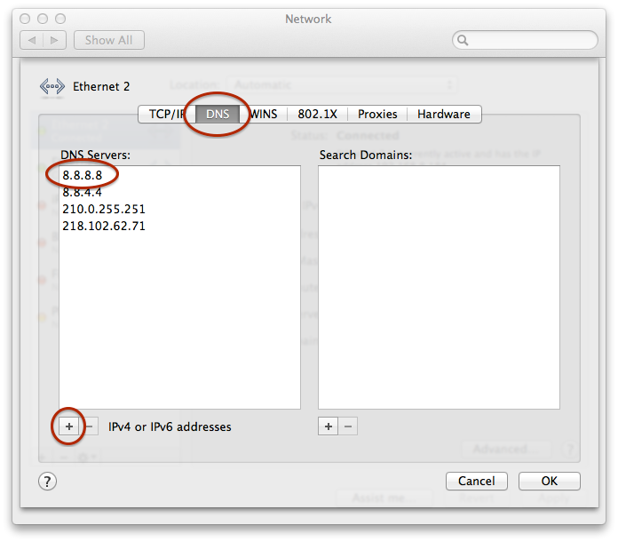

IMHO OP's setup is more complex than it needs to be. As for the DNS try Google's 8.8.8.8 & 8.8.4.4
You can also override/set DNS on the client computers.

Oh, and I've just tried pinging the 192.98.49.8 DNS and it works for me (sends bytes back)...

I see in your screenshots that you up/downloaded 1TB/300GB in 20 days did you get throttled?
Nah, it is just my usage pattern these days: I mostly use browsing, email, some youtube streaming and MMOs, while heavily seeding many torrent files. It is normal at the moment 🙂

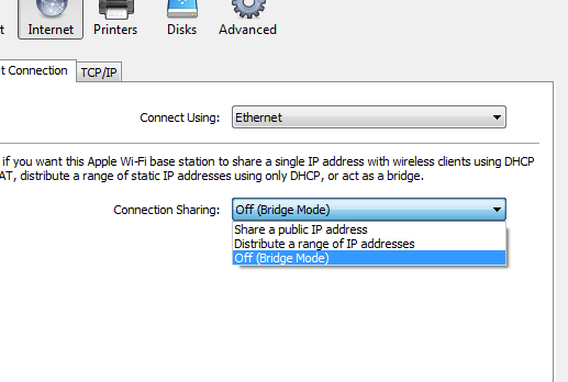

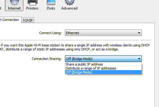

As to the other option (AE as the main router): my AE utility has three options (as seen on the attached screenshot). Do I use the "Share a public IP address" then? Do I have to change something on my ISP router, too?
Yes you are correct, this is the right option in your Airport Utility, or in Mac Airport Utility 5.6 as well.
"DHCP + NAT" is in the new Mac Airport Utility.
Sorry for that.

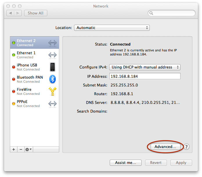

If it's DNS problem, all you need to do is manually enter the DNS address. You can do this in any OSX computers or iDevices.
