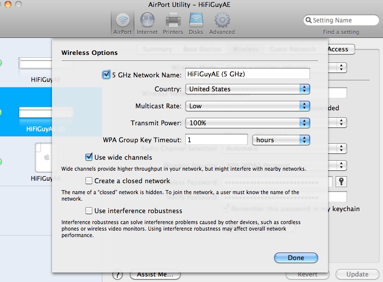

I’ve just been playing around with this option myself.
It seems that you can in fact broadcast both 5 and 2.4 from the same unit (on a time capsule at least). In manual setup > wireless > options just check the 5GHz box and give it a different name.
I connect via my MBP to the GHz one, and other devices to the original network.
This is the screen where you want to be to setup 5ghz. It's under --- >Airport/Wireless/wireless Options.

Ok I have the newest MBP and Airport extreme! I specificaly says that im using 2.4 right now, not 5GHZ--so How do I get my MBP to run the 5GHZ Band? I have looked all over my airport utility and I cant find anything
Open AirPort Utility, choose Manual Setup, click the Wireless tab, then Wireless Network Options. Here you give the 5 GHz network its own name. This will create two separate networks, one for each band. You can now connect to this network instead, that way you force your computer to always use the 5 GHz band.
But beware though, because the 5 GHz band doesn't have the same reach and doesn't travel as well through walls and other obstacles. So unless you more or less have an unobstructed line of sight between the router and the computer or if they're not in the same room, it might be better to leave it on automatic...
