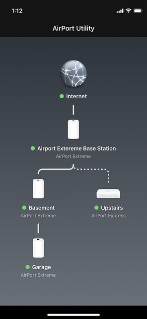

Here is my home network.
My Modem is connected to the Base station (WAN Port) via CAT6 Ethernet
Base Station (LAN Port) to the Basement AirPort Extreme (WAN Port) via CAT6.
Basement AirPort Extreme (LAN port) to the Garage AC (WAN Port) via CAT5.
Also, an Airport Express (N) upstairs connected to an older printer, not extending the network just for AirPrint as a wireless client.
In the house and downstairs I'm getting the expected 200 Mb/s over Wifi, but outside in our detached garage when connecting my iPhone 12 mini or M1 MBA to the Garage AirPort Extreme I can only get ~100 Mb/s.
When I view the 'Garage' unit on my Airport Utility I can see it's limited to 100 Mb/s
Everything is connected via Ethernet, yet the speed is 50% in the garage on 2.4Ghz and 5Ghz
Is CAT5 really limited to 100Mb/s? If so, I'll pull CAT6 and we can resolve this.
I think you need to pull at least 5E, but just go ahead and do cat 6 and see if it resolves the issue.

I would check the cables, and all of them.
If there is a damaged pair inside the cable, the link speed could drop to 100Mbps.
Also, many ethernet cables that come with devices that do not need a Gigabit connector such as printers, VoIP, etc., might only have two wire pairs inside, and this will drop the link speed to 100Mbps.
Also, swap the AirPort extremes and see if you have the same problem, just a different location, maybe it is a HW issue.
I have seen ethernet start to fail on some of the early AirPort Extreme units, the 6th gens are starting to age so maybe it is happening to yours.
The only swing factor could be wire length. How long can cat5e cables sustain signals for?
IIRC about 330ft before signal starts to degrade, and that is a single straight run without anything in-between like a router to give it more power.
If there is a problem with the cable, or any of the connectors, the link speed could drop to 100Mbps.
Extremely useful response, thanks for taking the time. What I have are straight connection from time capsule to both airport extreme's. Both are from the same cat5e cable (far less than 330ft - thanks for that info) on dedicated ducts. Interestingly, the first attempt to connect the cable to the ethernet plug did not work, and after trying again, I had connectivity; however, your comment about a pair being potentially damaged or poorly connected makes perfect sense. At least I have something to try and fix.
CAT5e is perfectly fine for 1000Mbps, and it can actually even do 10,000Mbps as well on short runs.
I guess it is possible, but the chances of the OP using anything prior to CAT5e are probably pretty low, as CAT5 hasn't really been used for a long time, and the cable would have to be over 20 years old.
I would bet that a cable is damaged or that it is one of CAT5e cables that are missing two wire pairs that I mentioned in my last post.
I am assuming you meant CAT5e, as CAT5 hasn't been around in a few decades.
As I mentioned in the last post, CAT5e is rated at 1000Mbps @ about 330 feet, but it can actually go much higher, even 10,000Mbps link speed (maybe higher than that) at short runs.
If you CAT5e cable is good, then getting CAT6 probably will not improve anything, so I wouldn't invest the money. But, if you have a damaged cable, and you were going out to purchase something new anyways, a CAT6e or CAT7 cable would probably be worth the extra cost for future proofing.
A damaged cable or maybe a damaged port on the AirPort might be the issue. I would try a different cable and see if that makes a difference.
Kinks in the cable can also cause link speed to drop, so try not to let the cable kink, as the damage is usually permanent to the cable.
Its an older house and the previous owners used the CAT5 cable to run an older intercom in the garage to the house. 99% sure its CAT5 but will try shortening the cable a bit and putting new ends on to see if that helps.
That makes sense.
New RJ45 connectors might just do the trick as they could oxidize or corrode over time. Also check for kinks and tight bends. Check out any patch cables being used as well. Even if they are new, patch cables could be the two-pair type which will automatically drop the link speed to 100Mbps.
How long is the run?
While it is only rated at 100Mbps, CAT5 will still link 1000Mbps in short runs. IIRC, CAT5 and CAT5e is almost identical in spec, but CAT5e has either better shielding or tighter winding to reduce interference, and allowing it to link 1000Mbps to at least 330 feet.
