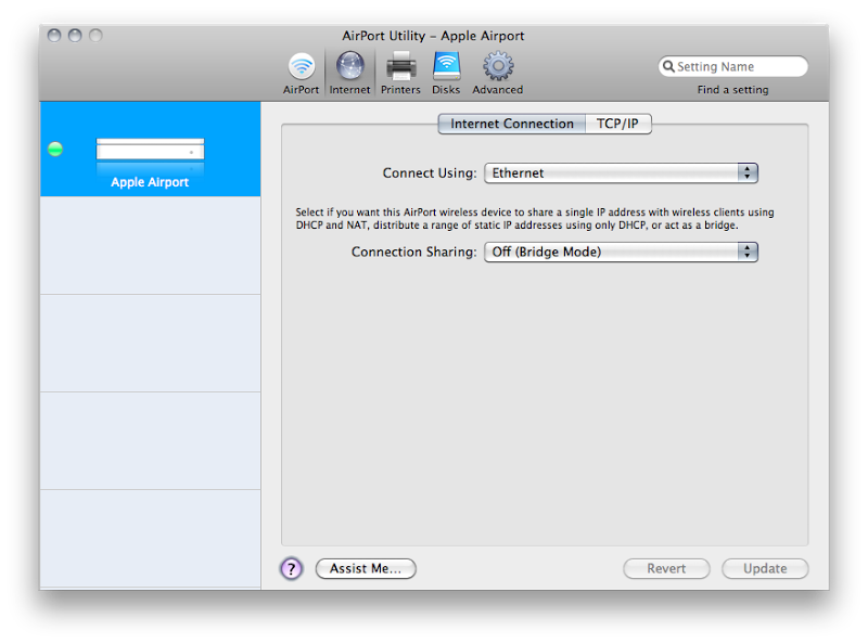

I turned off my connection sharing (bridge mode).
I was wondering, since the Airport is no longer a node on the internet, why does the configuration still allow me to enter TCP/IP information, and does it make a difference what I put in there?
Bridge mode doesn't turn off the connection, it turns off connection sharing, which basically stops the airport acting as a NAT router and DHCP Server (useful if you already have a NAT router / DHCP server that connects to the internet such as an ADSL router).
It still connects to the local network and still needs an IP address: its easiest to leave the IP configuration to getting an IP address via DHCP.
I use bridge mode because my ISP now provides two dynamic IP addresses, and I have two computers. I'd rather not fuss around with NAT. That doesn't leave any automatic IP addresses for the Airport itself, so what TCP/IP settings should I use then?
I don't think there is a configuration for the Airport that would work like you want it to in that situation as the Airport requires an IP address itself (so you'd need at least 3 IP addresses). Why don't you want to use NAT?
It does work because I've been using it this way for a while. It even seems to work with an illegal address like 127.0.0.1, which is why I'm wondering what the TCP/IP settings are good for. Doesn't bridge mode essentially turn the Airport into a hub? Hubs don't have IP addresses.

The TCP/IP settings in bridge mode are used for management purposes only, eg to connect to the base station via IP to configure and monitor it, for it to get network time etc. It doesn't do anything for the actual flow of data between your computers and the Internet. If you want to use bridge mode and you don't have a spare address for the BS you can just configure any address manually and leave it that way.
