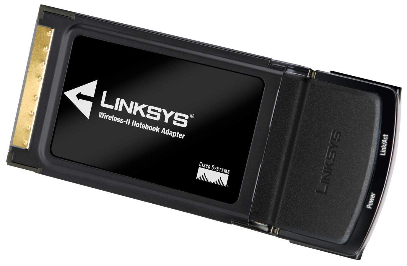

I was going to suggest a Linksys WPC600N PC card. It's seen as a native Airport card (I'm using one on my 17" PowerBook), but apparently the 12" PowerBook does NOT have a PC slot!
That leaves you with the only alternatives: either disabling the Airport Extreme card (doesn't sound like you want to do that) or finding a USB WiFi adapter. Most of those that function with PowerBooks use a Ralink chip and a separate app to connect to networks. Finding one is relatively easy, the hard part is finding the correct Ralink installer/drivers and app.
Unless anyone happens to know if there's some sort of PC link to USB adapter or anything (don't believe one exists).
For the record though: Linksys WPC600N. Dual band, 802.11n.

Still, I don't believe the iBook has a PC slot. I can't remember right now. If it does not, then a USB WiFi adapter is your only other option.
