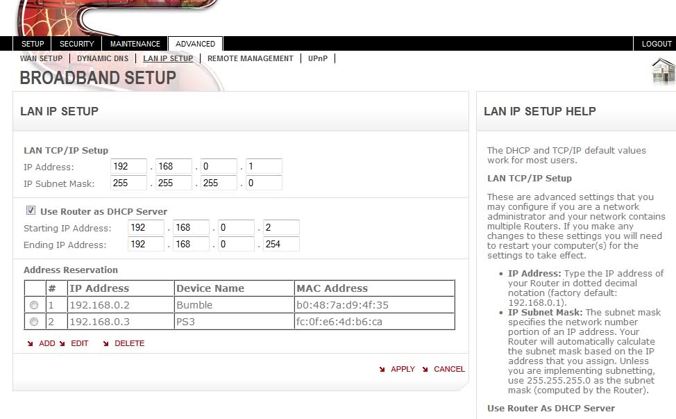

I have just bought an Airport Extreme (latest model) base station (on 7.7.3). Massive improvement over my old TP-Link! Anyways.... I'm in UK and have a Sky ADSL router which is not the most configurable router in the world and am setting up a 10.10 Server as well so I want the Airport Extreme to handle DHCP and turn off the WiFi on my broadband router.
So, my question is, I'm looking for the correct method of configuring this so my Apple router is the DHCP & Nat server, and router just handled the ADSL into the house.
As you can see, with my Sky router I can turn off DHCP, but not sure if its really that simple? If I turn it off, how does the Sky router assign an IP to the Airport Extreme?

It doesn't. The Extreme already has its own self assigned IP address. Typically 10.0.1.1.
Not familiar with the Sky router, but I would also check it's WAN setup.
Basically, what you want to achieve is to switch your Sky router completely off performing router/NAT/DHCP duties and just keep it's ADSL Modem functionality.
Most likely, you will have to call your ISP (Internet service provider) and ask them to switch the equipment to bridge mode. That being said, as I understand it, if you subscribe to other services through Sky then they may be affected. A quick call to them will give you an answer. If they cannot switch the Sky equipment into bridge mode, then your best option would to be to add the Extreme into the DMZ (demilitarized zone) with a static IP on the Sky router.
