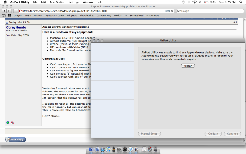

  • Can't see Airport Extreme in Airport Utility

Yesterday I moved into a new apartment and decided to treat myself to a Airport Extreme and new cable modem. I installed the Airport Utility and followed the instructions for setting up a network. Everything seemed to setup correctly and the Airport Extreme had a green solid light on the front. From my Macbook I can see both the networks (main and guest), but cannot connect to either wirelessly. The error message is a connection timeout. I'm certain that the passwords are correct.
I decided to reset all the settings and try again. I was able to reset the Airport Extreme settings using the Airport Utility. Now I still can't connect to the main network, but can connect to the guest network (wirelessly). When I open the Airport Utility it tells me that there are no apple devices seen. This is obviously false as I connected to it currently and this thread will be made while connected to the guest network.
Help? Please.
EDIT: I wanted to add a picture that showed my Airport Utility. You can see this thread in the background.
If I understand you correctly, you're connected to the guest network while trying to access the Extreme's settings in AirPort Utility, correct? You won't be able to do this as guest network clients cannot connect or see anything on your network, including your AEBS. I can confirm this as I have the newest model AEBS and can't see it in my AirPort Utility when connected to the guest network. You'll have to connect to your AEBS with Ethernet to be able to access it. You can also try holding the reset button on the back of the AEBS for roughly a minute (may be less, not exactly sure). This will bring your AEBS back to factory defaults and let you set up from scratch. I can't comment on why you'd have issues connecting to the main wireless network however. The only suggestion I can make is to be absolutely sure you installed AirPort Utility from the CD that came with the AEBS.

I didn't think about the fact that I wouldn't be able to access it if I was logged into the guest account. I'm about to log out and disable the security for a minute to see if I can log into the main account.
