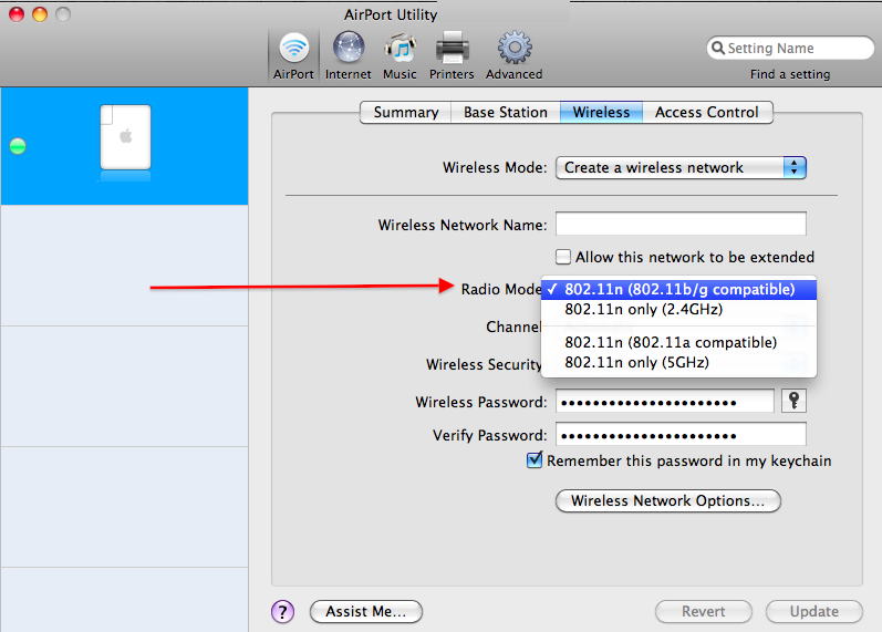

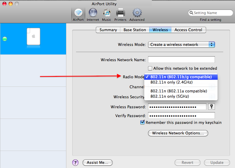

Launch AirPort Utility
Select your AE
Click Manual Setup
Click the Wireless tab.
What do you have selected in Radio Mode?

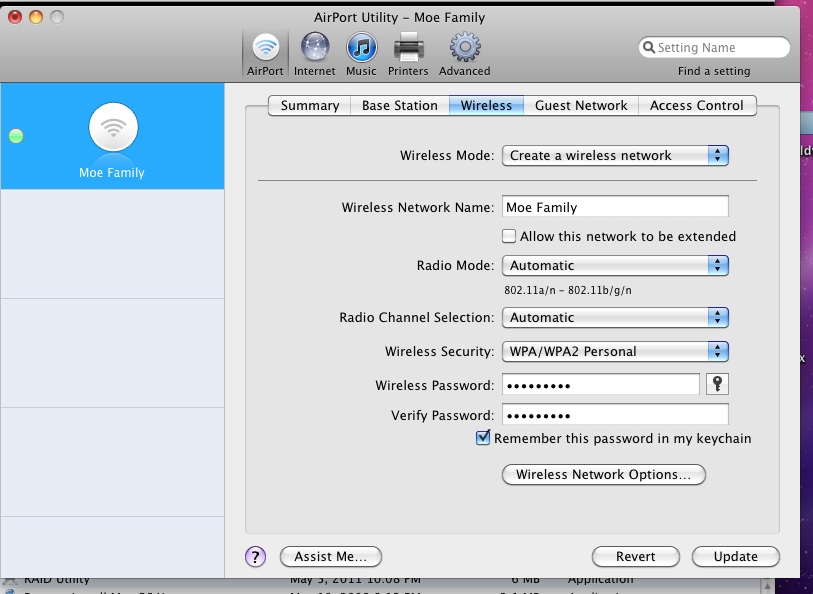

Automatic. And my printer doesn't work anymore either. 😕
Automatic isn't one of the choices. You're reading the Channel, not the Radio Mode.
Strange. Maybe it's because my Airport Utility isn't on the latest version? Because honesty, that's what it says. It says Radio Mode: Automatic, then below it, 802.11a/n - 802.11b/g and 802.11a - 802.11b/g. Which one should be selected?
Gotcha. While you were doing that, I was looking at specs for your other devices. So far, it looks like your current setting should work for all of them. Does your wireless network not appear at all on those devices?
