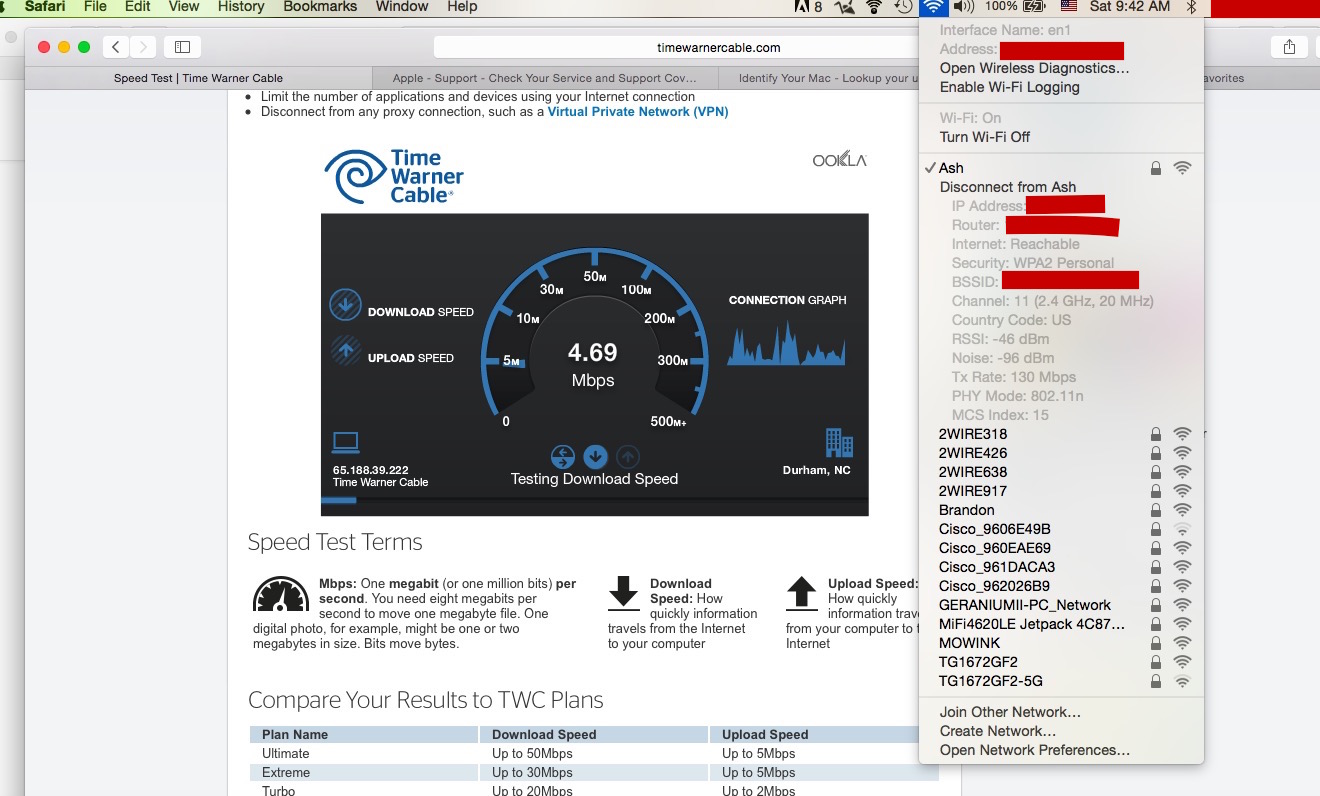

Thanks for the reply - didn't know about the option click. Running at 130Mbps despite poor internet speeds. Strange thing too. Her computer sat in that room all night, I walked in there, woke it up, ran the speed test. First test 18Mbps internet speed w/ 130 Mbps wifi. Waited a minute and ran again. ~4.5 Mbps at the same wifi speed. Not sure what this really means, hopefully you can make some sense out of it.
P.S. Thanks for the launcher - glad my expresses are not useless.
I would be using speedtest.net rather than the TWC version. I am not sure if there is a difference between the two but using the standard speedtest.net would rule out chances that it is a cruddy connection to a TWC Speedtest server. You have good signal and a good SNR (Signal to Noise Ratio). I would try separating the 5 GHz and 2.4 GHz bands and putting the MBP on the 5 GHz band and report back!

Done - rMBP found and connected to 5GHz network no problem. 07 MBP can't see 5GHz network even if I go to join other and type in the name/WPA2 password. *However* now that I've split the bands, the 07 MBP running on the dedicated 2.4GHz network is having ZERO connectivity/speed issues. I ran 5-6 speed tests on both speediest.net and the TWC site. Churning out at 20-21Mbps each time with a 40ms ping. We may have found the problem, however....I'm not sure what it means.
