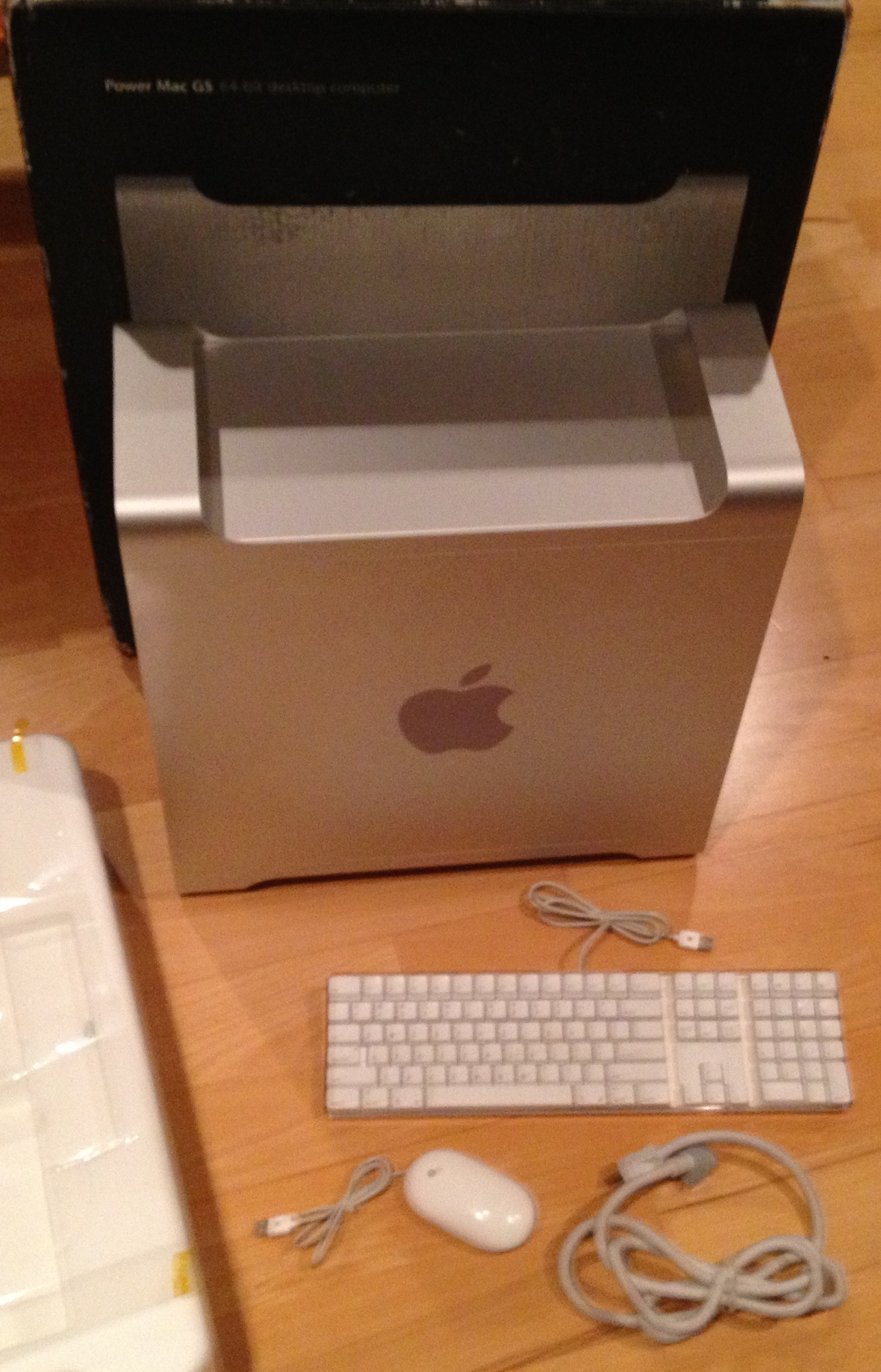

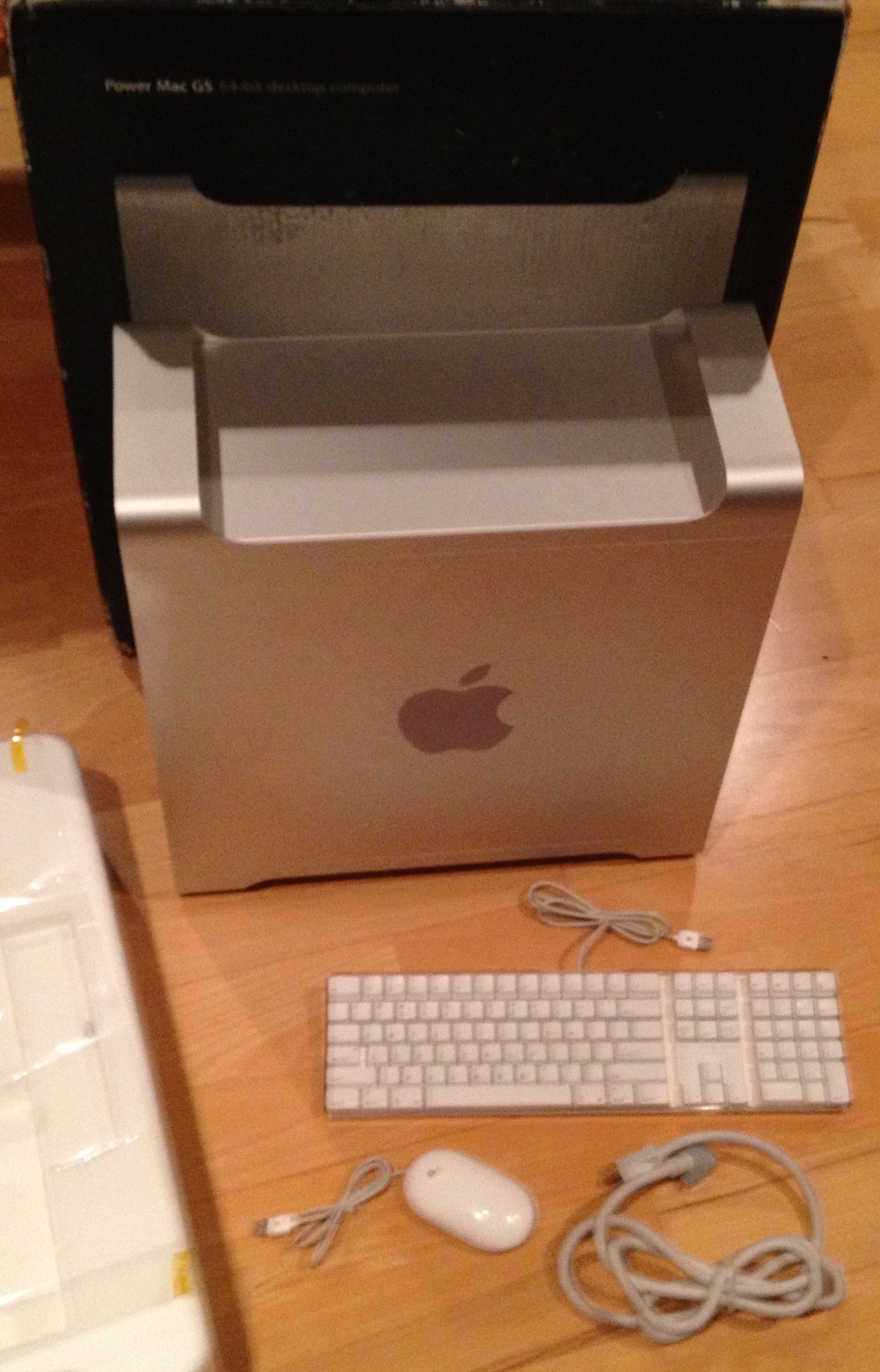

Overall, I don't think I did half bad for $80. It came with 5.5gb of ram(2x2gb, 2x512, 2x256) and I already upgraded it to 10gb(2x2gb, 6x1gb). It also didn't have a hard drive, but I had a SATA drive with a good Leopard install that I just popped in.

Interesting! The slot actually looks a lot like the one in my older G5, so I'm not surprised at this.
Although I've not done anything too "heavy" this computer feels a lot more responsive than my single 1.8. The single 1.8 isn't going anywhere(I have too much in it) but this one definitely feels like a worthwhile companion.
