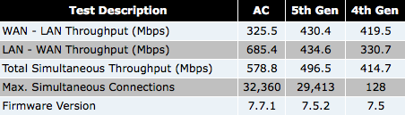

Just had Xfinity come out and install their gigibit service. Tech told me I can't get Gigabit speeds with my new Apple AirPort Extreme router. Installed a netgear one instead. Any truth to this? Would like to keep using my Apple AirPort Extreme

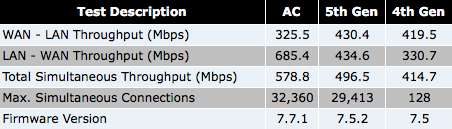

The tech was correct. In test results here the Extreme was not able to reach Gigabit speeds WAN to LAN or LAN to WAN. So you will not see Gigabit Internet speeds with this router.

interesting. Reading http://www.smallnetbuilder.com/wire...8000-nighthawk-x6-first-look?showall=&start=3 definitely shows almost double the speed with the netgear
I think that double you are looking at is the simultaneous figure. WAN to LAN is more what you are after, and yes all those models are much better than the Extreme and close to Gigabit speeds.

Do you have a source for this? The article I linked shows the AE has horrible speeds (peak WAN to LAN 325Mbps). I have never seen any data on reliability beyond anecdotal stories on the forums.
