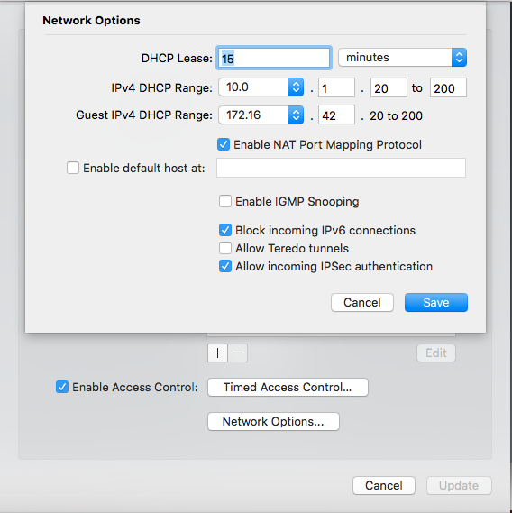

[doublepost=1460778263][/doublepost]Just noticed in Airport Utility, you can specify the guest DHCP range. Go to Network-->Network Options-->Guest IPv4 DHCP Range, and you can choose from 10.0 or 172.16 or 192.168
(I see mine is the 192.168 range and I could have sworn it was the 172.16 range! My regular network is the 10.0).
So it looks like you can choose the same subnet as your "regular" network.

Good information, but when I go into Network and then Network Options, I don't see anything about "Guest" for the DHCP range.It just says: "IPv4 DHCP Range:" And, the only range shown is for my internal DHCP addresses.
Do I have an out of date router or something?
What version of AirPort Utility are you using? With the guest network enabled, the settings for the IP addresses for the guest network should appear. Keep in mind that the guest network should have a separate IP range than the main network and be limited to internet access while the main network supports file sharing.
Yes, you're right. Once I enable the guest network, then I see the guest IPs.
However, connecting via Wi-Fi to the guest network still does not work. The only thing I can think of to try at this time would be to reset the router to factory defaults and see if that would help. From other searches I've done with others with this same problem, that factory reset seems to have helped some of them.
The Airport Extreme firmware version I have is: 7.7.3.
