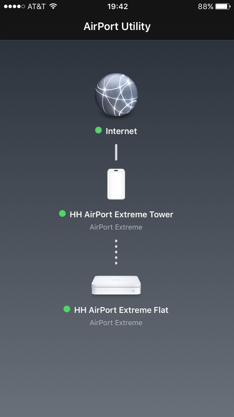

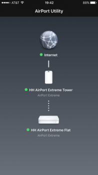

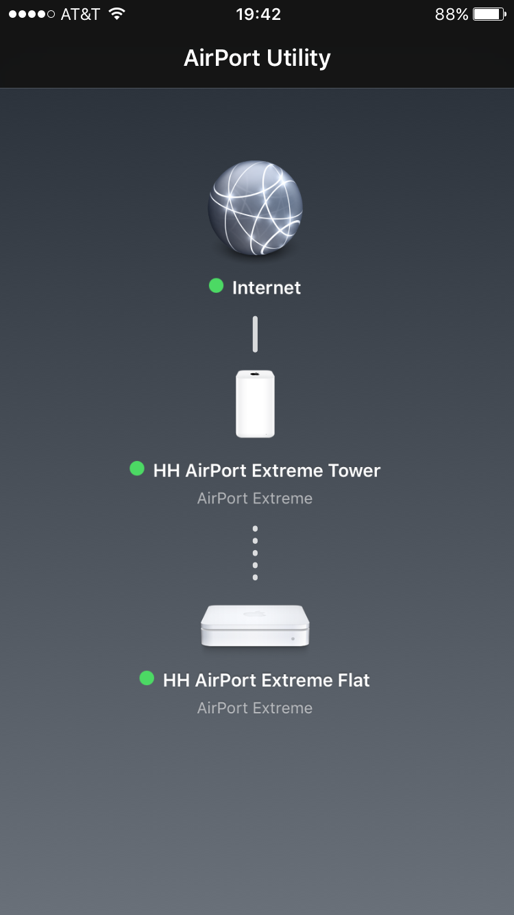

Ok, Got another extreme. So I have a 6th gen tower, a 5th gen flat extreme. How do I go about setting this up? If you could explain as simple as possible. thanks!
Use your att as router, setup the AE as access points only. You can do it via the airport utility from your Mac.
You can connect the Mac directly to one AE at a time to configure.
If possible, run Ethernet from the 6th generation to the 5th. If not possible, configure the 5th gen. to extend the 6th gen.'s network in the "Network" tab in AirPort Utility.
Got it. Thanks!
